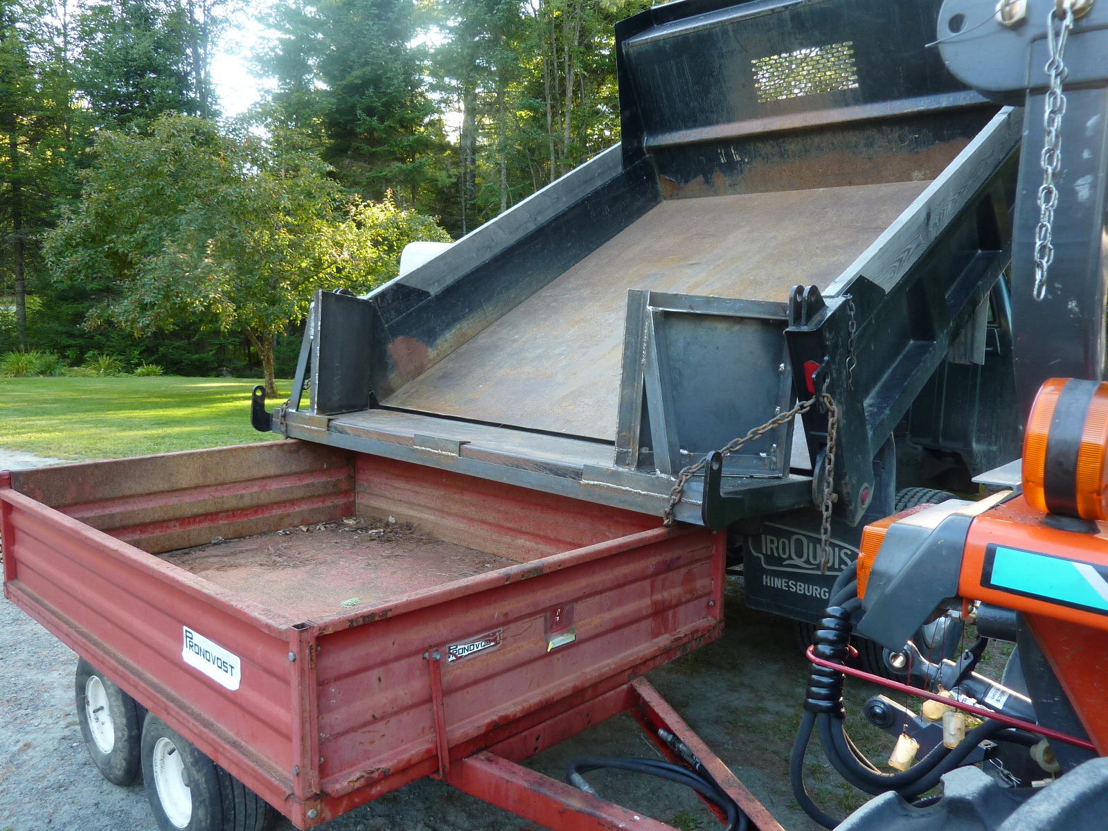

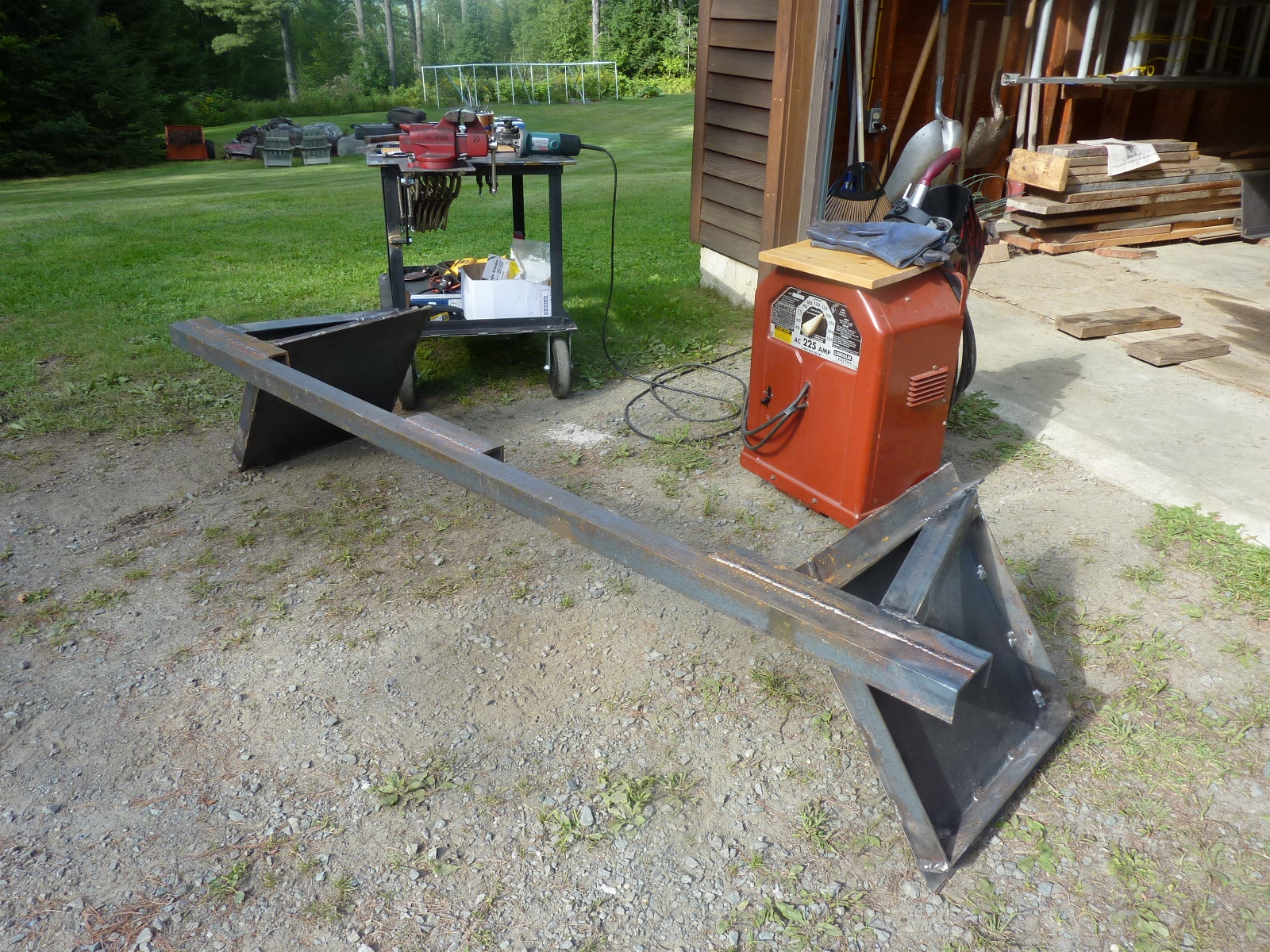

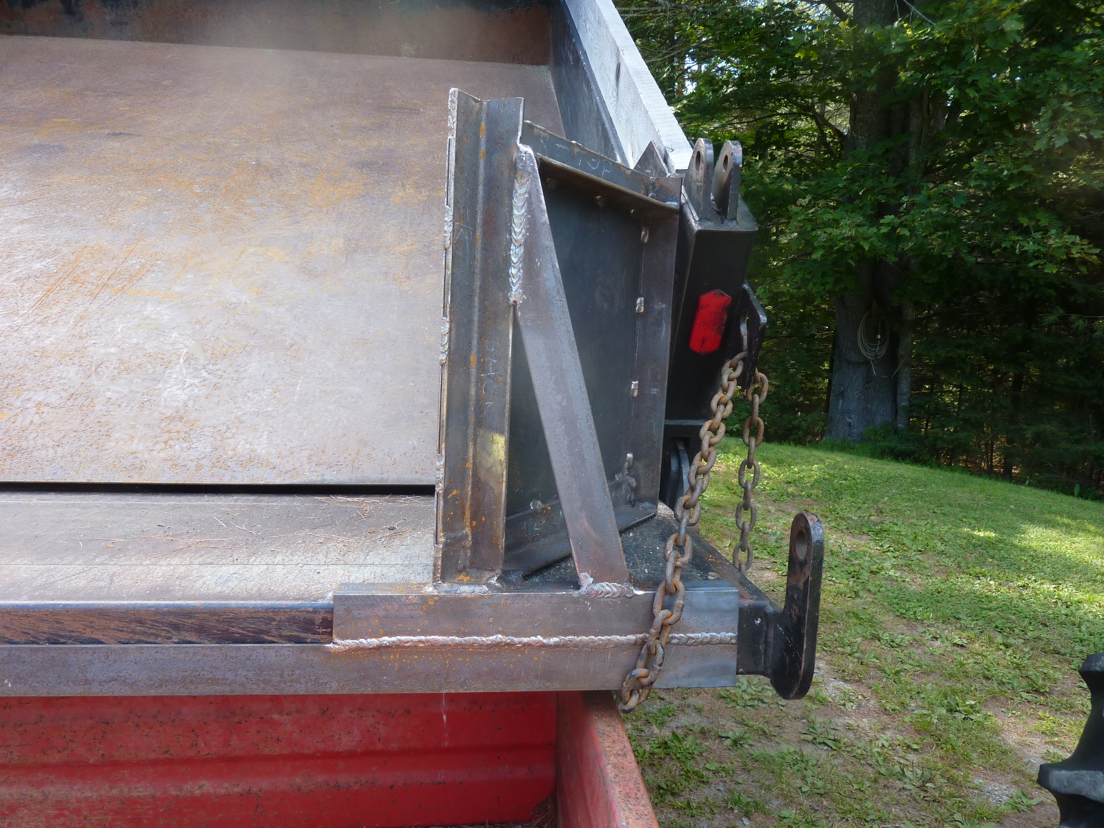

I do a lot of work on woods roads. The only way I had to haul rock or gravel into the woods was bucket by bucket. A while back I bought a small used dump trailer to make the job easier on my front end and faster. But I needed a good way to transfer material from my one ton into the trailer. I only have one tractor and it is best to load the trailer when it is hitched to the tractor so I thought it would be nice to be able to dump right from the truck into the trailer. As an experiment I built this thing - it hangs on the top of the tail gate and when you fold down the tail gate it forms a chute (sort of )
When the tail gate is lowered the tailgate chain is the only thing that holds the chute in place
Here is what it looks like on level ground.
EDIT: Added this photo Sat. noon as I forgot it on first try.

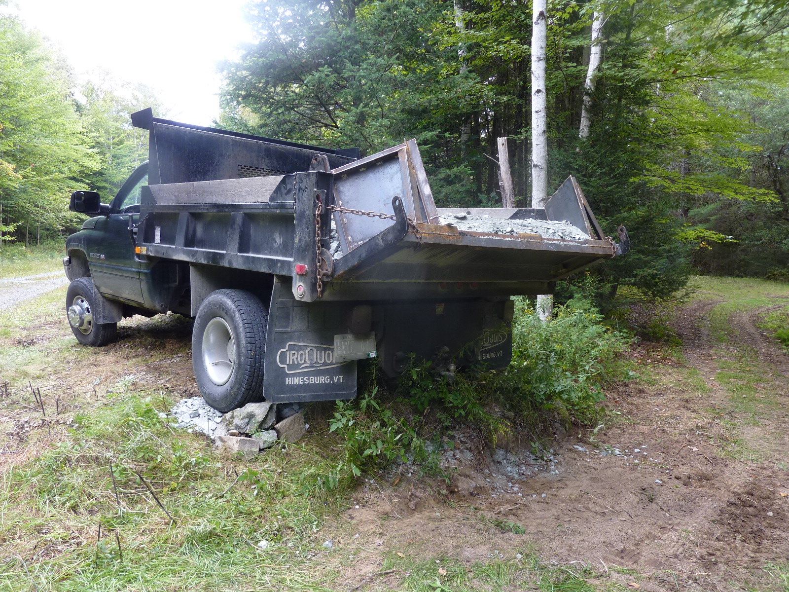

You can see that I need to get the truck higher or the trailer lower so that the tail gate is angled down to get a clean dump. I thought I would make a 2 foot deep pit to get the trailer lower. I wasn't sure if the chute scheme would work and thought it might just get twisted off. I made a test today in a spot that isn't ideal. The trailer is sloped and the truck isn't high enough but at least I could see if it would work. I took a video because I couldn't see what was happening being that my truck dump control is in the cab. If it got all twisted up and mangled I wanted to be able to see it. Here is the video of the test.

This is after I pulled the trailer away - pretty shaky support for the truck. That was a 3 ton load.

I'd call that dump chute a success, like you say just get the trailer little lower and level and your all set. You have that gravel on your land or you buying it?

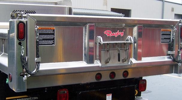

ok - this might be a silly question but instead of adding a chute that goes on with the gate down, what about putting a chute / door IN the tailgate?
I have seen these for years and had to google to find out what to call it (and still didn't get a consistent answer) Inspection Door, Asphalt Door, Coal Chute, Grain Chute - whatever.
Adding a pre-made unit to your tail gate should be a snap from what I've seen of your skills on here & fabricating your own wouldn't be much harder, just more time consuming. (I know it's always easier spending someone elses money lol)
It would definitely get the tailgate out of the way, you could partially raise the dump bed & then control the flow of gravel from the gate itself, and you might not even need the ramp / pit to clear the trailer height.

And bumpkin thanks for helping out. It is a lot of fun playing back yard mechanic. I was going to get a bigger trailer and pull it with the dozer but could not justify the cost with the use it would get. This one was cheap enough and matches the tractors specs at 3000 lbs. I thought about a coal chute type opening but I decided for my use having the tail gate reach out into the trailer half way would give me a well centered load and would be better. Besides I couldn't make anything much simpler to take on and off or easier to build. The remote will be easy. Just need a 3 wire cable and a two way toggle switch. That I will definitely do. Thanks for taking the time to comment. I'm just trying to have fun with this stuff.
