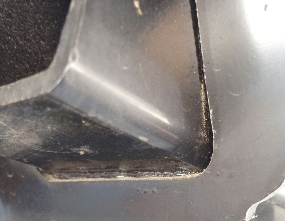

Never said anything about the size of the welder used to build the trailer. Around here, they probably used a Lincoln tombstone. Most likely was a coupler failure of some sort; worn parts, poor fit up, adjustment, no coupler pin, etc. It's fairly evident that safety chains failed or weren't used. I'll update when I hear the trailer's inspection has been completed.
Why didn't you weld the backside of your trailer hitch? Looks to be plenty of room for a mig gun in that space. I also would have tied in the corner where your two welds meet on the front side. Just me.
Couldn't be anything else, such as forgetting to set the hitch and attach the safety chains. Yup probably 120v MIG welds. You guys are nuts, MIG welds are strong, this hitch is bomber!
Frontside
389560d1410155104-test-welds-failure-comments-trailerhitchweld2-jpg
backside
389559d1410155104-test-welds-failure-comments-trailerhitchweld1-jpg

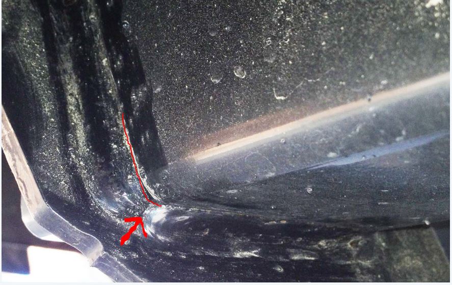

This looks like a weld defect to me. The arrow is where the joint is improperly joined, and the red line is tracing what looks to be a crack or pull starting where the weld is not properly tied together. If it is not a crack, there will eventually be one there I suspect. The weld will start to crack at the weakest point...and that is the weakest point from what it looks like.
