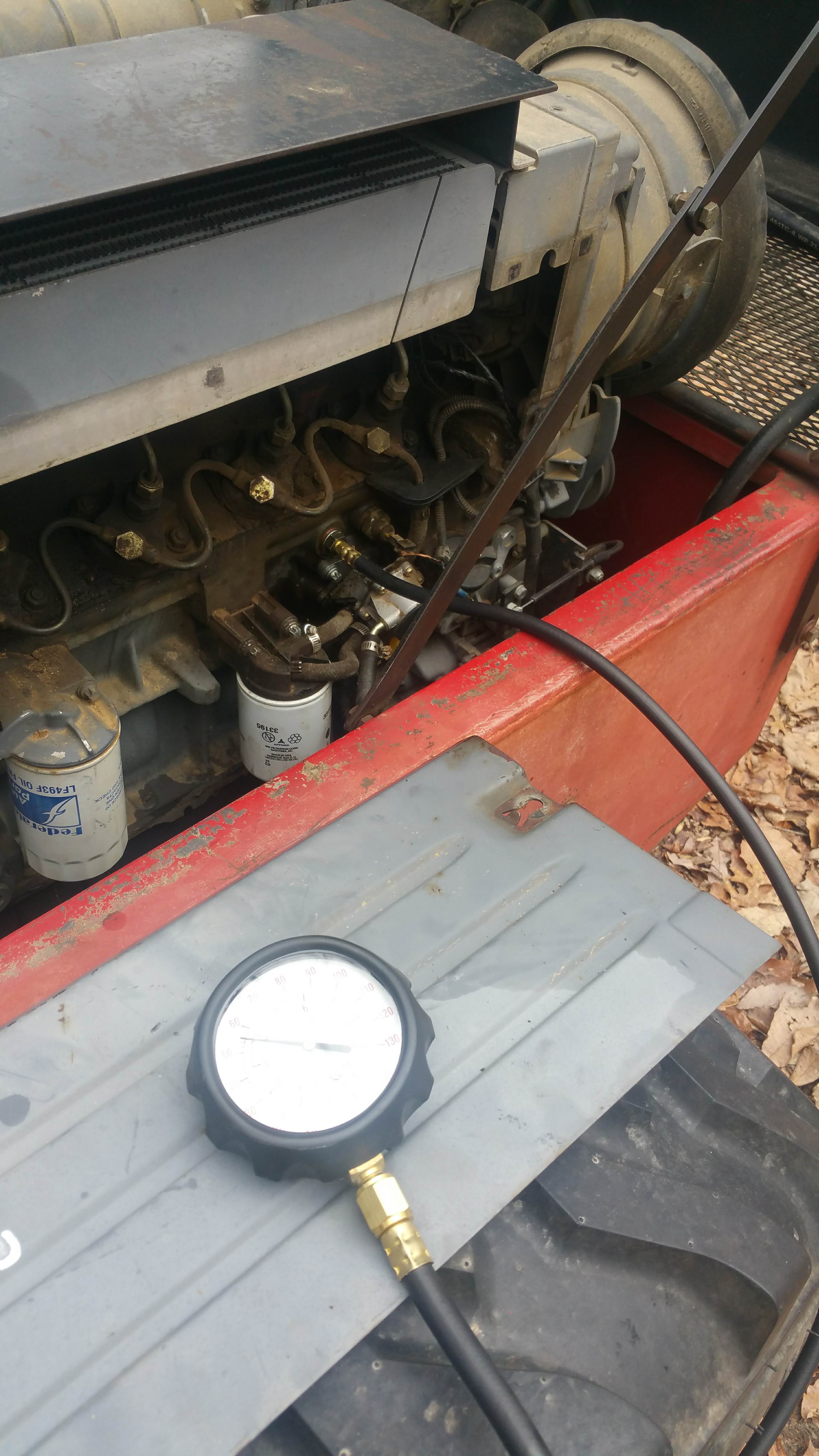

Have the 1011f duetz 4 cylindar in my 1PT1460.
Just saw no oil pressure on the oil pressure guage at dash. I saw on another post the gold cylindar with 1 wire coming off it on the drivers side of the Duetz deisel engine is an oil presure sender. Can I test for bad sender/wire by putting a battery with 3 volts nominal with positive battery post on the one wire coming off the gold canister and then negative battery post to ground to chassis. Then turn ignition on only one click-before engaging starter.
Theoretically, this would show about 1/2 pressure on the oil presure guage, assuming the sender voltage corrolates as 5 volts to maximum oil pressure?
If I see the oil guage go up with the 3 volts from the battery, then I know I don't have a bad wire from the sender and I possibly have a bad sender or engine problem.
If no change at the dash pressure guage with the 3v battery connected, then I either have a bad wire from the sender to the guage, or I actually have a really big problem with no engine oil presure?
Any thoughts on this?
I guess I could also connect a manual oil pressure guage to the hole where the gold canister is screwed into the Duetz engine block?
Does anyone know what the thread and pitch is for the gold oil canister pressure sender on the Duetz so I can get the right fitting to screw into the block and check the pressure with a separate manual oil pressure guage?
