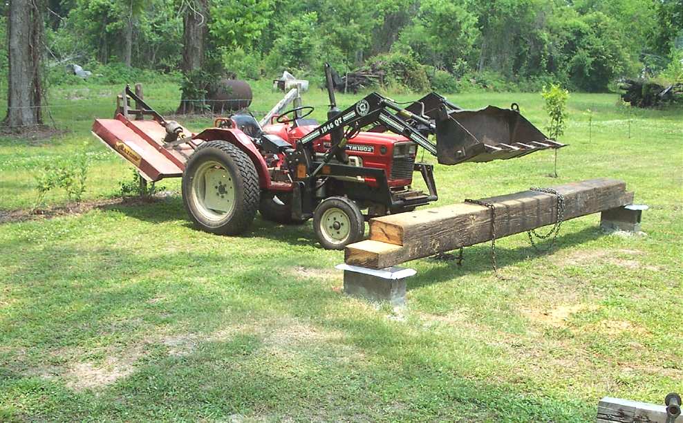

If your house is on piers, you must have termite shields like in the photo. If it is on a slab, you get the ground treated before you pour the slab and usually again around the slab.
This is just for subterranean termites which are the most common in our area. Just cross your fingers that you don't get Formosan termites.
