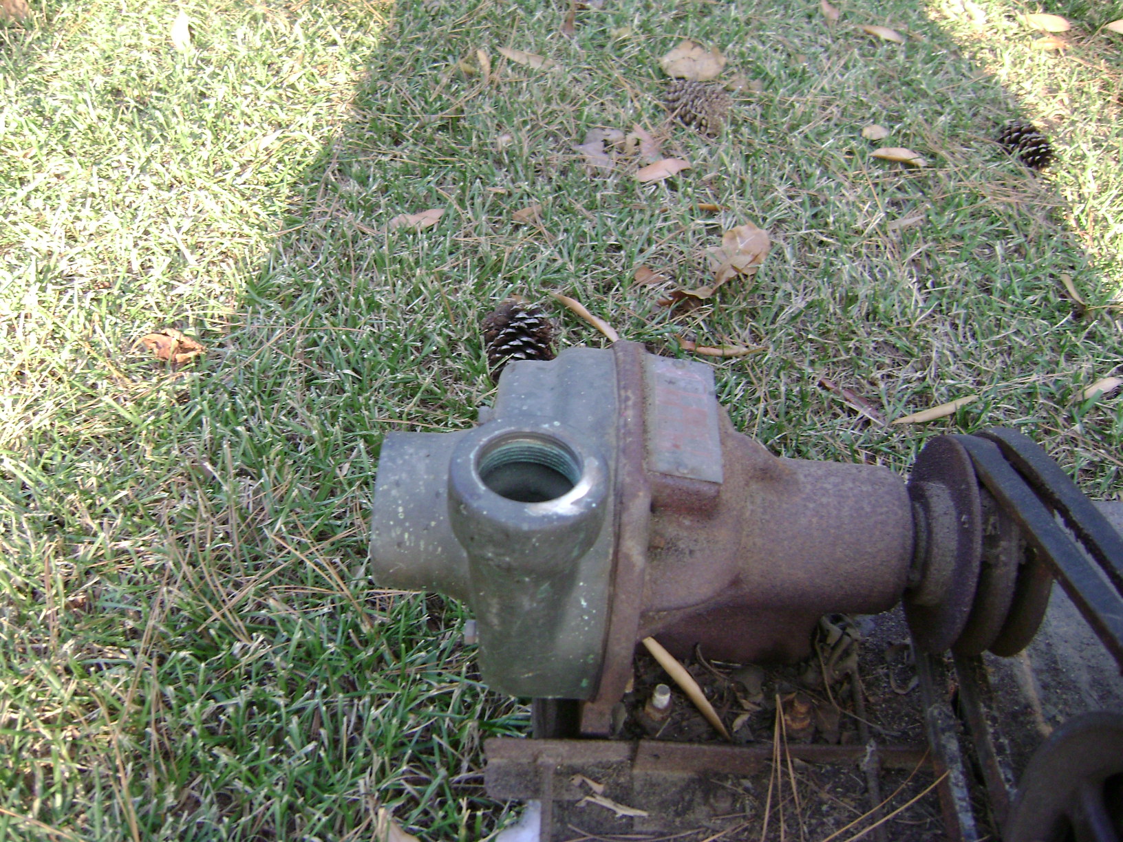

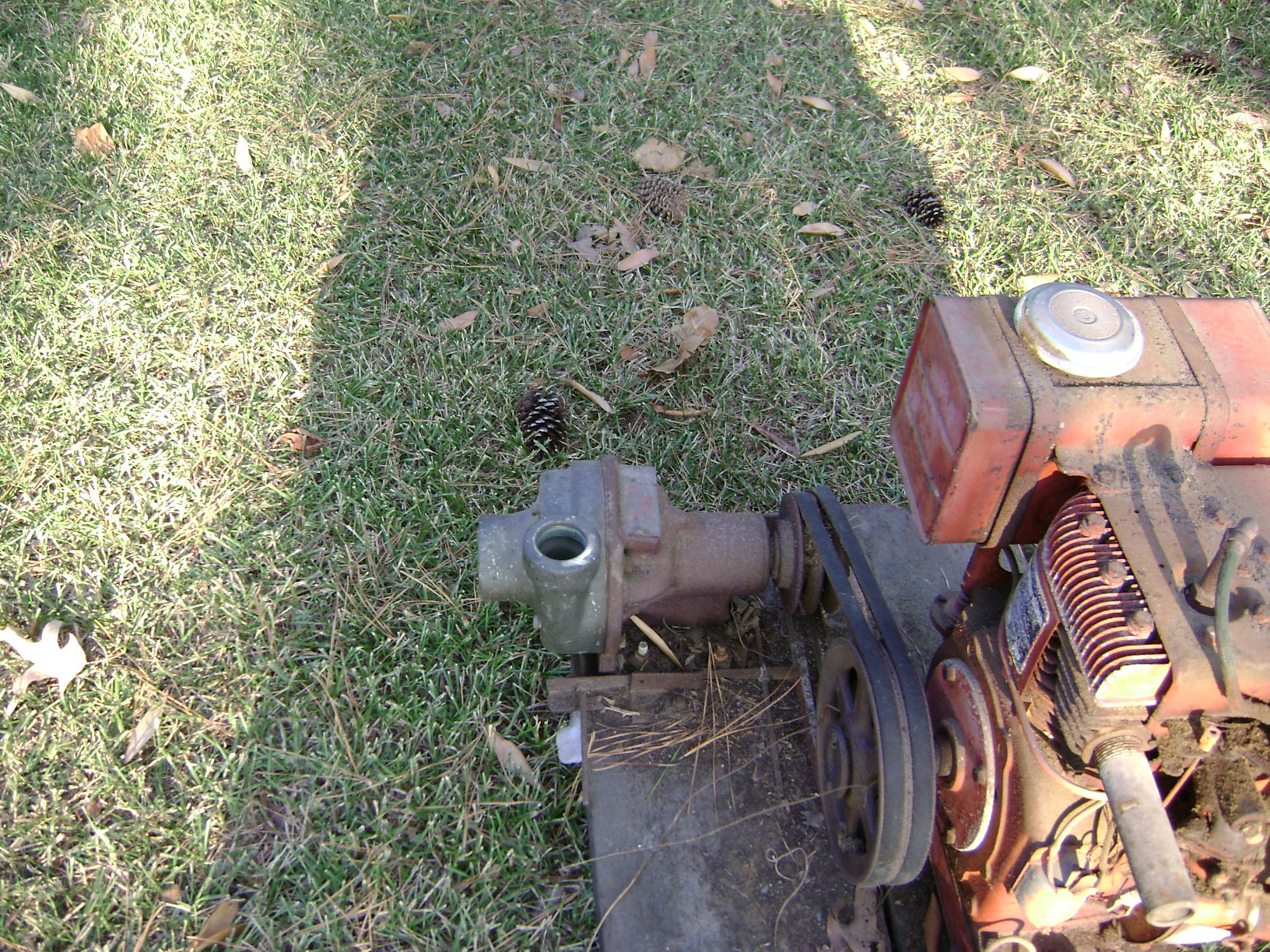

What kind of pump do you have for the jetting? What kind of soil do you have? You do understand a jet doesn't work well in clay, now in sand a jet will cut like a hot knife through butter. :laughing:
   / Temporary Piling Crane
#13
I will be using a very old SCOT 1.5 inch circulating pump. It will develop about 55psi and deliver about 80 gal/minute @ 3500 rpm. It was used about 30 years ago to jet down some sheeting in the same type soil. I'll have to jet through about 2 feet of silt/mud, then its all sand. I'll have to be careful of the original piling I am putting it next to...to make sure I do not dislodge it.
