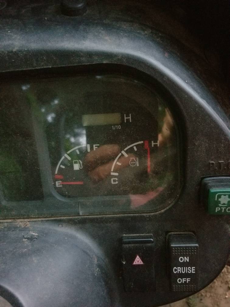

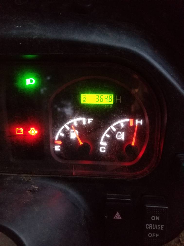

Disconnected from sender and gauge arm now stays pegged hot. Connected same scenario. I put around 4 hrs on it today. Dead short? 20190623_204122.jpeg20190623_204100.jpeg

Take a look at the ground for the panel. Also the 12VDC.
By "adjusting" how did you adjust?
No ground sends a guuage to full scale, grounded it will read zero or cold or whatever at the low end.
