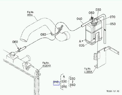

The HST model does have a recovery tank on them, maybe you can add one to your DT.
469333d1463840138-temperature-gauge-l3400_reserve_tank-jpg

Been about 3 weeks, and as of right now my coolant is at the top of radiator, I would think it would have a fill tank on it but all there is, is a hose going down side of the motor. I did put some stop leak in the front end a few weeks ago, maybe that helped. At-least I know my temp gauge is working.
