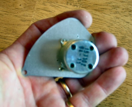

Jim my temperature gauge also went south months ago. At that time I found out the the gauge module literally plugged into the front side of the PC board. And since I was lucky enough to have another instrument cluster I was able to switch out just the temp gauge with success.
Mike, I took out the screw on top of the gage face and also the one on the bottom below the foam. Then I saw two solder connections and assumed the gage was soldered in. I never even thought about it unplugging. I guess all I had to do was lift it.:eek: Well, that will make installation of another gage a lot easier. I think my gage problem just may be related to heat as much as moisture. I've had some minor fogging, but none in the last few months. The gage worked good up until about a month ago.
Anyhow, thanks for the info. I'll have to take it apart again and see if I can unplug it. Since you say you plugged in your new gage and it worked, I know it's not a problem with the wheatstone bridge circuit. It's probably right in the meter movement.
BTW: That instrument cluster is kinda "slick" the way it's put together. Did you take any pictures when you had yours apart? I don't recall seeing them.

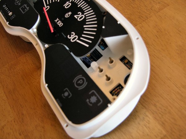

Actually I did but never posted them. Here's a shot of the rear of the temp gauge showing how it plugs into the PC board.

Thanks for the photos. I definitely will be checking out whether I can remove and clean the gage. Since it unplugs, That will make my job easier. I did pull up slightly on the gage, but next time I won't give up as easily.
