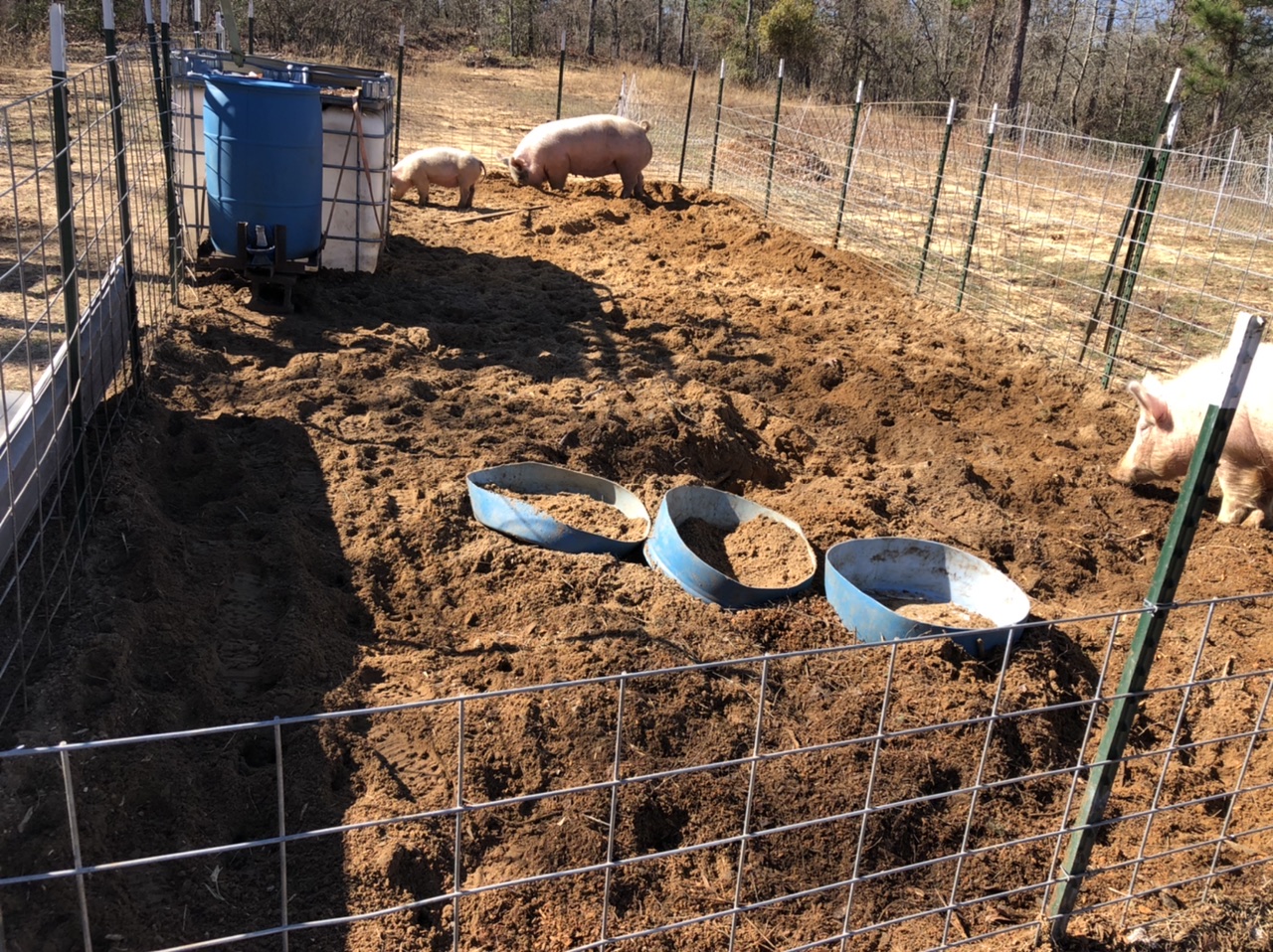

How do you feel about pigs? 3-4 in a good fence will till up 1/2 acre in a few days, just broadcast some corn. After they're done just drive over it with the rake once or twice to fill in their holes and dirt clods then plant whatever cover crop you desire.
ETA this is my pigs after their last move in the time that it took me to get forks on the tractor to move their shelter. I've had pigs in everything from sand to pine stumps and this is what they do to dirt if they are not rotated, some terrain will take more time but it gets done.
