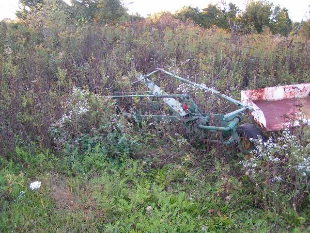

Looks like John Deere green. Has 4 plows with disc's in front of them. I'm not a farmer as you can tell. My wifes Aunt has some attachments to get rid of after her husband died and I'm trying to find out what I can about it.

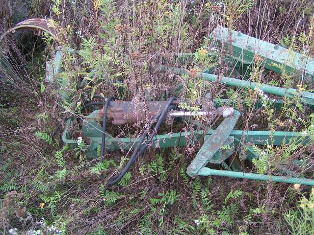

Another view

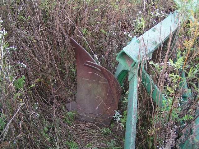

Close up of the actual plow. I couldn't find any kind of model number on it, but didn't know where to look.

Appears to be a semi-mounted plow. Beyond that, not enough to look at to tell. May be able to associate it with one of the tractors that are (or were) on the place. If it's Deere, there will be some part numbers, I believe, that indicate as such.
/ Tell Me About this Plow #5
From what I can see in the foto's....looks like a bottom plow with sod wings...the discs in front of the sweeps are probably colters...they came smooth or fluted...they cut a line in the sod for the moldboards and sweeps to follow, ease pulling...

I agree with the sod mole boards. Can't see enough in the pictures to tell much more.

/ Tell Me About this Plow #7
It is a J.D. semi-mount plow. I have one just like it...will have to run out to the field tonight when I get home from my "real" job to get the model #.
/ Tell Me About this Plow #9
The piece above the moldboard was called a cover board. It made sure that the top layer of soil material being cut by the coulter and turned by the moldboard got completely under as the plow moved forward. The cover boards wear more quicly than the moldboard.
Some coulters were serrated for more effective cut of corn stalks, again allowing better cover.
The real wear part is the plow points, bolted to the bottom of the moldboard. Older plows had plowshares at the bottom which were generally heavier and more costly than the points. We always took shares to a shop for a new welded nose whereas the lighter/cheaper points were just replaced.
Several types of tripping mechanisms were used to protect the plow when it struck large rocks, etc. A hydraulic rig was used as well as spring loaded devices. Both allowed the whole bottom to kick back. These were a far cry from old pull type plows that were attached to the drawbar via a clevis. When you hit a rock, the whole plow stopped and jumped off the clevis, also breaking the trip rope (for mechanical raising/lowering) away from the tractor.

Re-looked at the photos. Paint color, although faded, suggests you might be looking at an Oliver, not JD. The Oliver paint was somewhat bluish compared the brighter JD green....

It's a JD model #145. They made a zillion of them. I've owned 3.
The 'disks' are coulters to cut the trash on the surface mostly, tho they do help slice the ground too. They came smooth, ripple, slotted, or cone. Cone is cool, break down more with more $$$ holders but throw the trash to the side so it doesn't plug as bad. Whatever type you have, they are probably wore out as they need to be LARGE and if you are replacing them might as well get rippled, generally a bit better in most conditions. Whatever you get, get as large as possible.....
The bent wings are cover boards, they help to get taller growning stuff turned under & burried as you plow. They are rather rare in my location.
They came with 14 or 16" bottoms (measure between frame members to see what yours is, straight across) and there was a 'HD' version designed to plow a little deeper. Probably many other silght variations too. The frogs (part the shiny pieces bolts to) is slightly different for these variations.
They probably came out in the 60s, wonder if they sold into the 70s? Was a very popular machine in it's day, you can get any part you want for it from JD, but in my neck of the woods 3 bottom models sell for $500, while 4-6 bottom models sell for $100 scrap, so just buy a couple & have all the parts you need.

That picture shows 3 bottoms, the one I have has 4. Does that make a difference in the model number? I also couldn't tell if it has hydraulics, I would think they would have to otherwise how would you lift the plows for transport.

</font><font color="blue" class="small">( That picture shows 3 bottoms, the one I have has 4. Does that make a difference in the model number? I also couldn't tell if it has hydraulics, I would think they would have to otherwise how would you lift the plows for transport. )</font>
They are a semi-mounted plow, means they use the cat 2 three-point lower arms of the tractor (does not connect to the top link!) and a hydraulic cylinder raises & lowers the rear wheel.
They came in 3-6 bottoms as I mentioned before, all are 145 model. They were not built heavy enough for that 6 bottom version, lots of broken rear linkage shafts & lower hitch. Worked real well in 3 & 4 bottom.
