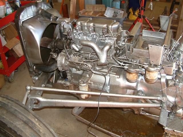

In Jul06 I bought a 1964 MF135 diesel deluxe with multipower for $3600. 4600 hours, engine rebuilt at 3000 hours. The engine is the Perkins AD3-152 diesel (3 cyl, 152 cubic inches displacement). These old Perkins diesels have an excellent reputation for durability. Don't know about the Perkins gassers.
It ran but needed a thorough cleaning (radiator fins were clogged with crud, etc), new fuel gauge, ammeter, rewiring. I repainted it. It's in my shop now with an oil leak somewhere on the engine and a leaking rear pto shaft seal.
These photos may help you decide what that 135 you're eyeballing is worth.
Check it out for any leaks, funny noises in the engine/tranny, smoke coming out of the exhaust after running for 5-10 minutes, hard shifting to get the pto working.
Crawl under the tractor and locate the two weep holes on the bottom of the clutch housing. There may be loose fitting cotter pins in these holes or the pins may be missing and the holes clogged with crud. Take a piece of wire or a small twist drill to ream out the holes and watch for any oil leakage. A few drops is normal--a steady flow may mean that the rear main engine oil seal is bad.
Good luck
