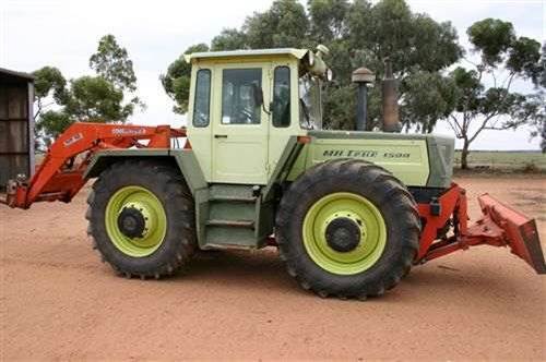

So can you help me with a few simple questions which I can't seem to find answers for "DownUnder" & advise on my tractors:

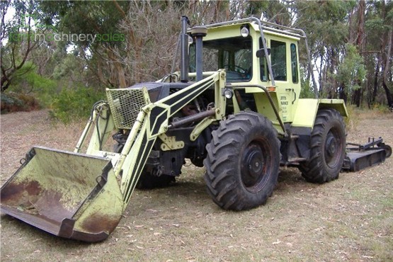

1. Refer Photo 3 -Which is the front & which is the back of these tractors ( there's a 3PL, remotes & a PTO at both ends which makes it confusing, especially when running a baler & hay rake. The PTO's also spin in opposite directions & not always at the same time is this correct? )
2. Refer Photo 1 -Will putting a loader on the rear end ( then again it may be the front end) does it make the tractor go backwards ?

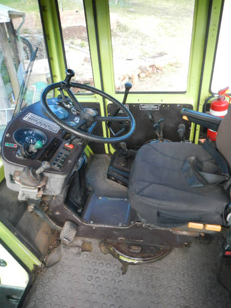

3..Refer Photo 2 - Will mounting this rear end loader on the front end make the tractor go forward or backwards & which direction shoudl it be used ?
4. Refer Photo 3 - Which direction they will go with dozer blade on the front & a loader on the rear, or have I erroneously mounted a rear dozer blade on the front & a front end loader on the rear ?
5. How can I identify if it's a rear end loader or a front end loader when it's not on the tractor (ditto for the dozer blade - sorry can't provide a photo with the loaders off the tractors as I need to know before I remove them so they're not mixed up) ?
6. As the steering wheel, seat & controls I think rotate/swing 180degress which direction is it best to face ? Then again it could just be the engine is moving around, as sometimes I see the engine is behind me, whilst at other times I find the engine has moved out in front of me, so maybe I should be asking where is it best to put the engine ? I've noticed a lot of tractors seem to keep their engines at the front now, is this because people don't know how to reverse their engine or do they take the easy way out & fire up the engine cylinders in reverse order to have the same number of gears to drive backwards?
7. Is it best to rotate the steering wheel or engine 180degrees to the left or right to change direction ? And when I subsequently engage reverse gears should my tractors go in the opposite direction to the way the steering is facing & when I engage forward gears should it go in the direction the steering wheel is facing?
