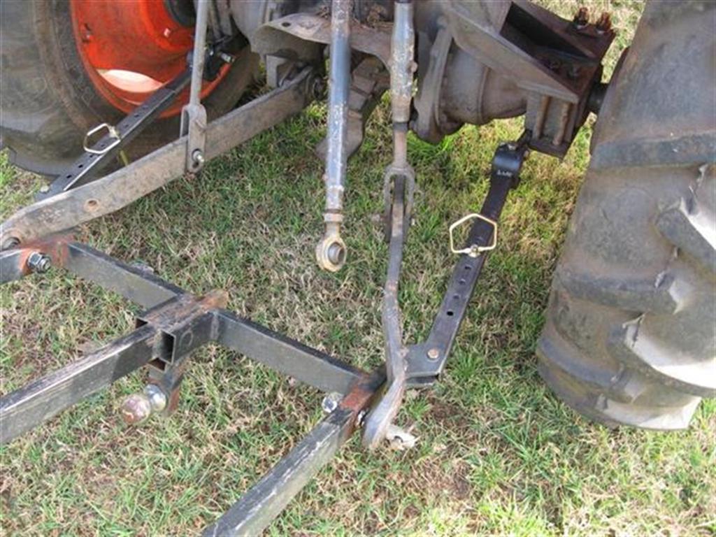

/ Telescoping Links on a 7500?? #8
Prices got pretty high for the L series...so I made mine. :D
