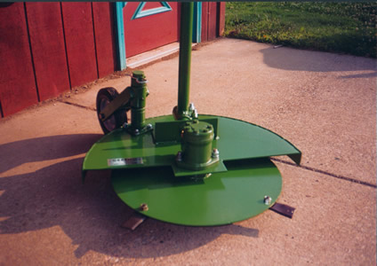

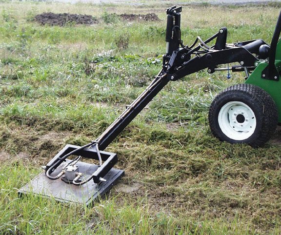

These mowers are about as simple as you can get. The first one is PT small boom mower, and don't know who made the other one.
no mower yet...still estimatin'...using pt decks is one approach
altho 2445 specs are 15 gpm at 3000, don't know what the aux flow is. Using PT's small boom mower as an example, would its needs be far different from say a PT auger, tiller or trencher?

A motor for an auger needs to be large for the torque/HP required. Small auger head, small auger bit. A small auger head would turn a large bit, but digging a hole, it would stall easy.
I am just guessing that the aux circuit is no more than 1 or 2 GPM. You could test it out by taking off a hose and put it in a bucket for 15 sec, then multiply by 4 to figure the GPM's. If you get a quart in 15 sec, then you have 1 GPM flow.

i appreciate the excellent insights...i'm guessing too... with no documentation to speak of to go by it's that or wait til i'm at the farm to try the bucket approach...with auger, tiller and such as comparables, i'm guessing you, as usual, are very close to the mark...
