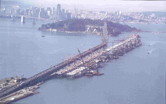

what is your thinking on making him weld with one hand??I don't see any benefit there.
Well, I think you'll agree. Sooner or later he is going to be standing on the top step of a 12-foot step ladder reaching out as far as he can welding over head. Or leaning back in a safety belt 200-feet in the air reaching as far as he can. Not everything is welded on a bench. If the kid can't hack it in my shop, he's not going to hack it on a construction site.;)

Very good friend of mine called last week, and asked if I would teach his wife's nephew the proper way to use a torch. Friday will be this 22 year old kid's first day in his apprenticeship. Which he will be starting on a $4.65 billion bridge. My buddy will be one of the many craft superintendents on this project.
Saturday the kid came over, and I showed him how to set up, and break down a torch. How to cut with acetylene, and propane. I could tell this kid had a really steady hand. Mind you, he has never been around anything like this in his short life! Monday he came back, and I started him on some 6010, welding flat, I wouldn't allow him to use two hands. I was shocked at how well he held the correct arc length, and rod angle. Then I had him run some 7018. He caught right onto this, so I started him on some vertical up welding, just to bring him back down a peg or two:D. This will take some time for him to master, but this kid is a very quick learner! He came back this morning and worked on his vertical up with 7018, made some good improvement. So I started him on some over head welding with 7018. Remember he is welding with only one hand!
Here is his first ever over head welding! Don't know about you, but I'm impressed!
WSDOT - SR 520 Program - Costs, Funding and Tolling
He was running 7018 verts and overhead the first day?? Yea thats impressive. I was happy if I could get somebody to quit sticking the rod the first day!! Good for you to teach him also, I hate to say it but skilled stick welding is getting to be a lost art. I would love to meet you sometime. CJ
