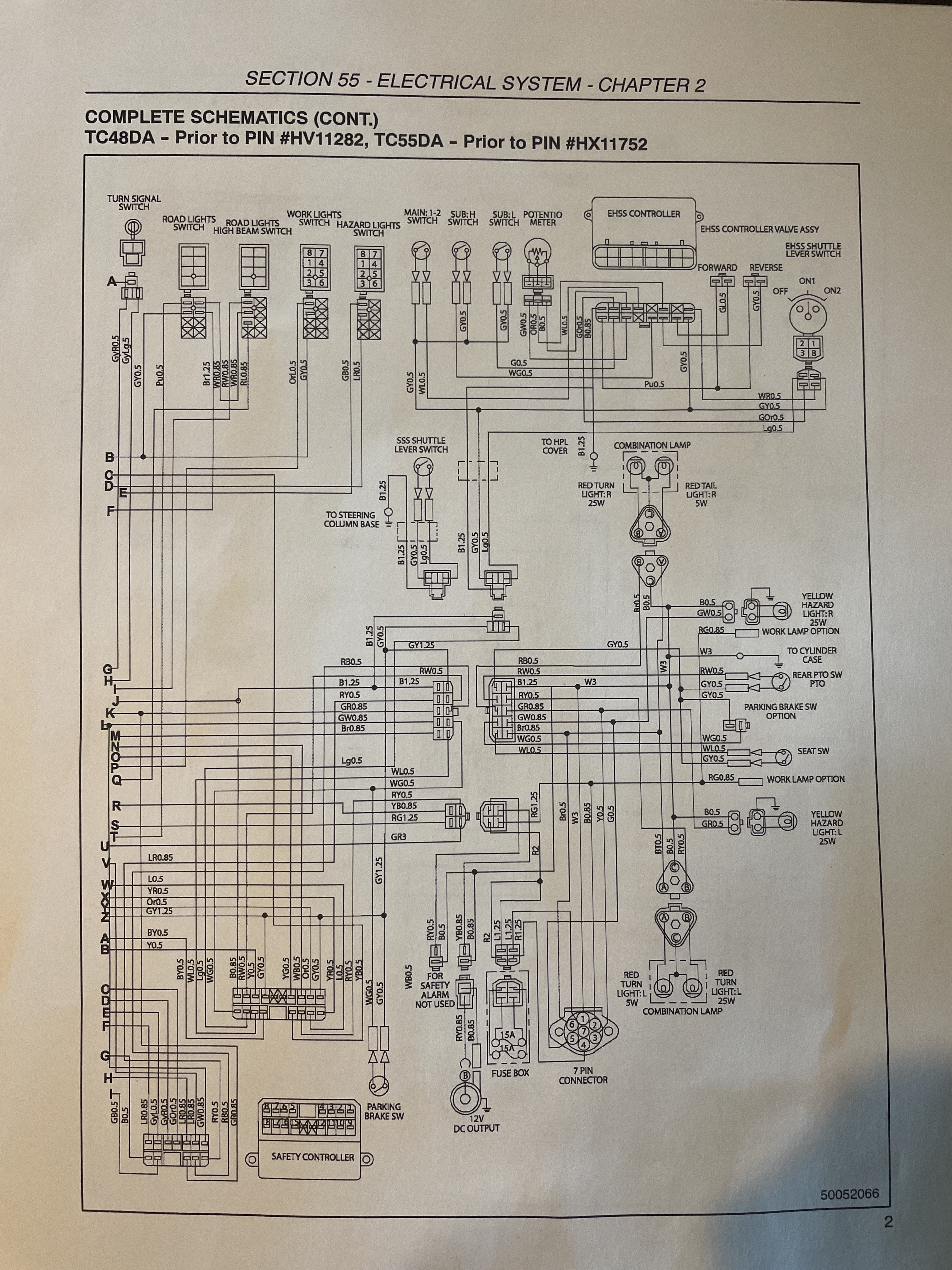

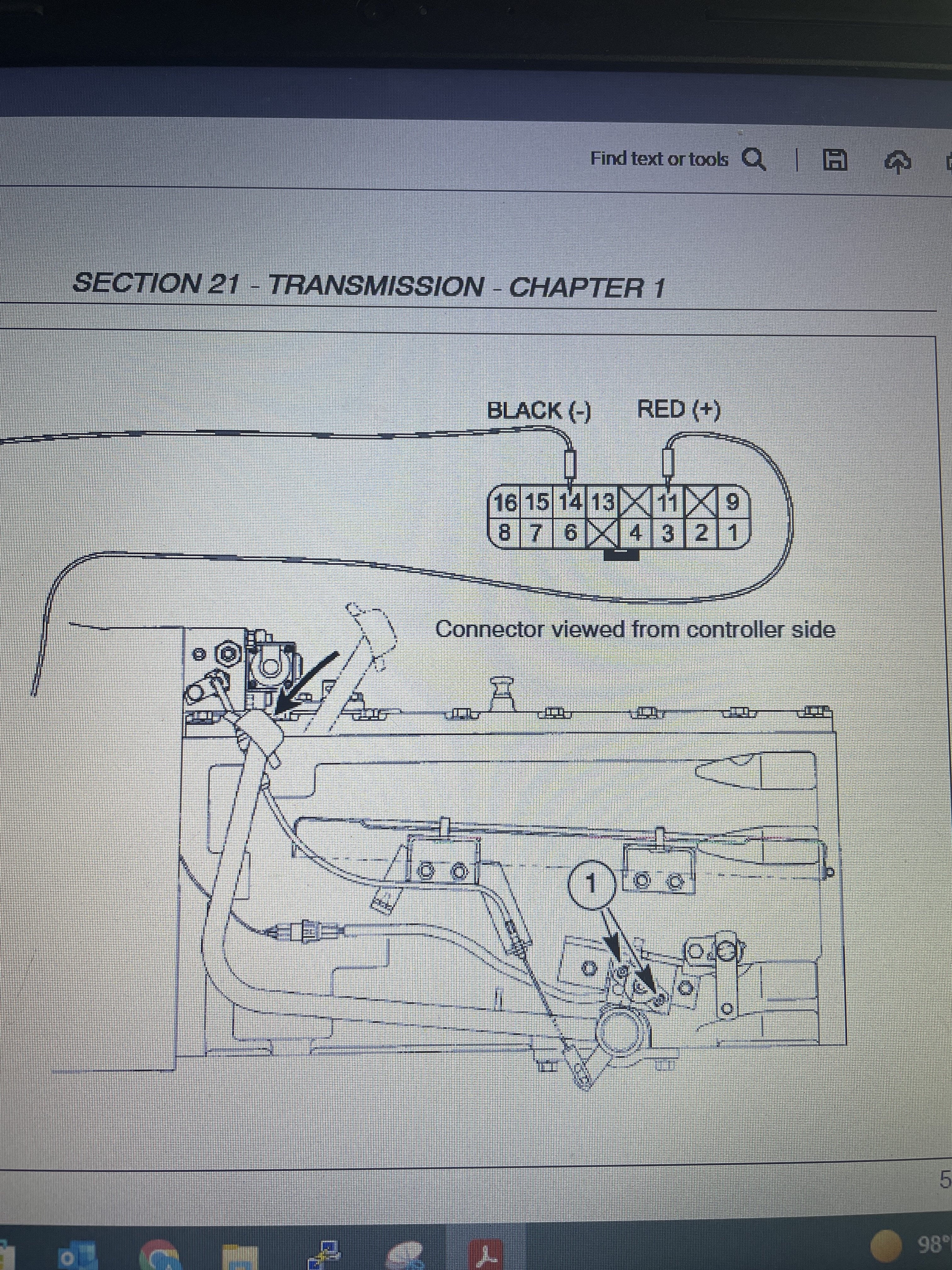

Tractor starts just fine but will not move forward or reverse on any gear. Tested EHSS connector on pins 11 and 14 should be 3.2 volts according to the repair manual. I am not getting anything 0 volts. Checked the potentiometer and verified inching pedal position. What components are involved in supplying the power to pins 11 and 14 to sen current through the potentiometer? Thank you for your help!

Complete schematic
