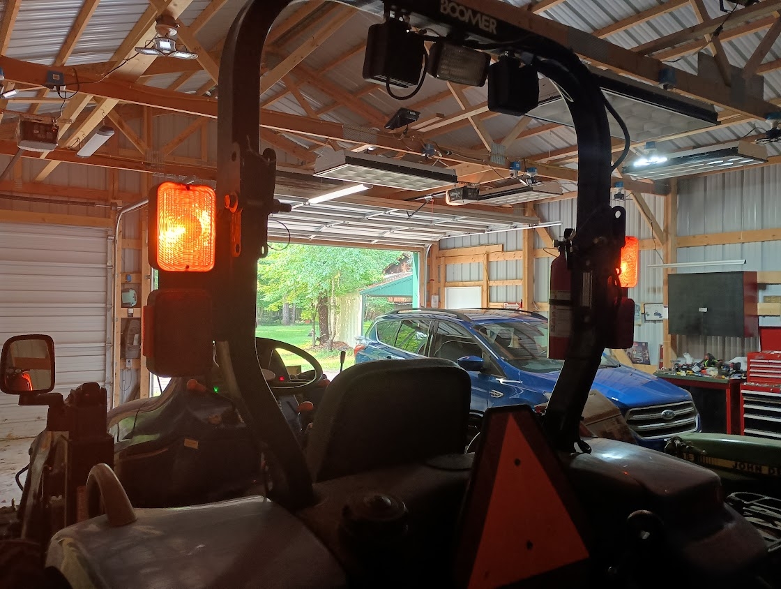

My ROPS lights are in bad condition and I am replacing them with LED lighting.
I labeled all the wires prior to cutting the factory lights off.
My question though is do the red lights (on bottom and only facing to the rear) do they flash when the hazards are turned on?
/ TC45DA ROPS Light?? #3
On my T2310,
Flashers - Amber only
Turn signals - Amber and Red
/ TC45DA ROPS Light?? #4
usually the amber are the flashers, the red being brake
/ TC45DA ROPS Light?? #5

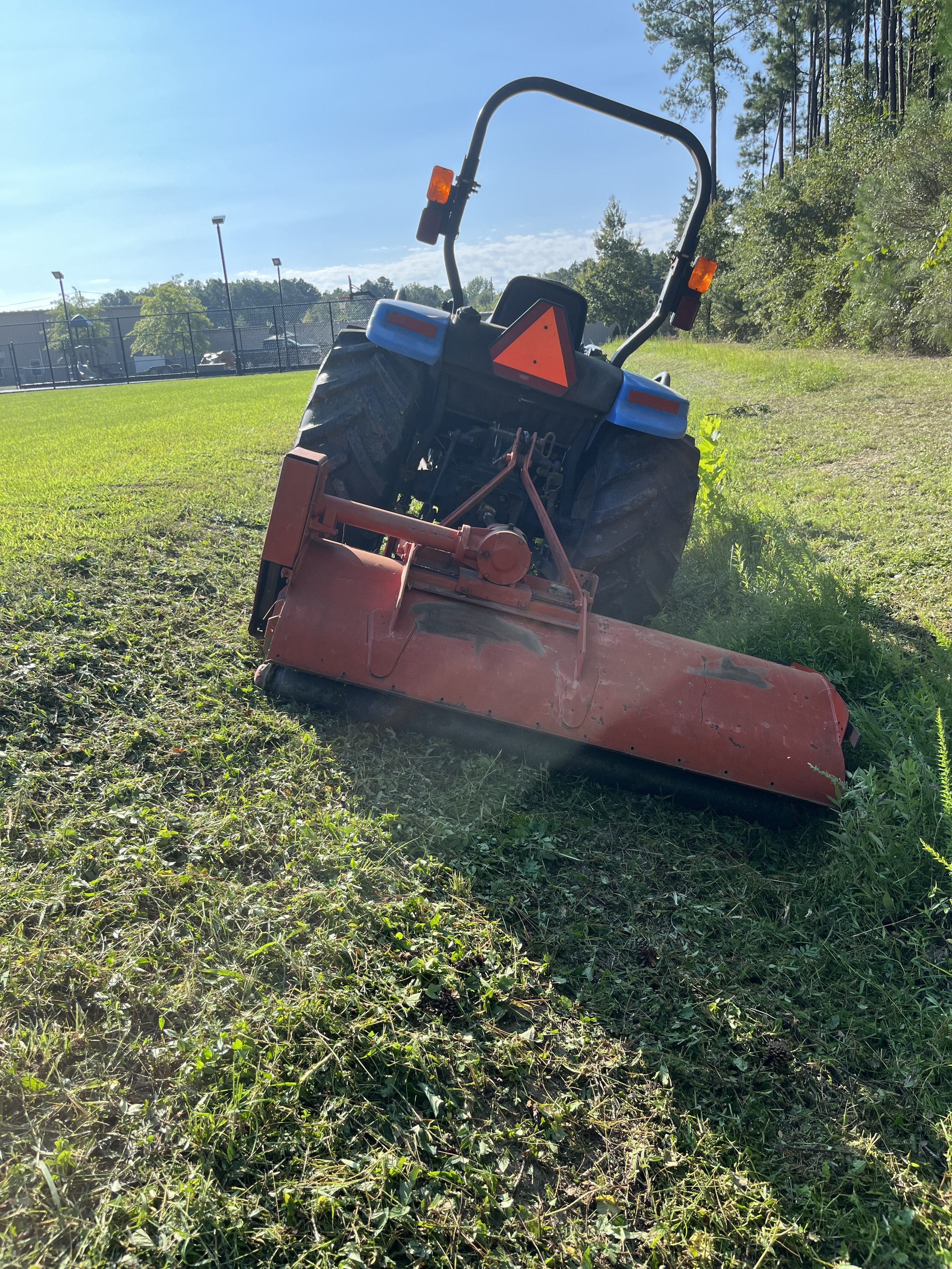

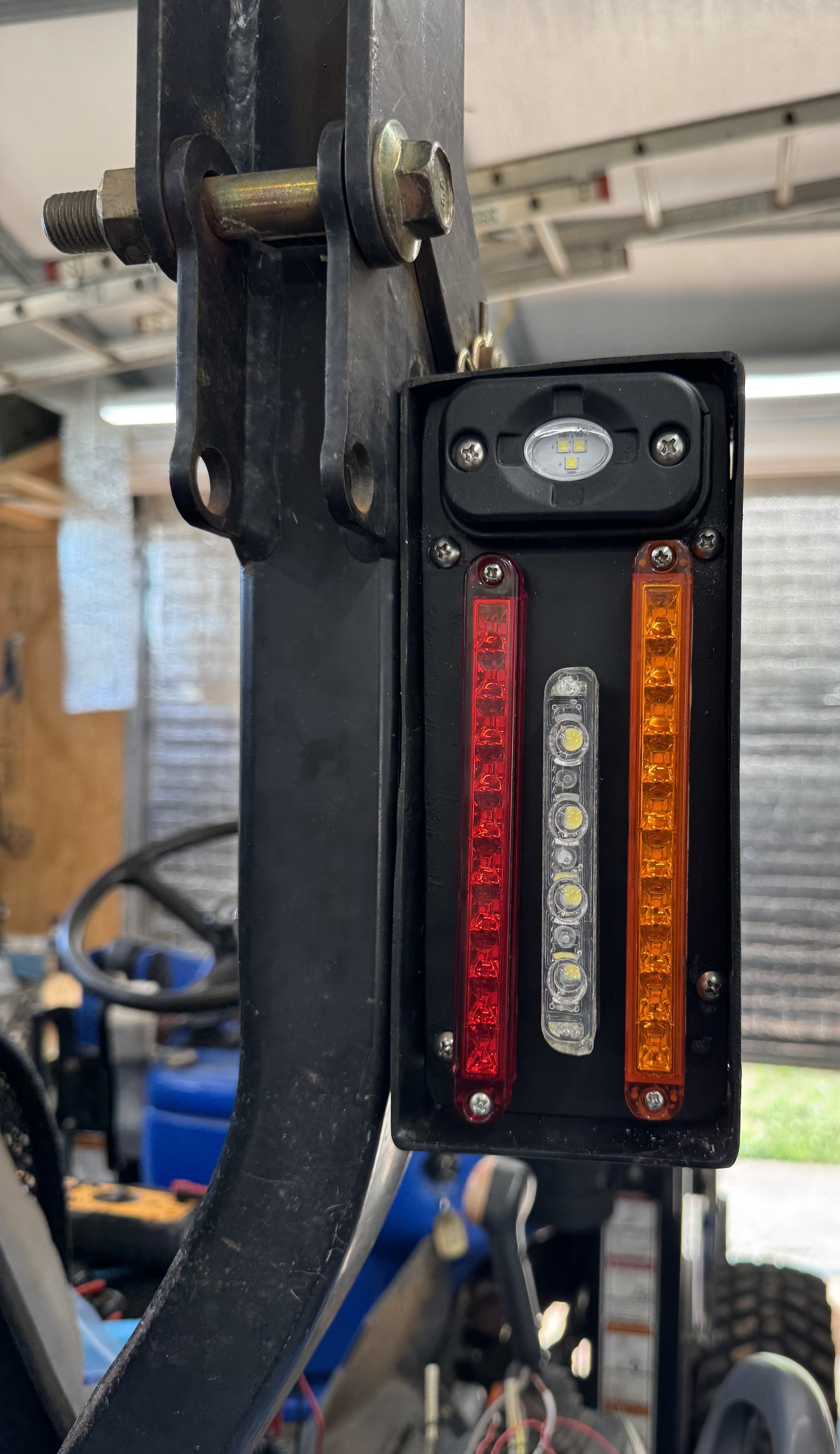

Can you post a link of where you got those lights, and pics after installation? Is that also a rear work light of sorts?
Red and amber light strips (it looks like the amber ones are no longer available):
The front is two amber vs the rear a red and amber to mimic the factory lights.
Work light(4 total two facing rear/front):
The flood lights work good but the fronts need a shroud so they don’t shine in my eyes when looking to side/rear. I tried some 1.5” tape and it worked.
I may add a 3rd flood light aimed to the side. I could not see the front corner(s) of my 9.5’ bush hog when turning.
