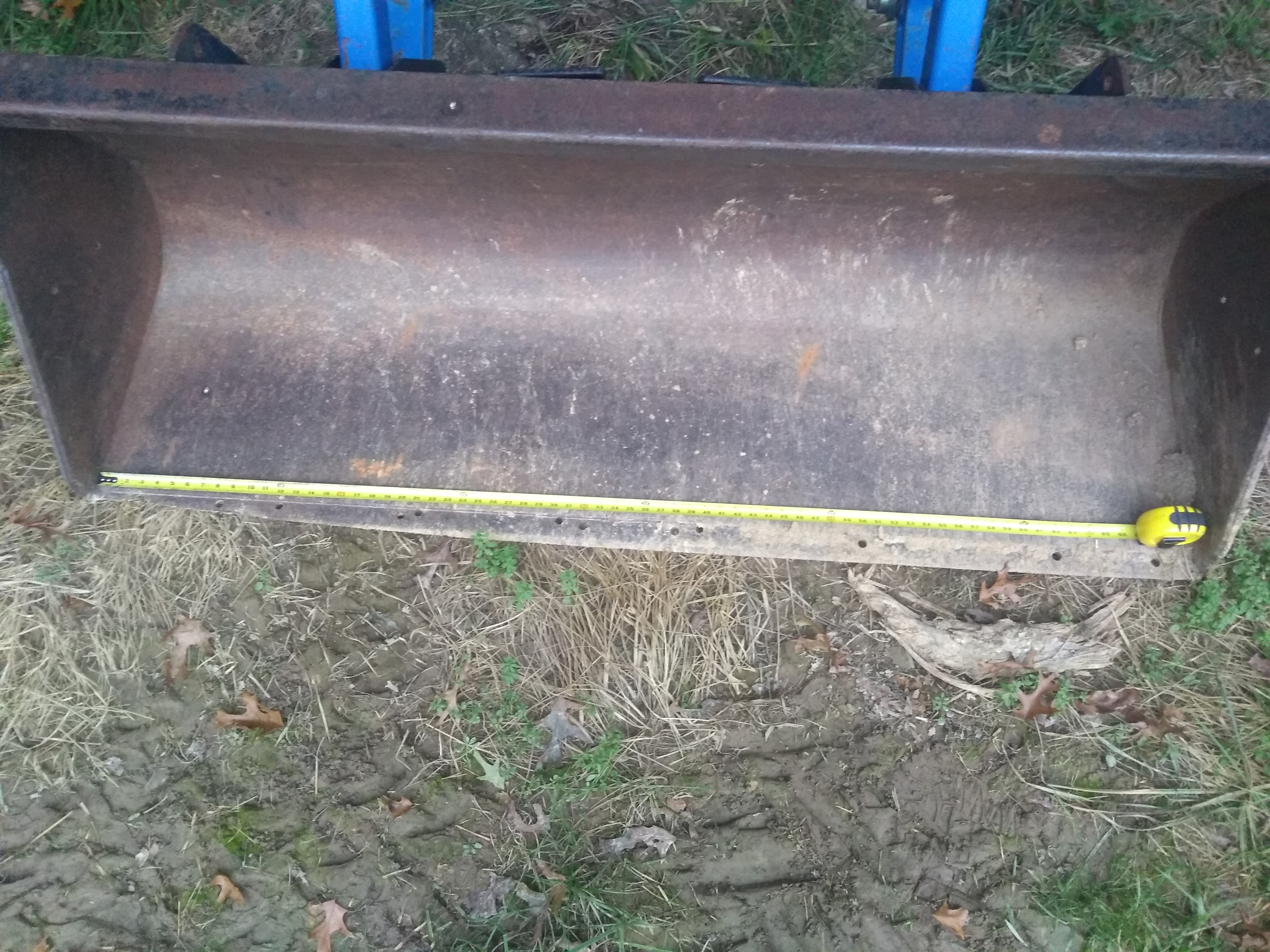

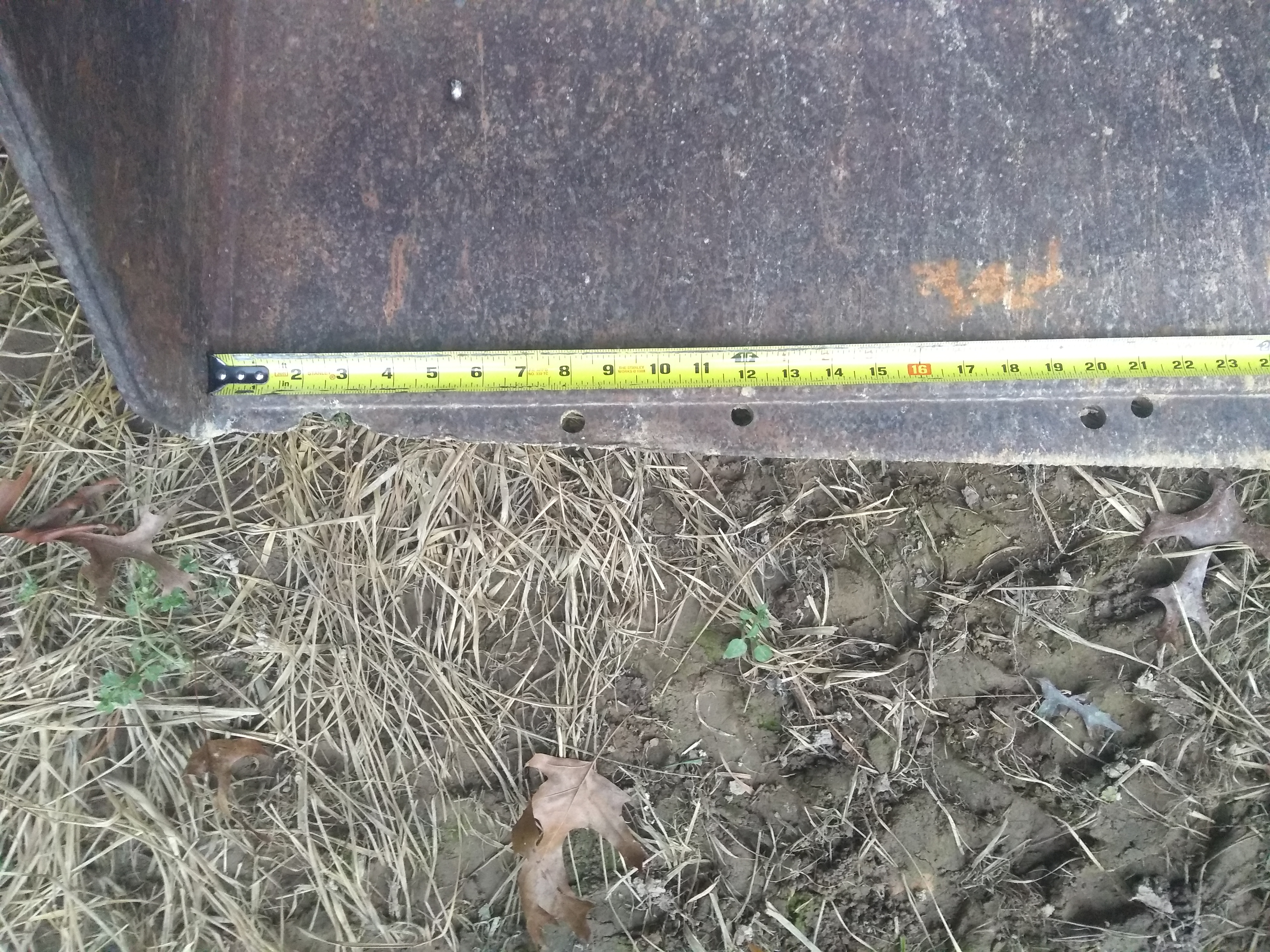

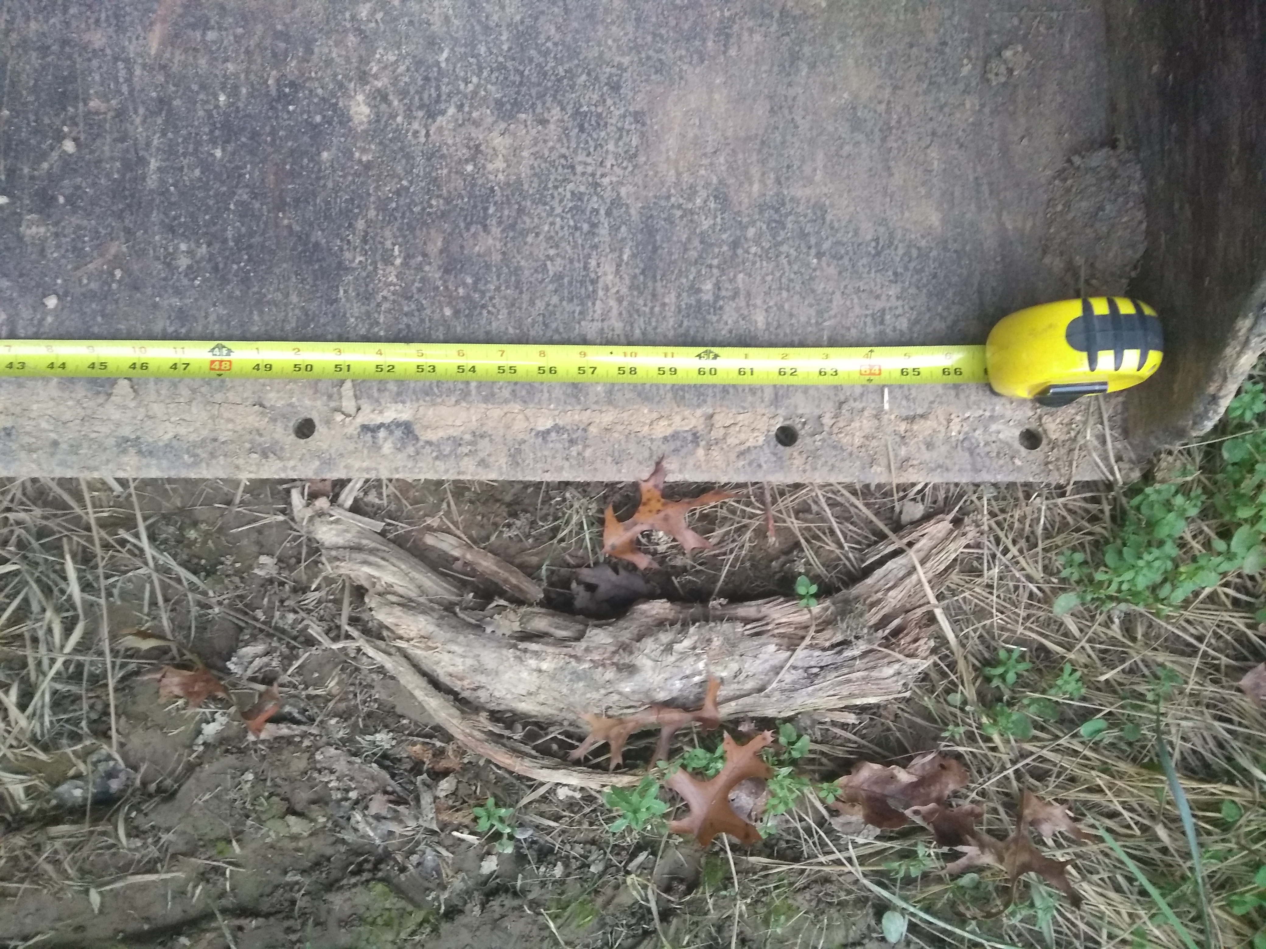

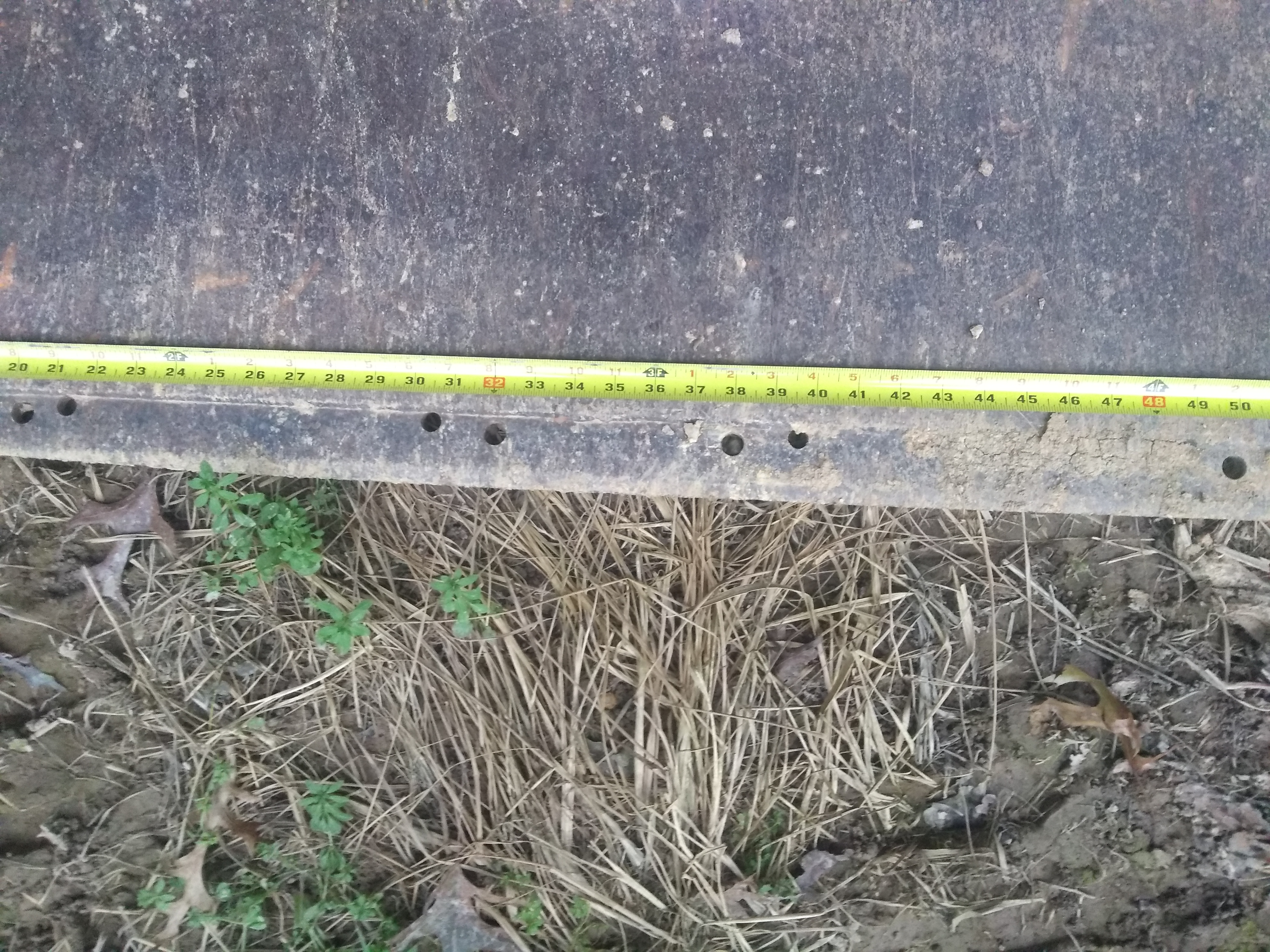

Need help with the bucket cutting edge. It looks like the cutting edge is typically bolted onto the bucket. My bucket doesn't have one. However it also has part of the bucket cut-off and extra holes drilled. Hoping someone can take a look and let me know what they think.
My neighbor is a fabricator and fixes all the local farmers equipment. He typically just removes an old cutting edge and welds a new one on. I'm thinking that with the modifications that have been made that may be my best bet? Not sure how well an OEM bolt on edge would work.
thanks,
david

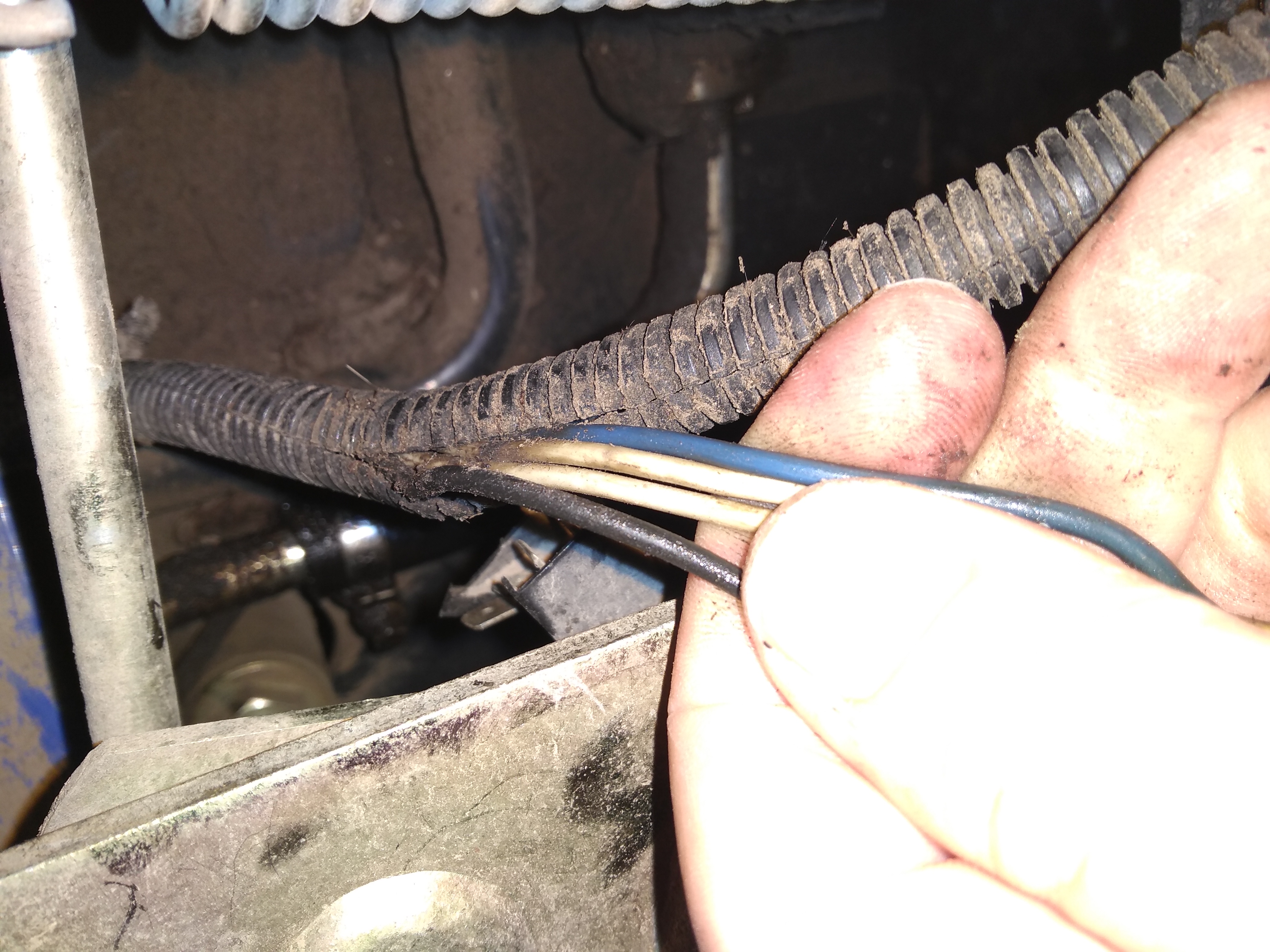

I climbed under my tractor to see what I could see.
1. the parking brake switch is disconnected, there are 4 wires in a loom next to it. The switched check out good for both poles. I'll try putting connectors on the ends of the wires and hooking them back up. Need to find the schematic to figure out how the wires hook up. I"m sure it is in the service manual somewhere.

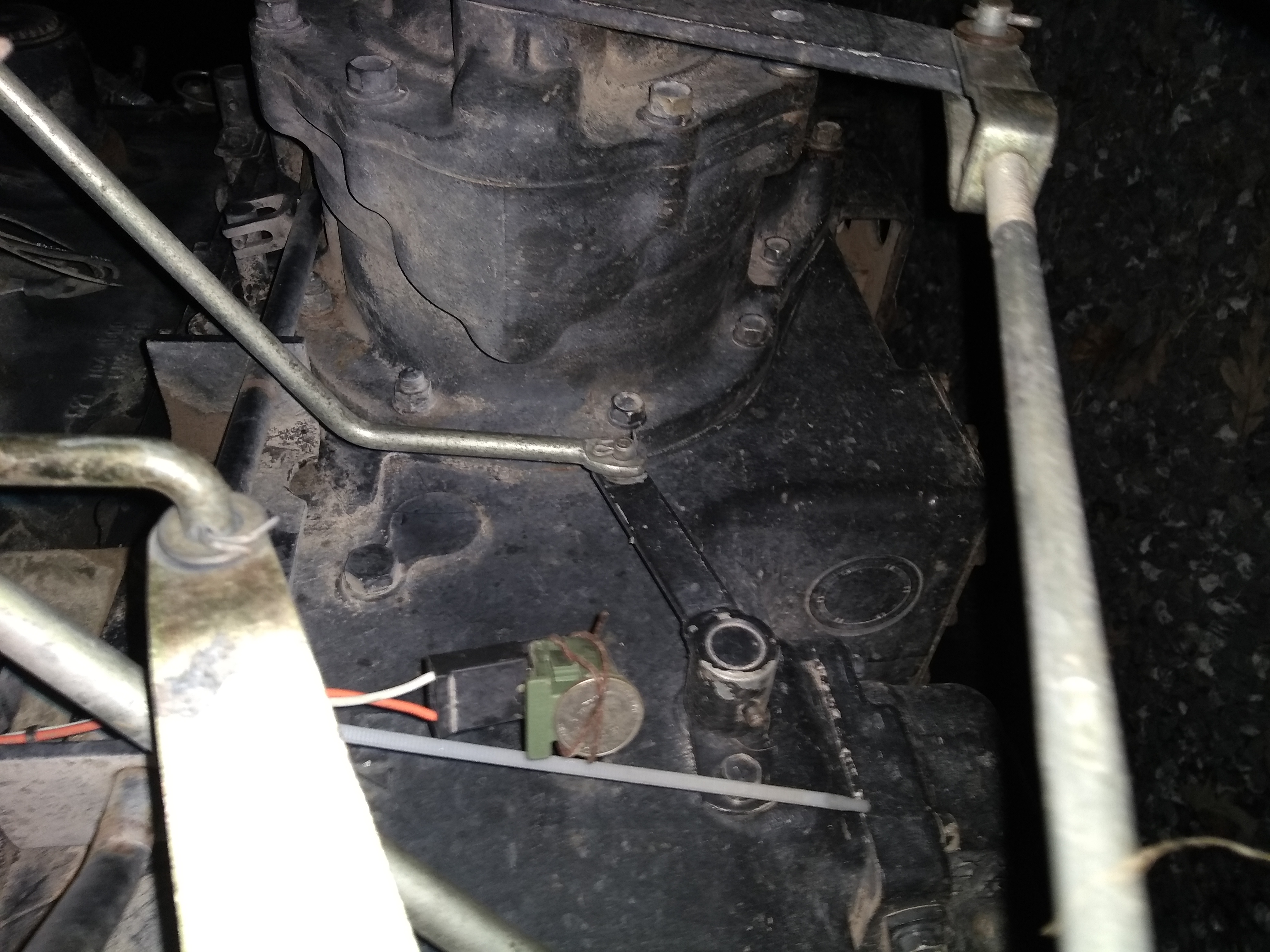

2. There is a switch that is just hanging down with a quarter bailing wire wrapped to it. I've attached a picture. This is a second main PTO switch that is used to bypass it. I verified I can start the tractor with the PTO engaged or disengaged.
