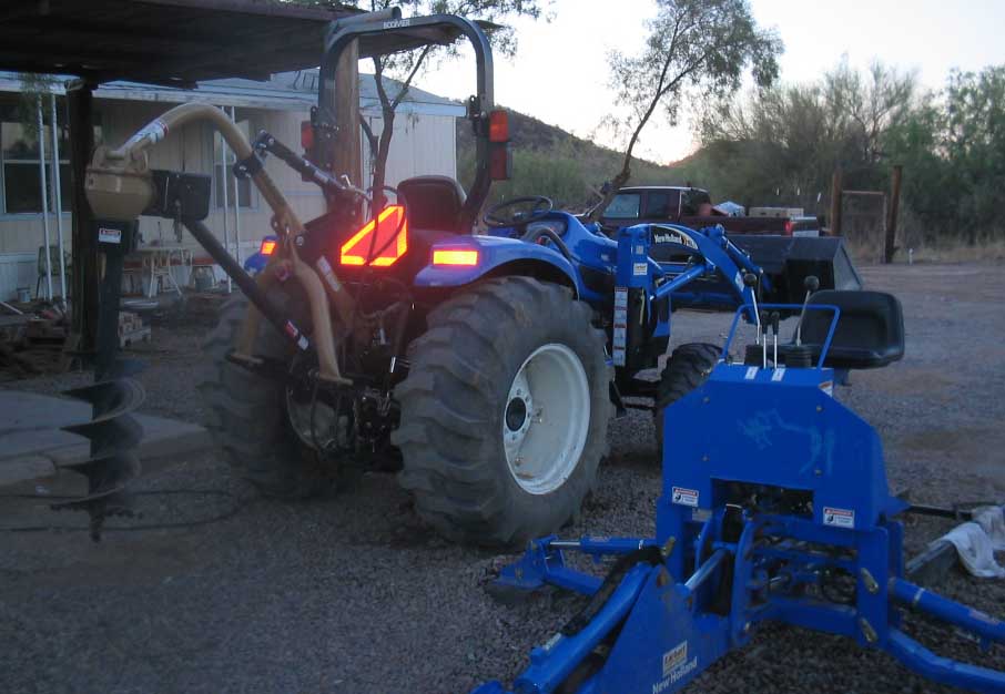

Have a little over 1,300 hours on mine and it still has all the power I can use. All 4 tires loose grip before the engine bogs down. That's running about 2,200 /2,300 RPM.
I rarely take the BH off as I can do almost everything that needs done with attached. Since I do almost everything by myself, its kind of a pain guiding it into place and getting the pins lined up. Have done it a few times when I needed the post hole digger. Almost new hydraulic gannon just sits.
Only thing that I would like to have is a real road gear. Hate to just spin the engine to go 13MPH,
