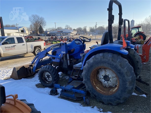

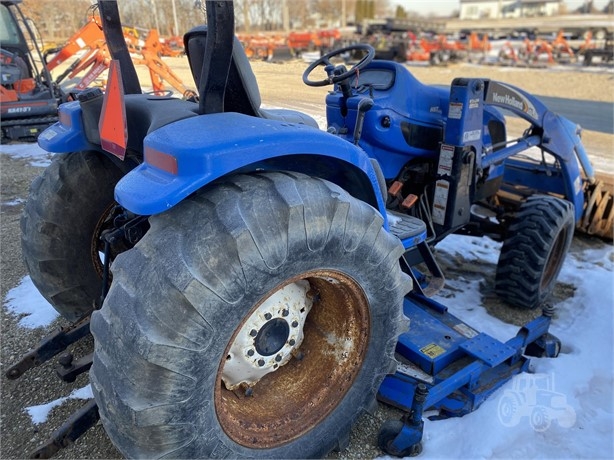

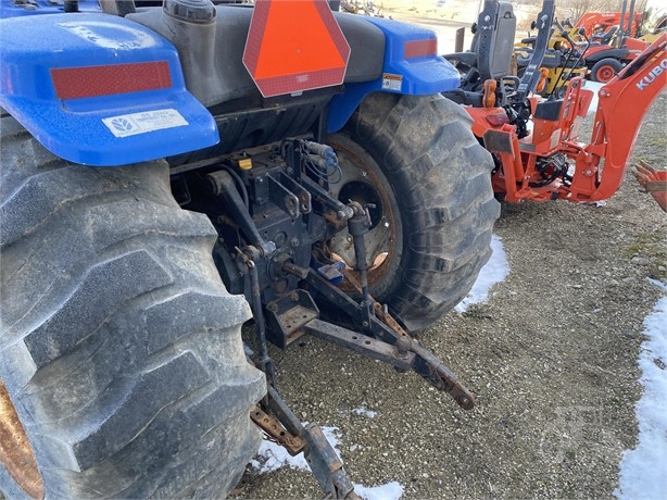

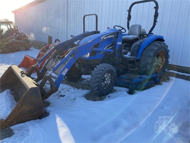

I’m going say that it was an option for all the TC45 and below.
Here are some pictures of a TC45 with a mid mount mower that was listed on TractorHouse in the last couple of years.
