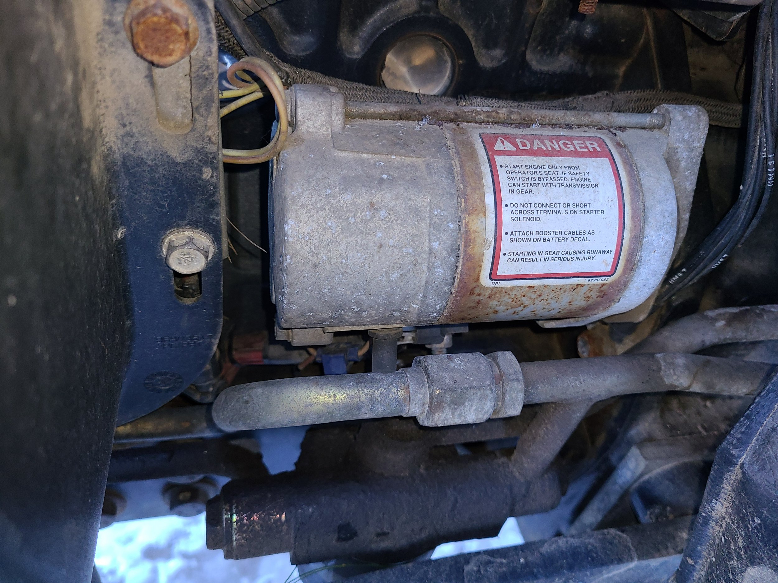

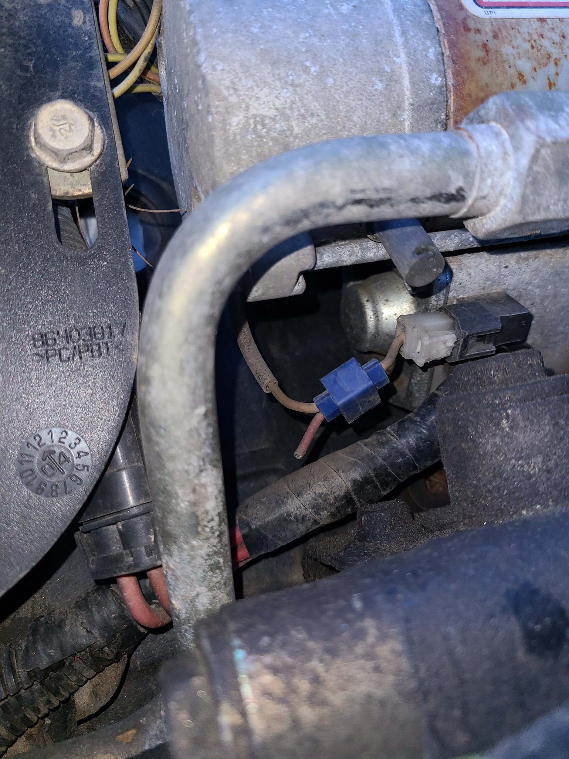

Hi thanks for the help, I actually have one of these switches bought awhile ago but haven't used yet, different brand.
But my question is on the starter I just see one LARGE red wire from the battery and one small red wire which I am assuming is the wire from the ignition switch to trigger the solenoid is that correct? Attached is pics of my starter, appears the prior owner has hacked something on that small red wire at one point.
   / TC35DA Wont start help #15
You guys have it scoped out exactly right--simply introduce 12 volts from the battery to the smaller red wire on the starter solenoid. This can be done with a small (12-14 gauge) jumper with alligator clips on each end.
What was not mentioned is VERY important--MAKE SURE YOU ARE IN NUETRAL!!!!

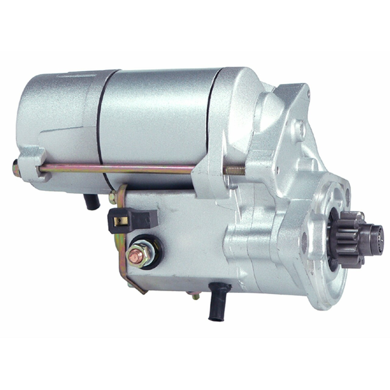

   / TC35DA Wont start help #16
I can't really tell from those pics, I would expect 3 terminals on the starter solenoid.
One from the battery cable to the solenoid,
then a small one from the tractors wiring harness to the solenoid,
and a third going into the starter body.
A remote switch would go from the battery cable terminal to the smaller one from the tractor harness.
If this is similar to your starter,
yes the remote starter would go from the battery connection to the small tab above it.
Likely were the previous owned tapped into it.

The second pic you shared looks like what I can see from my starter.
So I will give that a go, applying power to the small red wire to get it started.
Thank you all!
