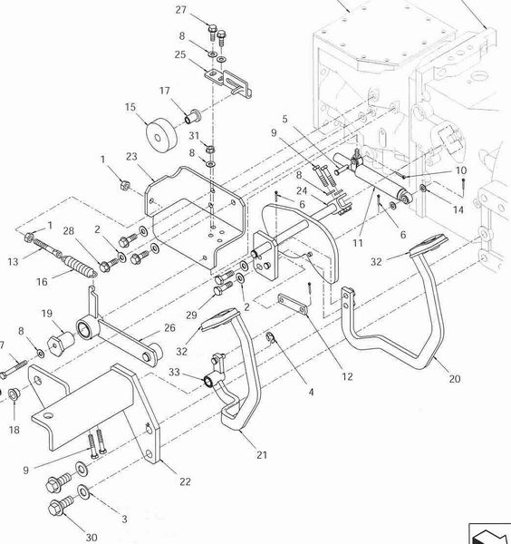

new holland tc35d
how can i adjust the creep on my tractor
/ tc35d #2
do you mean that its creeping when both pedals are up, assuming its HST? Or is it something else you're referring to?
/ tc35d #3
Look up under your right side operator's platform. The attachment is an exploded view of your HST pedals. Look at part #19 and part #7. Part #7 is a locking bolt. Loosen it a bit and then rotate the big eccentric nut assy just slightly to adjust for pedal zero position with no creep.
