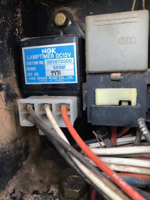

Recently the last couple months, my '03 TC35D (1400 hrs) when driving along sometimes cuts out (but never shuts off) and most recently when after mowing for 2 hours or so, and I shut it off, it won't start. I did some digging and trace back on the wires. When I run a hot jumper to the starter solenoid (white wire), it starts every time. So, I pulled the "spade" off the solenoid and checked the voltage when I turned the key to start it. It would fluctuate at 7, 5, 8, 3 volts..., very erratic. So, I traced the white wire that attaches to the solenoid on the starter and it goes to a 12v timer apparatus that has multiple functions, one of which is the glow plug activation, as well as the wire to the starter. If I don't have the 12 volts on the white wire when I try to start the tractor, guessing I need a new "timer apparatus", or is there something upstream that I should look at. I took the back off of the timer and saw a small computer board with capacitors, rheostats, transistors, and lots of solder joints. I couldn't tell the any joints had cracked, but since it occurs when it warms, guessing something may "open" when it shouldn't. Does that make sense, and logical trouble shooting? I'll contact the dealer to see if that is the appropriate part I should be looking at..... any thoughts appreciated.

The dealer will be happy to sell you a new one, no doubt. Will that solve the problem? Possibly, but who knows?
Depending on the price of that little jewel you might want to consider adding another power source to the wire going to the starter. Something like a simple push button supplying full battery voltage to engage the starter when the little black box won't do it.

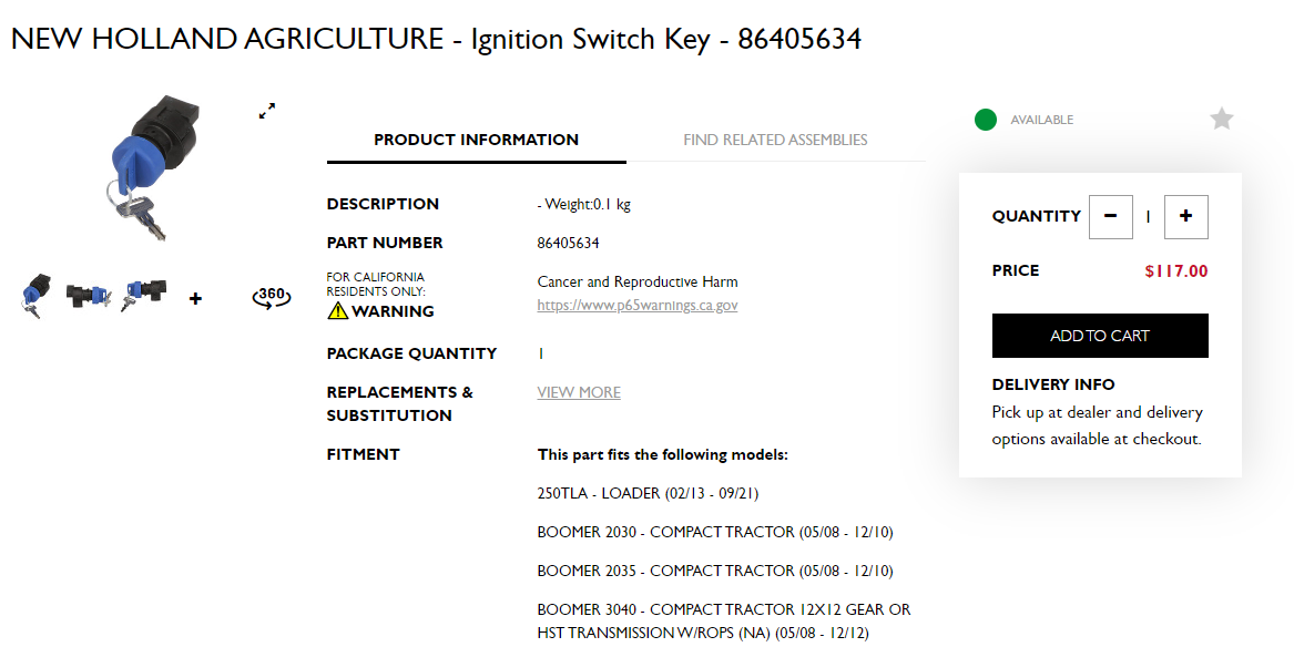

Could be the starter switch is getting hot causing voltage fluctuations. Probably the cheapest part to start with.
/ TC35D cuts out or won't start after getting hot
I did order the glow plug timer, since it has multiple functions and is one device responsible for getting the voltage to the starter solenoid. The part number for it is SBA385870301. Randy, curious if you know the "starter switch" part number you referenced? (In case the glow plug timer doesn't solve the issue.)

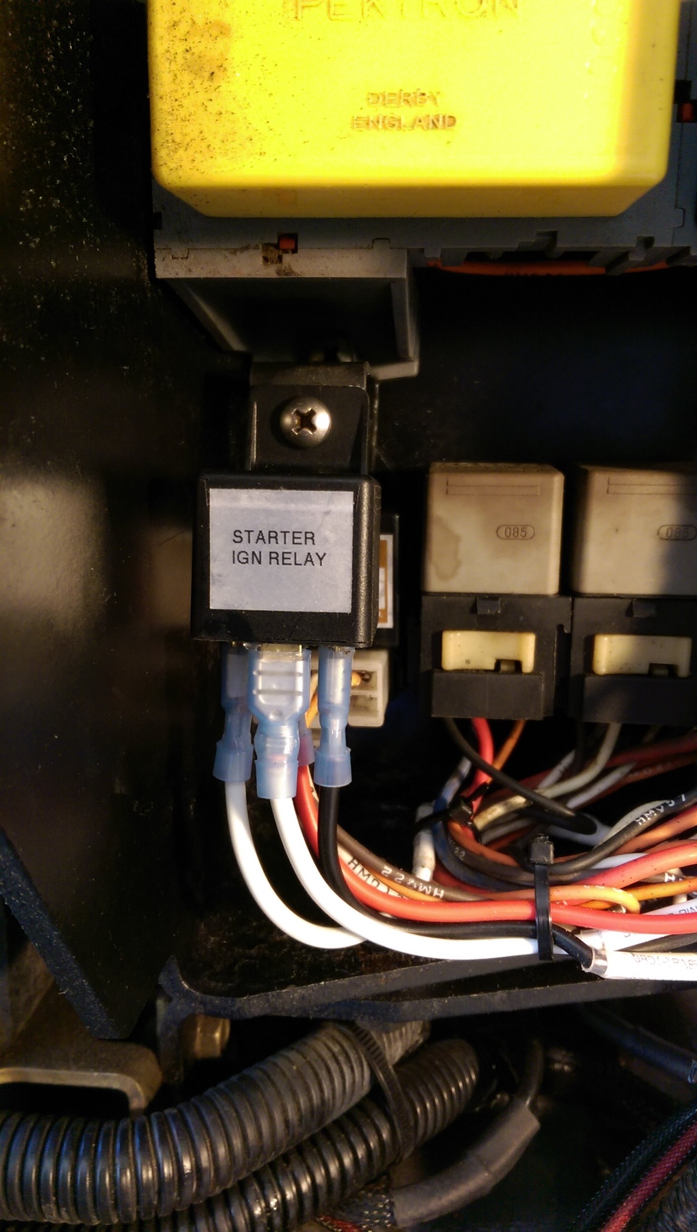

@srodster - So before you put the new Glow Pug Timer in I would check a few things... (I personally hate throwing parts at something to see if it works... rabbit holing gets expensive with tractor parts...)
First thing:
When you turn the key to the run position (not start / crank) does the glow plug light come on & then go off after a 4-6 secs? If so the timer is probably working correctly
You are correct that it is very erratic & I can tell you that the tractor will not turn over unless it is getting 12V. This is not that uncommon on the NH TC series & kind of a known issue... (more on this in a min)
You already troubleshot part of it but proving it will crank & start when you put 12V directly to it; which means all safety switches are most likely working, so I would look at 2 different things prior to replacing the glow plug timer.
1st: I would test your battery cables, even if they look great, they are known to corrode internally on these NH's & cause a lot of resistance on electrical circuit, This may be one of the issues in regards to your statement:
2nd: As nyone said... I would definitely look at doing the Starter Relay Modification. That starter circuit is known for causing that exact "erratic" voltage problem overtime on the TC's. There is no downside to doing the mod; only positive results & very well could completely resolve your issue. (I would do the Mod either way).
Both the Battery Cable Testing & the Starter Mod procedures are well documented on TBN (I know I (& others) have posted them both multiple times... but if you need them let me know. (this is already a long post... lol)
Hope this Helps
Here is a pic of where I installed ours on the TC40D:

I think this because the problem began while hot. You also said it would "cut out" without shutting off. I guess you mean the engine is missing occasionally? The starter relay mod won't address that. And a short is the one thing I can think of that addresses the missing and the no-start, especially while hot. Along those lines, it could certainly be a shorted or malfunctioning key switch (as noted above). Others threads have said that the OEM switches aren't great. I already replaced mine with a NAPA part.

Thanks to everyone for their comments. I believe the issue has been solved w/ the new glow plug timer apparatus, since it has multiple functions besides the glow plugs. The white wire in my original message on the glow plug timer goes directly to the starter. So, I received the new timer, and put it on. I measured the voltage on the white wire where it clips onto the starter and I get 10 to 11 volts, much more consistent than with the old part. I realize I should have a solid 12v and maybe I do, but the resistance in my alligator clip connections to my meter could be why it's not a sold 12v.
I'll attach a couple photos of the timer, and you can see it has a few capacitors and some resistors, and a whole lot of solder joints at the board. So, since this only occurs when it gets hot, I'm guessing one of the solder joints opens up or has a crack preventing it from starting.
I have run the tractor now for about 3 days, and a couple hours each day. Weather has been in upper 90's, and heat index over 100F, so I know it's getting hot enough. Thus far, it has started up each time after being shut off. We'll see how she goes with more time.
