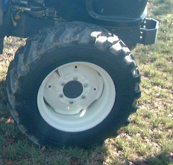

I took a real good look at them tonight when I got home. The outer part of the lugs has alot of meat left but the centers only have about 3/8" left on them. These tires have about 1130 hours on them. I use 4wd most of the time as there is lots of mud here now. 2wd is useless with no weight on the rear when using the loader.
All in all I think they have some life left in them but for $125 each it may be worth picking them up now for later.

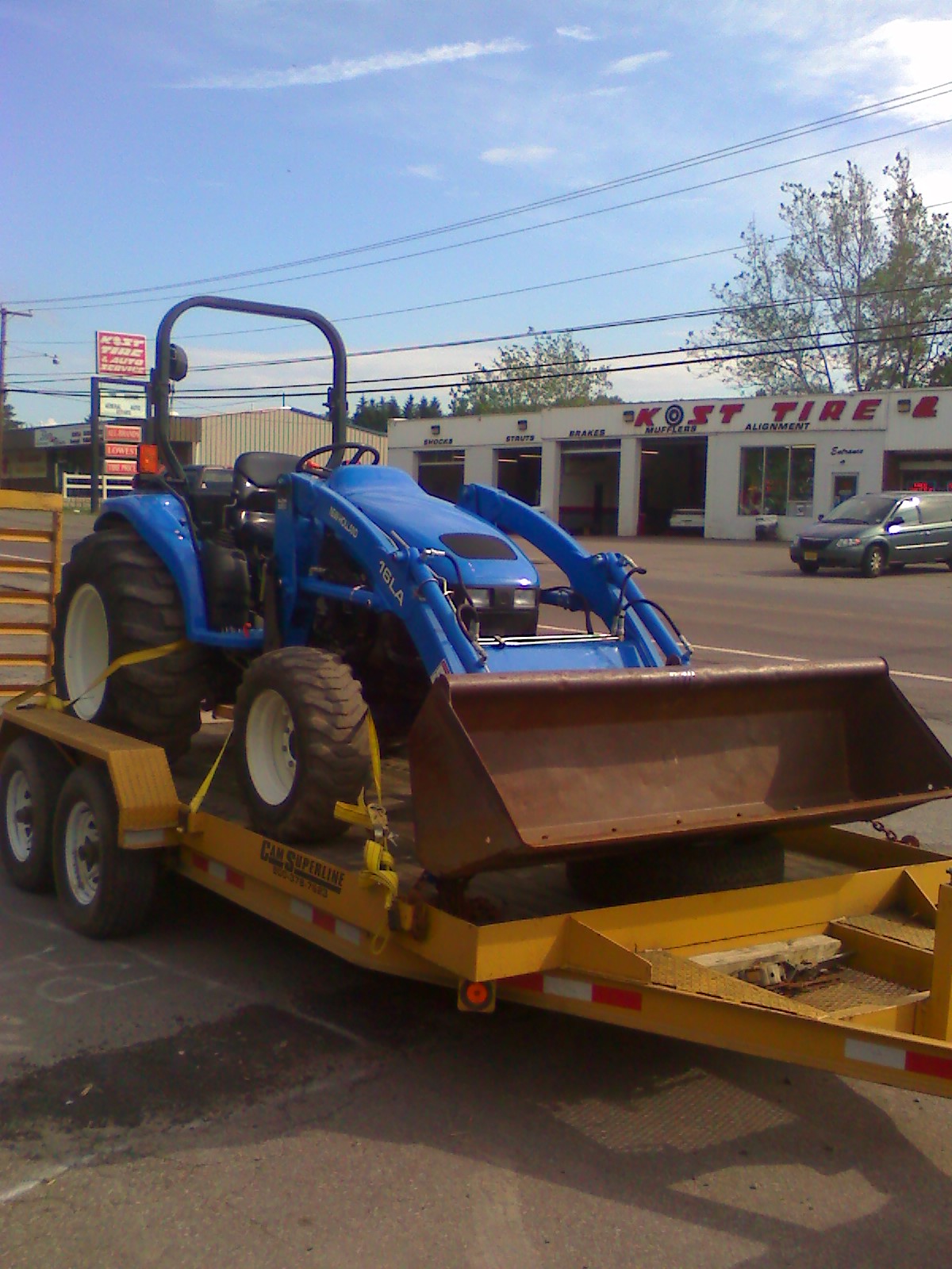

I didn't get a chance to take a pic as I was running it until dark. I have this picture that I took the day I picked it up.

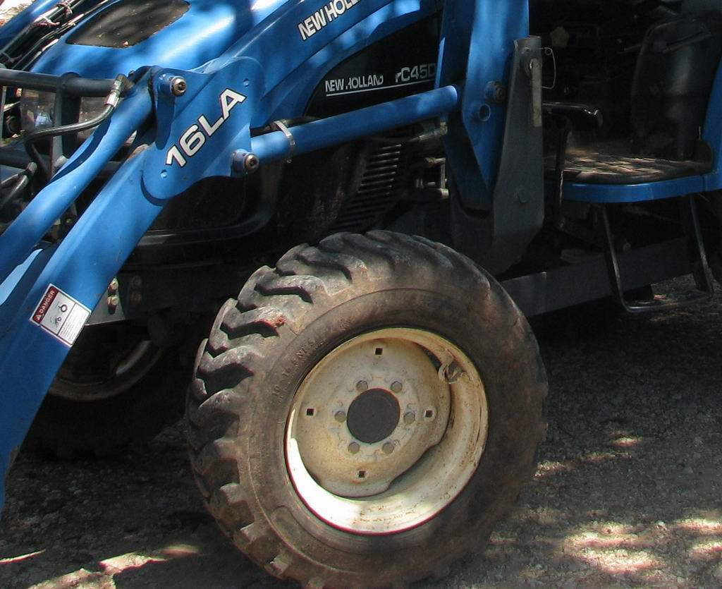

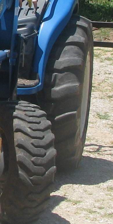

The first two photos are of my left front tire now. The second two photos are of my right-front tire at delivery in February 2001. I don't see that much difference in my tires or yours. Industrials have a thin cleat in the middle for hard surfaces and a thicker cleat on the sides with a flat rolling surface.
