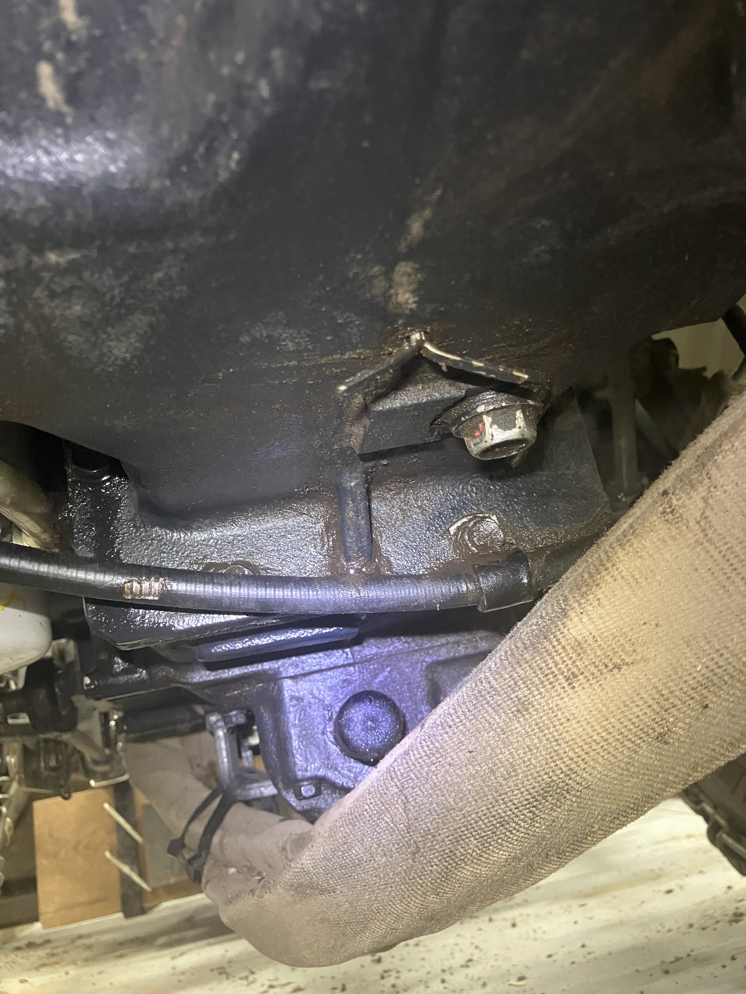

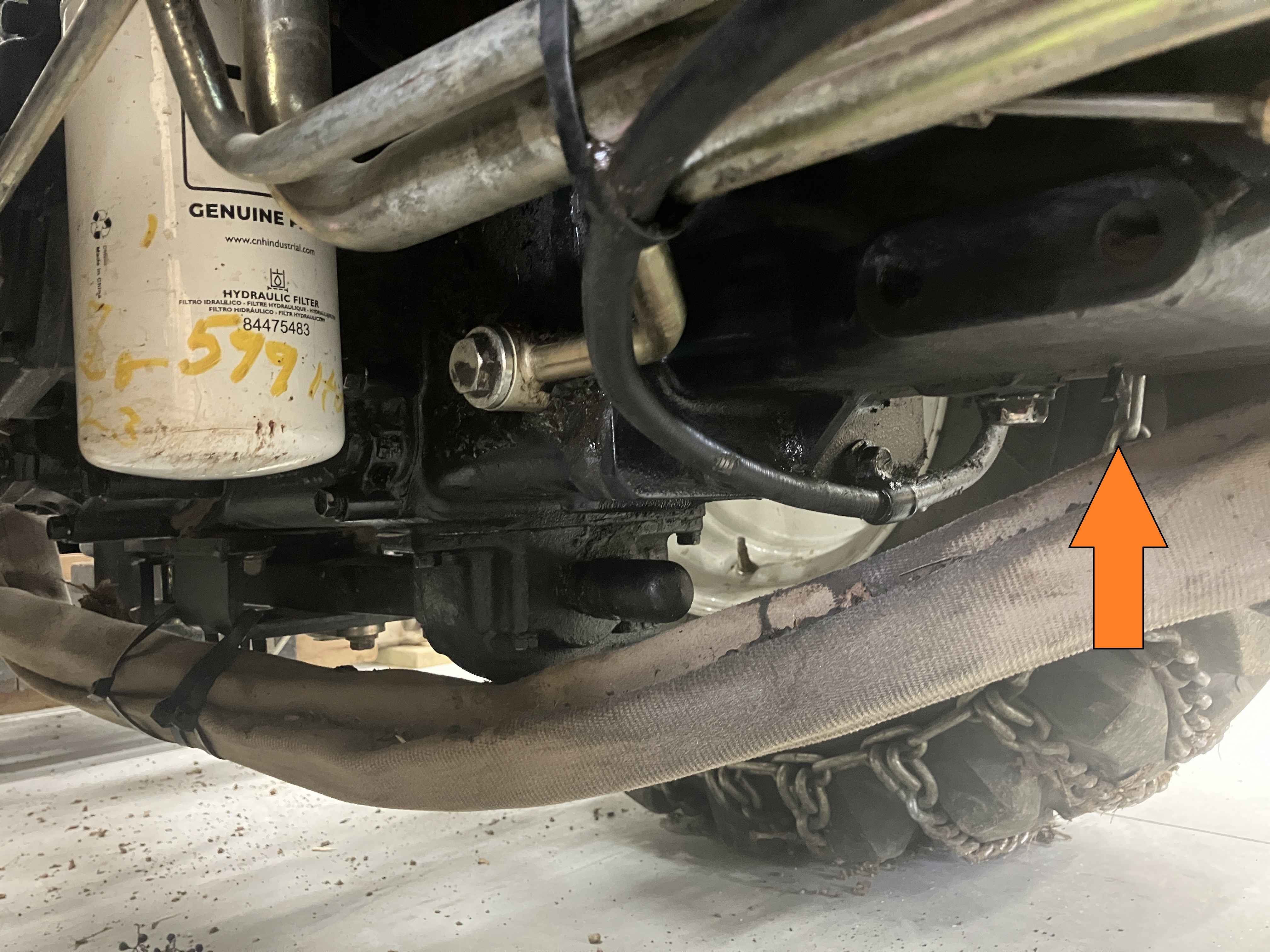

Apr 7, 2025 / TC33DA - what is the purpose of this cotter pin? #1 adlertom Silver Member Joined Aug 17, 2004 Messages 197 Location Southern Wisconsin Tractor New Holland TC33DA hydro w/supersteer On the underside of my TC33DA, there's what looks like a cotter pin sticking out. Photo attached. What is it's purpose? Attachments a.jpg 5.6 MB · Views: 166 c.jpg 6.1 MB · Views: 156
Apr 7, 2025 / TC33DA - what is the purpose of this cotter pin? #2 T TractorTech Elite Member Joined Jan 26, 2012 Messages 3,020 Location California Tractor Ford 7710, Ford 550, Ford 1910, Ford 4430, KD Forklift, Ford LGT17H, New Holland L255 Skidsteer Cotter pins in bell housings keep the drain hole in the housing from gumming up with oil and debris.

Apr 8, 2025 / TC33DA - what is the purpose of this cotter pin? #4 N nyone Elite Member Joined Jan 31, 2012 Messages 2,555 Tractor Ford 851 TractorTech said: Cotter pins in bell housings keep the drain hole in the housing from gumming up with oil and debris. Click to expand... This Prety standard practice in more than just tractors.
