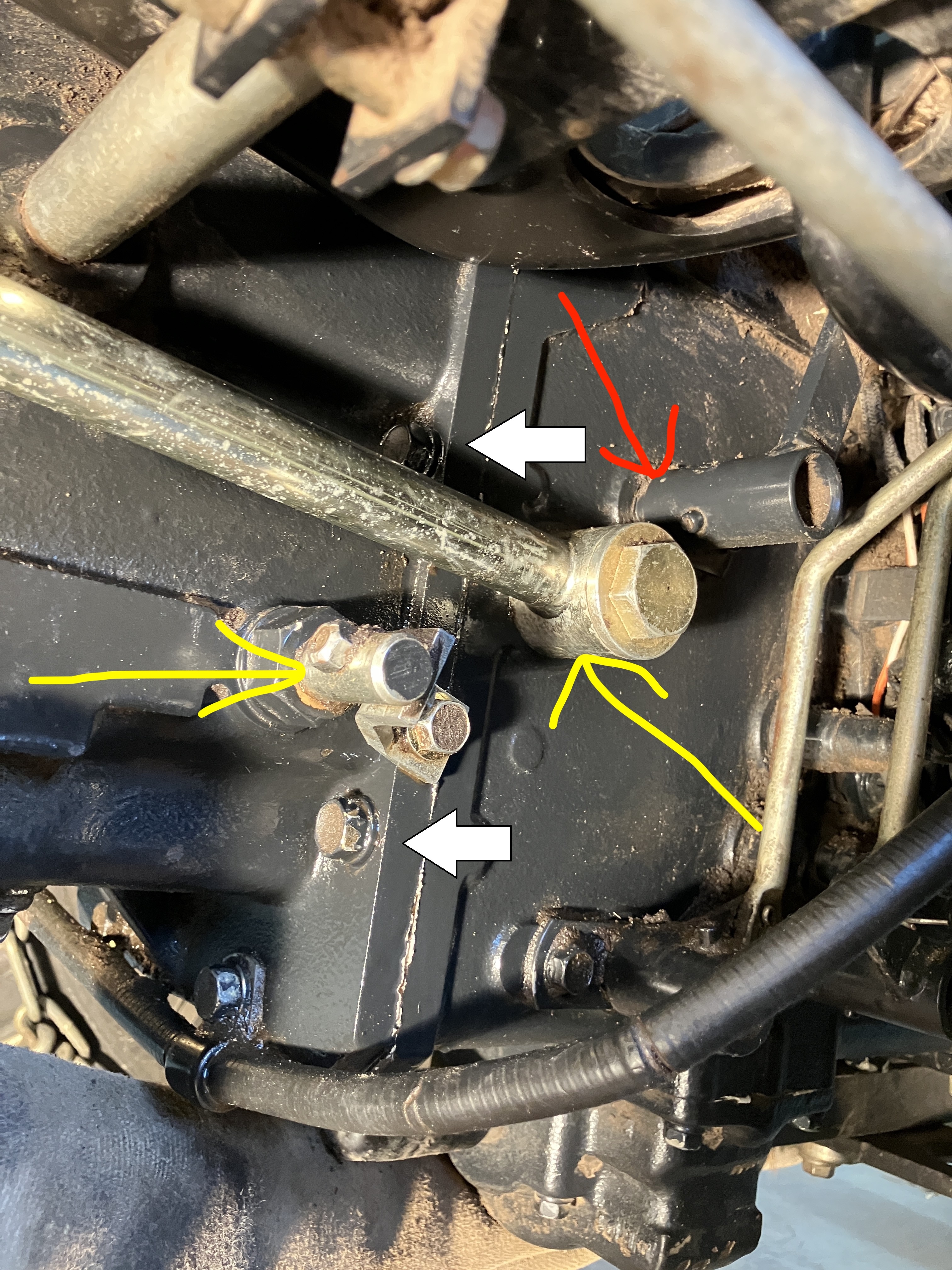

I think my hydraulic fluid seepage is coming from under the heads of one or both of these bolts. The bolts themselves are tight.
Thinking about removing the bolts, and applying some thread lock, and/or a rubber washer under the head, to see if that stops it.

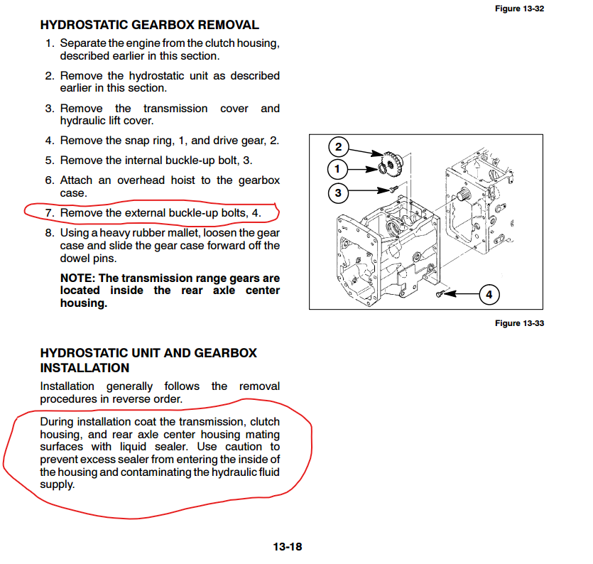

If the leak is coming from the joint between the front and rear transmission cases, the tractor will likely have to be split to re-seal. Putting a rubber washer on any of the bolts that fasten the two case sections together would ultimately reduce the clamping force induced by the bolt due to compressibility of the rubber. I would think you would be risking damage to the cases if all the bolts are not maintained at the proper tightness. If the leak is from around a bolt, you might try removing and packing rtv around it to see if you can seal it, but without a rubber seal. I do not know those are blind holes or not.
Before splitting, I would also verify that the leak is not coming from one of the areas marked below in your photo,
The righthand yellow arrow points to the banjo fitting where the return line from the hydrostat (I think) attaches to the transmission case. This should be an easy 2 O-ring replacement by removing the banjo bolt. The left arrow points to something that I don’t know what it is for unless this tractor is 2wd, because I think that some other models have the fwd engagement lever there and the photo shows no lever attached) and I believe there is be an 0-ring inside that guide bushing to seal around the shaft. There also a sealing washer behind the guide bushing. I think the O-ring and sealing washer can be replaced without splitting, at least I am hoping that because that O-ring started to seep oil this past winter on my 1520. I will probably remove the transmission top cover plate while I try removing that bushing with hopes that the shaft does not get disturbed while doing so. Removing the top cover should allow access to the inside of the shaft, if gears are not in the way.
The red arrow points to the speed range selection lever rod. Diagrams make it look like the rod needs to be removed from the inside to replace an O-ring on rod. Not sure what it entails to get that rod out. I do not believe you can get to it from the top cover plate as the top cover plate covers only the front transmission case and that rod is into the rear case, I think.

Thank you for your thorough reply.
Good point on not putting a rubber washer underneath the bolt heads. I see how that would reduce the torque on those bolts and possibly be problematic.
I was looking at a product called Loctite 545 that sounds promising. Maybe I could put a little bit of that on the bolt threads.
The leak doesn't seem to be coming from the banjo bolt.
I also don't know what that other protrusion you pointed out, with the shaft and bracket, is for. The tractor is 4WD. However, the leak doesn't seem to be coming from that either.

Thank you. Instead of the fender, could you tell me the bolt size and specification for the bolts shown in this picture?
In addition to adding Loctite 545 to the treads, I may try replacing the bolts, but would like to order them and have them on hand before removing the existing bolts.
I realize this isn't the best/proper way to correct the seepage, but I really don't want to split the tractor.

Thanks to everyone for the assistance. I think this is the correct bolt:bolt specification hydraulic fluid seepage.jpg
