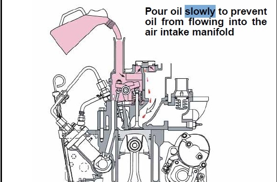

I would like to change the engine oil in my TC33DA with a Shibaura N843 3 cylinder diesel engine.
I've read that when adding the new oil, it should be added slowly to avoid engine damage. Apparently if added to quickly, the oil can find its way into the intake manifold.
So, this makes me a bit worried. About how slow do I need to add the oil? How fast is "too fast"?

Is there a breather tube that goes from the valve cover to intake? If yes then it might be possible to get oil into intake if it is lower than valve cover fill point.

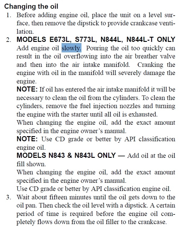

Excerpts/photos attached from the Shibaura engine manual.
So, it looks like the issue may be for other Shibaura engines, not specifically the N843 that my TC33DA has?
Thanks to @dieselscout80 for sharing his experience with pouring in a quart over about 1 minute. This is the type of data/guidance I'm looking for.
