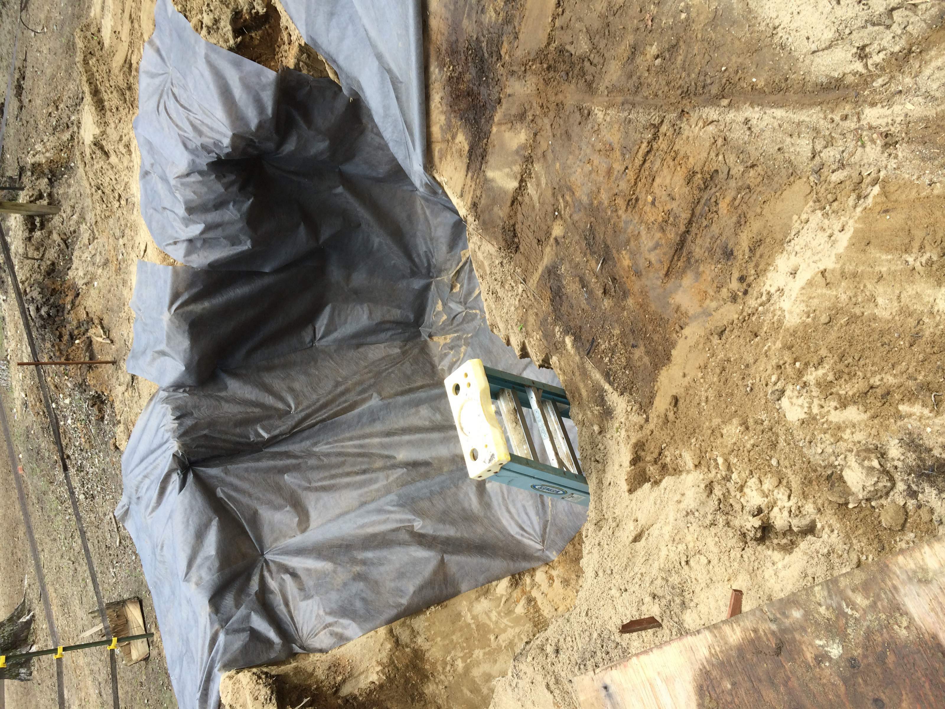

Dave I have done a good bit of digging with it since we got it in march. I have put about 300 hours on it a good bit of them digging with the hoe. I dug a 12' x14'x10' deep hole with it no problem about a month and a half ago was digging last week with it an the same type of dirt and it had a hard time breaking through and scooping. I have to bring both the boom and dipper in at the same time if I have a bucket full just to get it out of the hole. The other reason is I have full 9' oak logs that I have picked up and moved with this and tried moving one on to my stand to cut into boards and the hoe wouldn't even lift it.
   / Tc33d with 758c (6/00) hydraulic issues
Here is the start of the hole that was dug. That is a ten foot step ladder in the hole.
