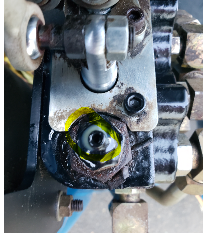

My valve is leaking around the piece that is circled in yellow. Any ideas what the fix is?

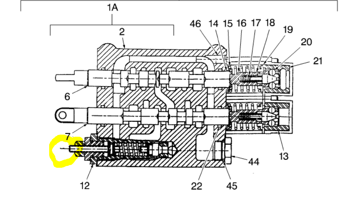

That is pn 86400130 Relief Cartridge looking at a parts book for 1999 tc33d w/7308 loader. If it looks like a set screw, it is probably where the relief pressure can be adjusted. I'm wondering if a packing can be tightened down a bit to stop the seeping around the screw?
