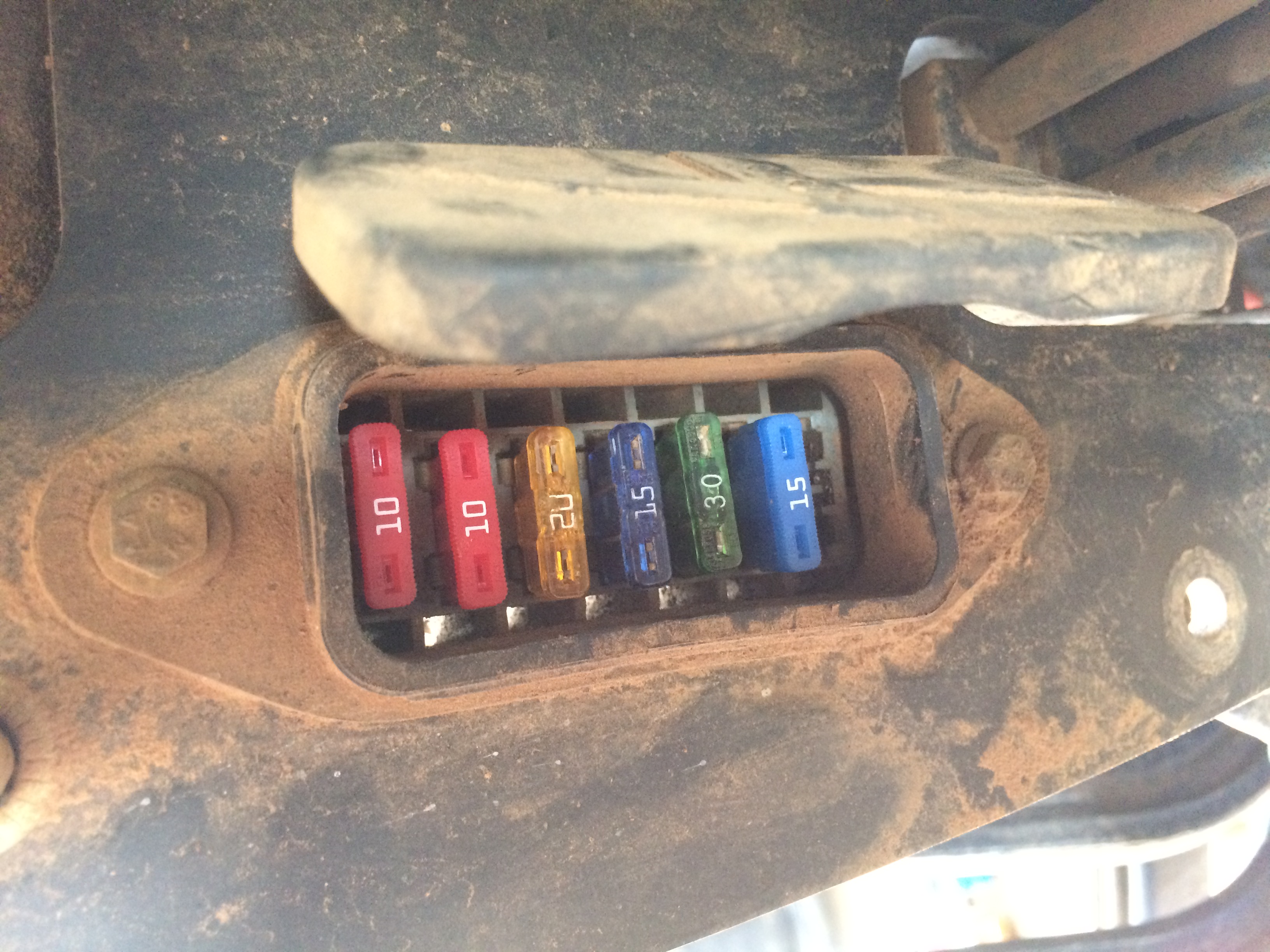

I purchased a used 2004 TC33D and it had the same switch issue as described in the sticky thread. The flasher module had to be replaced and I used repair manual for guidance. I also checked fuses and discovered mine were not arranged as shown in manual (see pics). There is a 30amp fuse in what should be an open slot (see pics). When I removed this fuse - nothing...no starter engagement no turn over. When I put back in then it was the usual click click click - switch key back and forth then it cranks. I'm wondering if that 30amp fuse was the previous owners attempt to fix the switch? Any suggestions? THANKS
