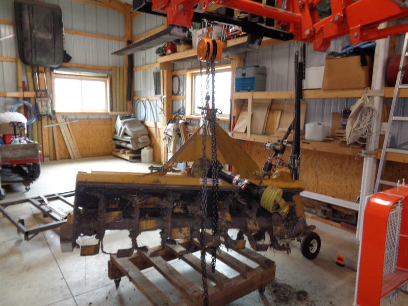

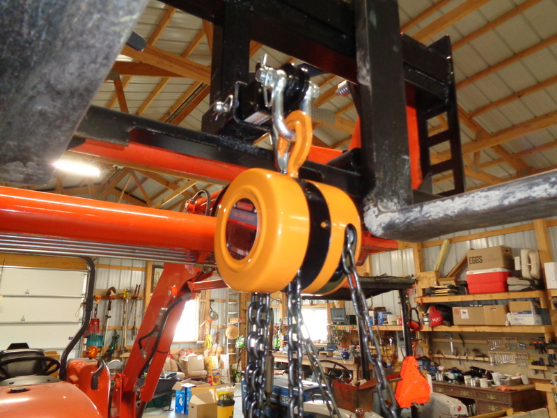

Winch is a great idea. I do have a 12 volt , one tone HF winch that I use ti lift the deer up my home made boom pole. You might want to do it today as they have %20 coupon for today. I will attache it to this posting. you might consider a beefier one if the price is good.
PS. Even better would be their 2 ton chain hoist. I bought one i think around $50 and fro the price is great. No electrical to maintain, built solid and much safer to pull with a chain rated for 4000 lbs than aviation cable and potential whiplash.

JC - I've got that chain hoist already, didn't think of that. I've been using it for lifting but it'll do for pulling too. Thanks!
