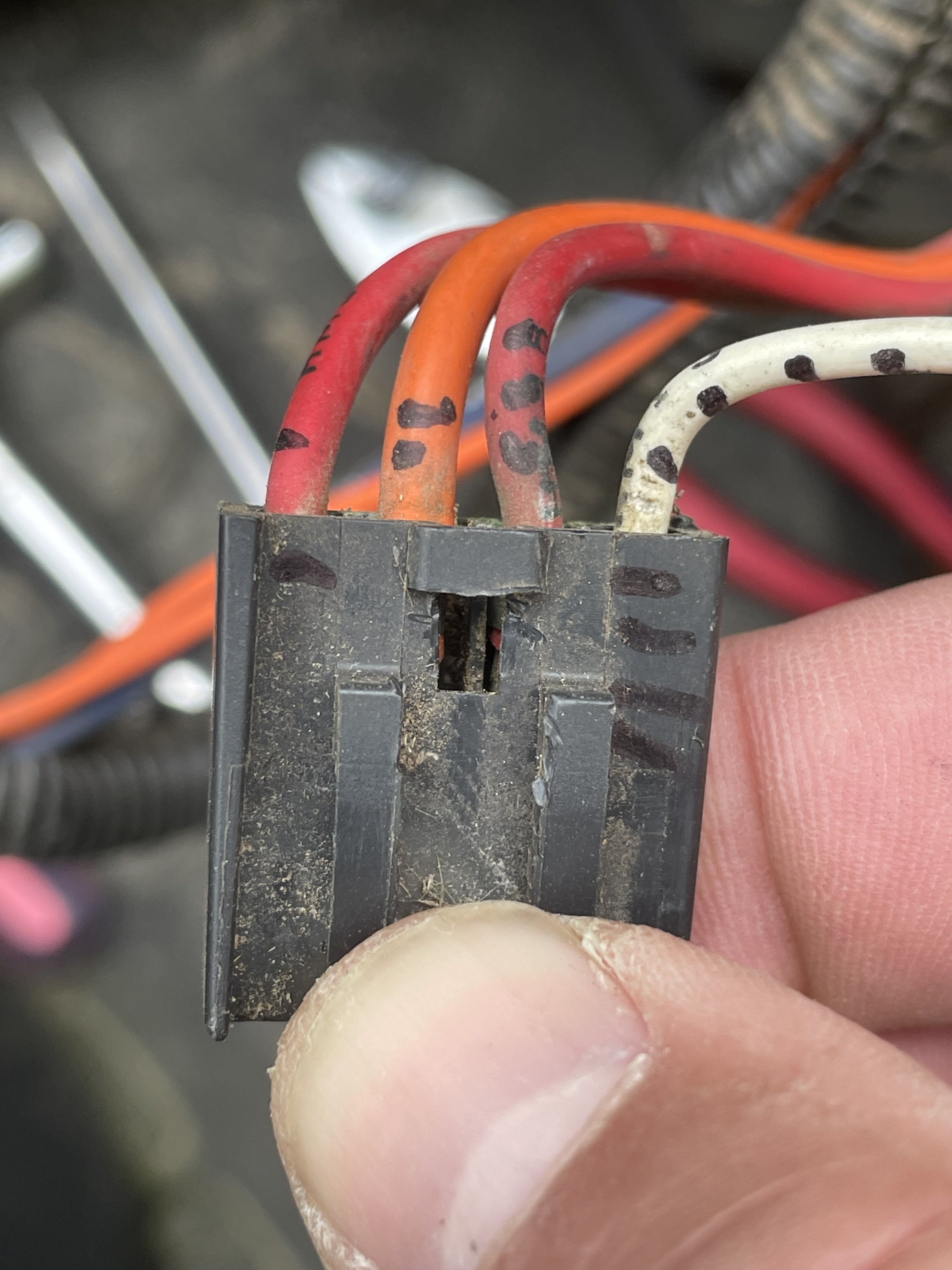

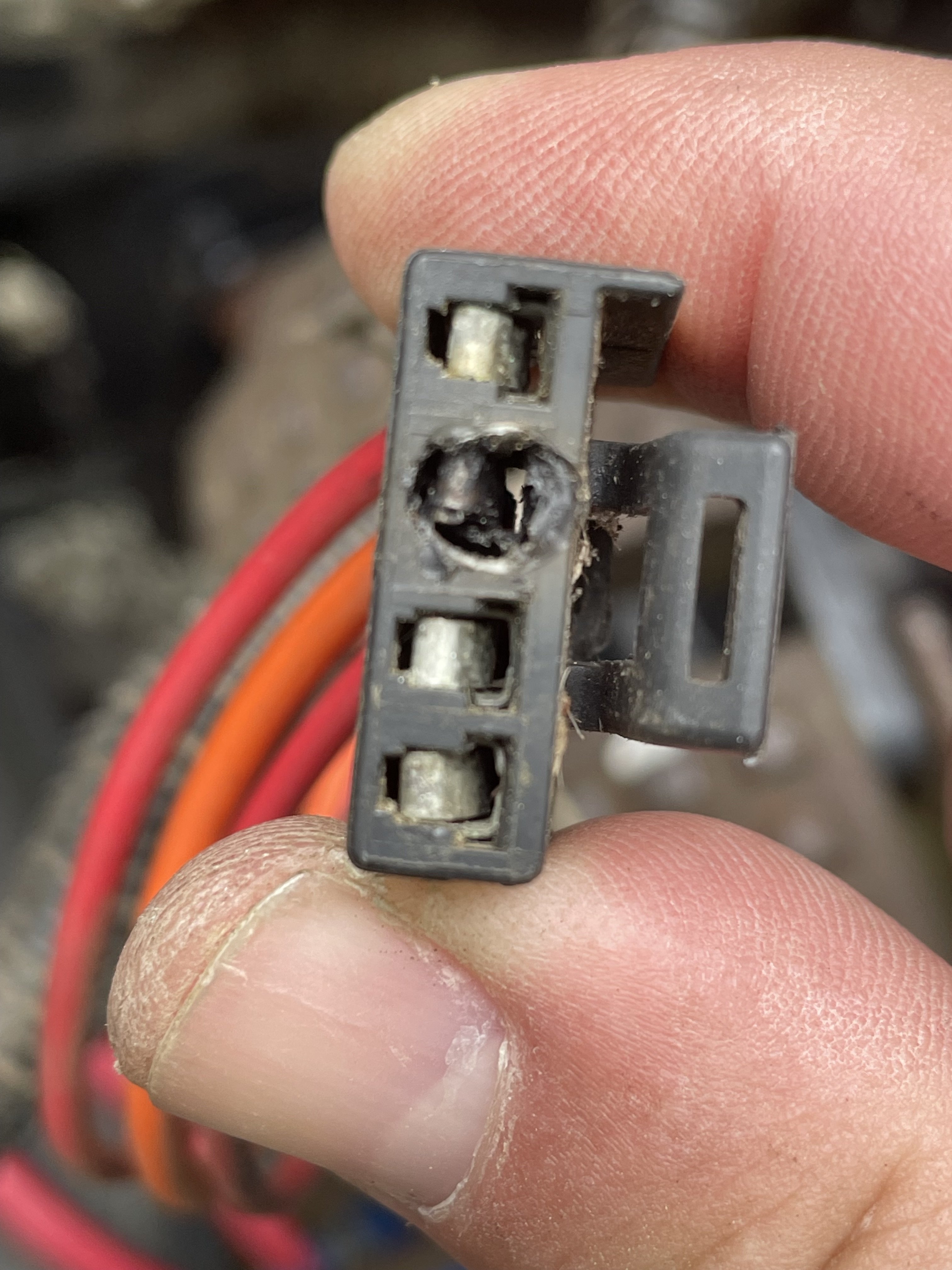

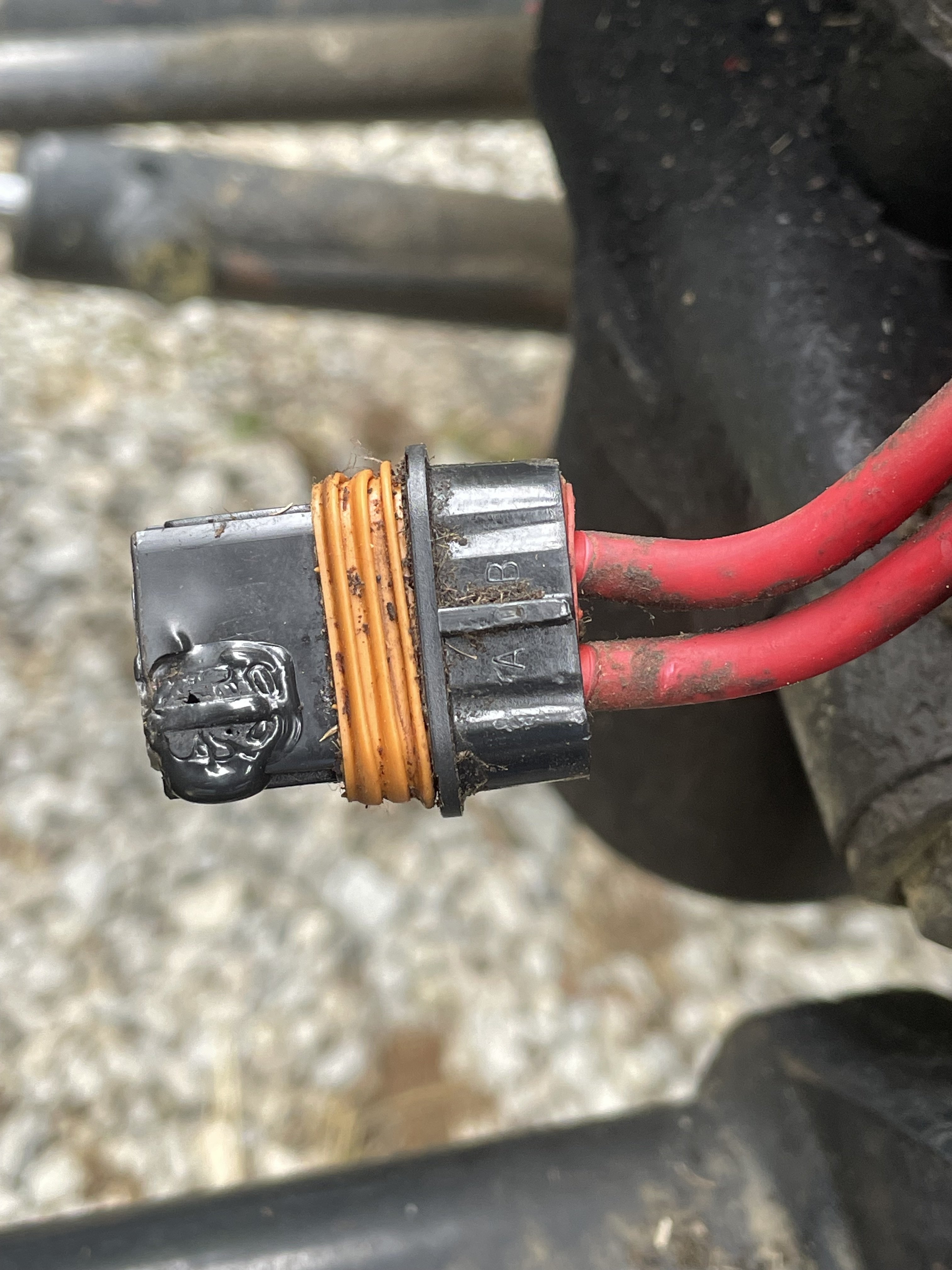

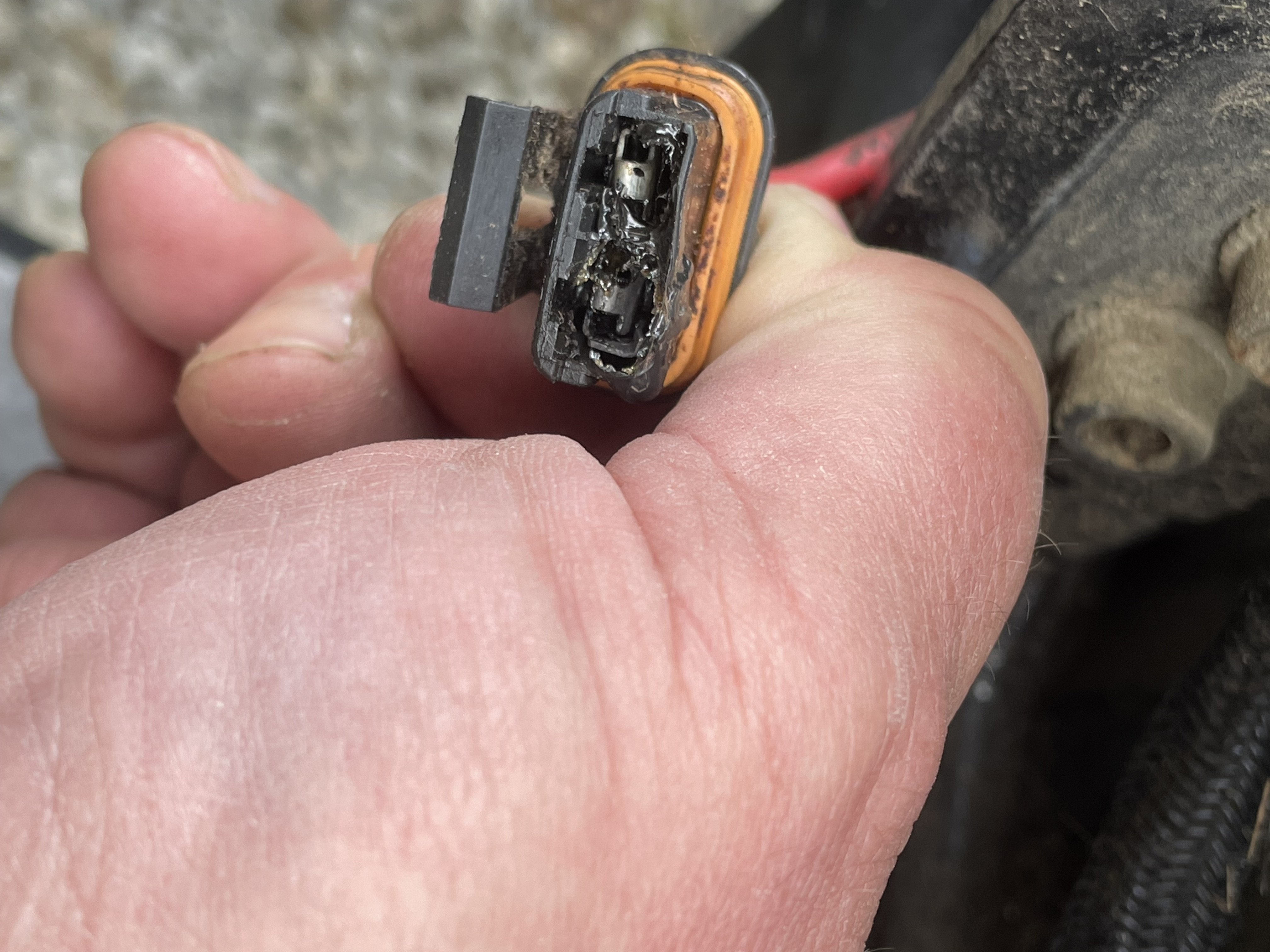

TC29DA. The 40 amp main fuse blew and melted the fuse block. Slot B of the ignition connector (12V Input terminal) also melted. The wire and wire coating are OK, but the plastic surrounding that particular wire melted. I tested the ignition switch and it passed all of the tests in the repair manual. A few months ago, the dealer replaced the starter, the battery, the water pump and a few other things, but I have put less than 10 hours on it (over 2 - 4 days of use a week or two ago) since the repairs. I can't afford the time or the money to have the dealer repair this again.*
Behavior before fuse blew:
I started the tractor last night and when I held the key in the glow plug position, the glow plug did not go out after the normal interval. I held it for several seconds to see if it would go out. It did not. I then started the tractor and the glow plug light went out and the tractor ran fine. I took a load of heavy trash to the end of the drive, set the parking brake and set the gear selector in neutral (the PTO was not engaged). The tractor was running fine as I was unloading the trash. I had the high beams on and I had the hazards on. Then it just died, but it wasn't just the engine that died: all the lights died too (I know, consistent with the main fuse blowing).
Questions:
A) Any ideas on what might have caused the fuse to blow, or what I should check next?
B) I assume I will have to splice in a 40 amp fuse block into the wiring harness? Please correct me if I'm wrong (the wires go into the harness and I can't tell where they go from there - I mean I think the wiring diagram shows 1 end going to a junction with the battery, the starter solenoid, and the alternator, but I don't have experience with wiring diagrams and looking at a diagram is very different from looking at the physical wires. Also the wires into the fuse block are very large, but I don't see other large wires). Where can I get a replacement fuse block?
C) Where can I get a replacement connector for the ignition switch?
*1) It is blocking my driveway, 2) The front end loader is in the down position, so I don't even know how they would load it on the truck, and 3) We are in the process of moving which makes for all sorts of other complications

You can try jacking up the loader then blocking or securing it in some manner in that position. It could weigh 600 pounds or more. You may be able to block the linkage in the up position or secure with tie down straps. The electrical is unlikely to be the lights and flashers running. Overcurrent there should simply have blown the fuse. This may be connected to your glow plug issue or not. I'd look for worn insulation on a wire next to the tractor frame somewhere. There could have been mice at work.

You have a dead short to ground first off and secondly, replace the 'Molex' connector yourself. Dell Electronics sells them and so does Digikey and they are on Amascon as well. Your picture of the connector shows it to be filthy inside and probably high resistance and if there isn't a dead short to ground (causing the melted Molex connector), Then replace it. Not hard at all, you need to acqire that knowledge instead of paying someone else to do it. Really easy and... When you replace it, pack it with di-electric grease as well. Hope you are actually maintaing the unit also.
