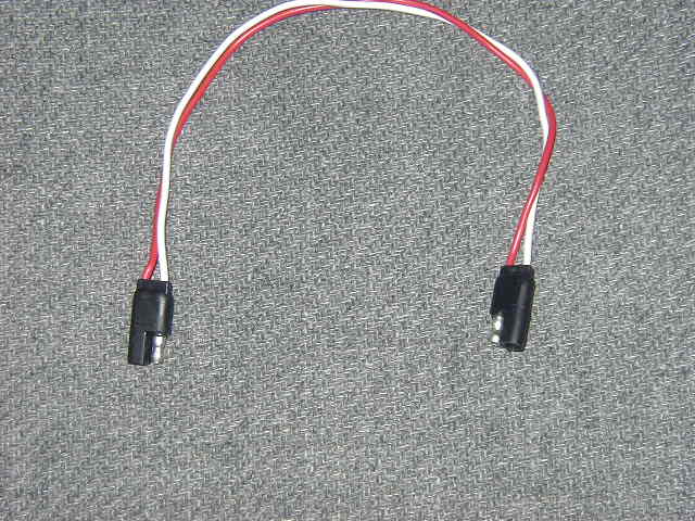

I think I found the answer for the connecting plug. Hopkins Mfg. makes "Hoppy" trailer wiring devices. In addition to the 4 pole flat connector, they also make a 2 pole version which should marry-up just right with the plug on the tractor. It comes with 24" of wire and both male & female ends. It costs $2.50 and is available from Ace Hardware online. I hope this helps!

Here is a photo (I hope!) of the 2 pole flat connector. I got it at Advanced Auto Parts for $1.89. It is 12" long You can make two 6" pigtails by cutting and crimping or you can use as is to make a 12" extension for the original plug in the wireing harness.

   / Roll Bar Wiring TC29D #17
Boomer33,
We all thank you for the effort in taking the picture and submitting it for the world to review. It is "Tractorphiles" like you that continue to make this site worth my first 20 minutes on the Net.
Thanks! /forums/images/graemlins/smile.gif
