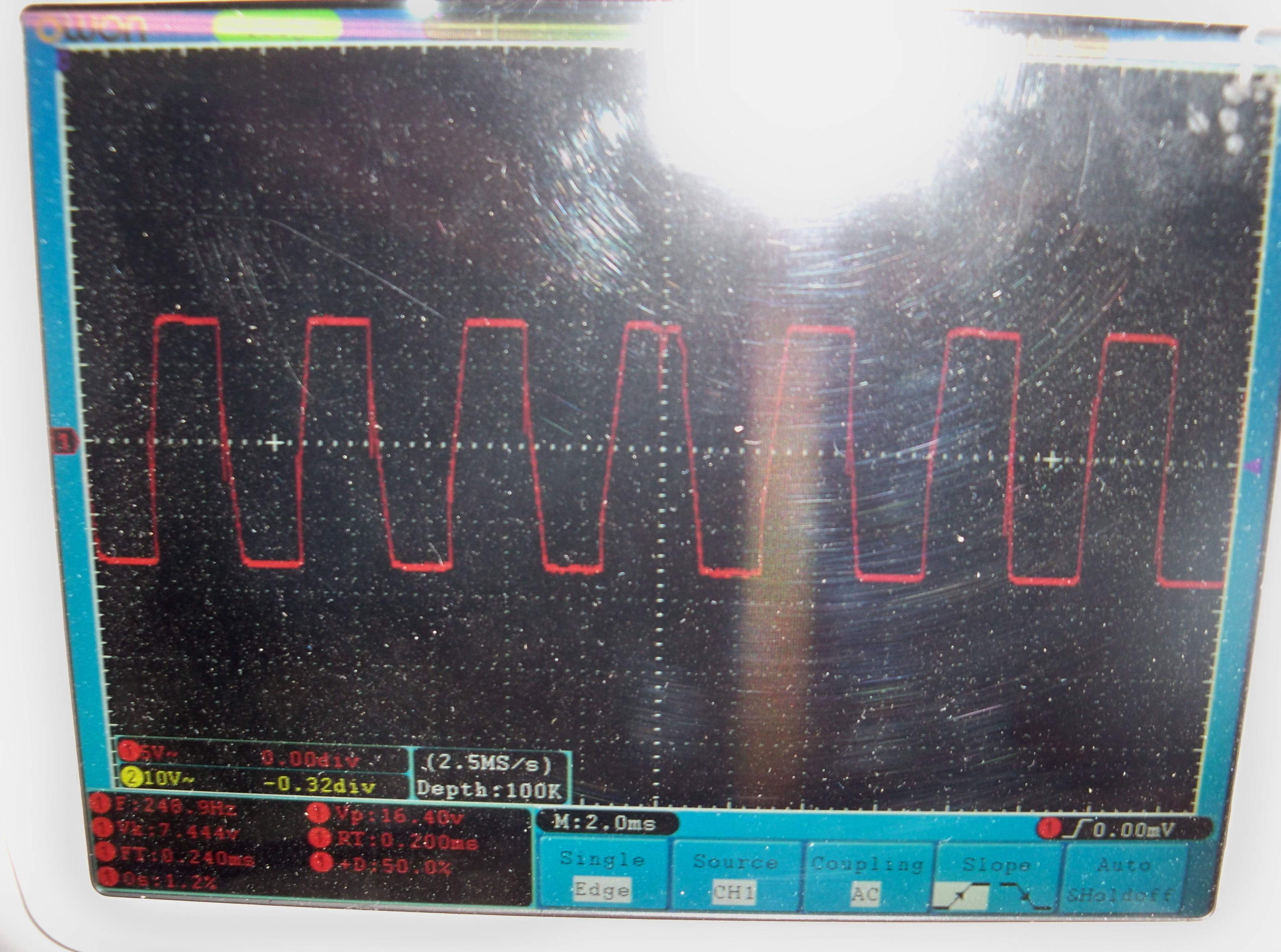

I know this post is old but I am new to the forum and also new to owning a Newholland Tc45 and the tach and the hour meter is not working. I have been searching for days now and reading many post concerning the tach and hour meter not working. I have ohm'd out the tach and the hour meter and both check good. I have checked the signal from the alternator with just a fluke meter and it reads 2.6volts on AC and 7.6 volts on DC but a lot of what I have read says I shouldn't be able to check it with a meter unless it measures frequency. Has anyone solved this problem without buying that ridiculously priced gauge cluster? any help would be greatly appreciated. Thanks Lloyd

I checked the voltage coming off the altenator when running it is putting out 14.3volts.

Everything you listed checks good 13volts to the cluster. Ground is good at .2 ohms. The pink signal wire coming from the alternator read .3 ohms. The oil pressure indicator is not lit. With the switch off. My tractor is a tc45s not the D model it doesn't have a temp gauge I've looked at the micro processor inside the cluster and it appears to be an eprom which if so I dont under stand what they would have needed a program to do in operation of the gauges. All the capacitors check good when removed from the board as well as the resistors the processor is the last thing I know it could be but before spending alot on a gauge cluster It scares me when others have had the same exact symptoms and replaced the cluster and it still doesn't work. Theres no reason for that cluster to cost so much. Thanks Lloyd

The tach signal is connected directly to one of the stator leads inside the alternator. This provides the rpm dependent AC signal for the cluster. You were not able to test this signal, but if the alternator is functioning normally there must be an AC signal present at this connection.

2.6Vac is too low. I will check my tractors tach signal as soon as I can.

Lloyd,
Below is the scope pattern from my TC40D at 1500RPM
F: 248.9Hz (1500rpm/60sec x 10) = 250hz
Vk: 7.444V (Volts rms)
Vp: 16.40V (Volts peak to peak)
2.6Vac is less than half as it should at 14.3Vdc. You should really have some one look at this with a scope.
