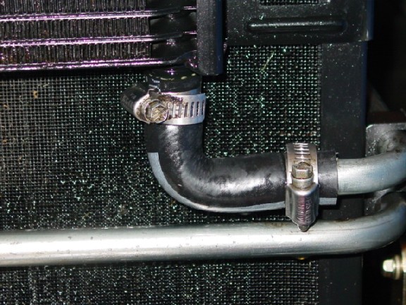

I replaced both of my hoses. I can't get them to stop leaking when the tractor is running?? There must some type of high pressure there, look at the following pictures. The first pic is with the tractor off, the second will be with the tractor on. You will see the hose blows up like a balloon.
murph

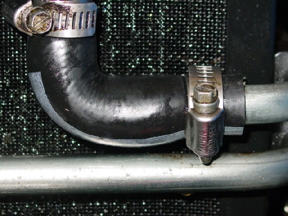

Pic #2 you will see the hose is expanded like a balloon.
murph

   / TC29D Cracked Hydraulic Line #16
I see what you're talking about. /forums/images/graemlins/confused.gif
It almost looks as if you have the wrong hose for the job. I would think that it would need to be steel reinforced if it's seeing that kind of pressure. /forums/images/graemlins/crazy.gif
It's hard to tell but it also looks like the clamps are a bit large. If the clamp is large even by a small amount it'll prevent you from sealing the hose to the tube securely enough to halt that much pressure.

Original clamps and the hose is steel reinforced. I will call my dealer tomorrow and see what he has to say.
murph

<font color="blue">I can't get them to stop leaking when the tractor is running?? </font>
I used a medium sized screw driver and turned until I could not turn any more. I think I was initially being tentative for fear of crushing the pipe. Plus, I positioned the clamps so the heads of the screws faced forward which made it much easier to tighten them with a screwdriver.
