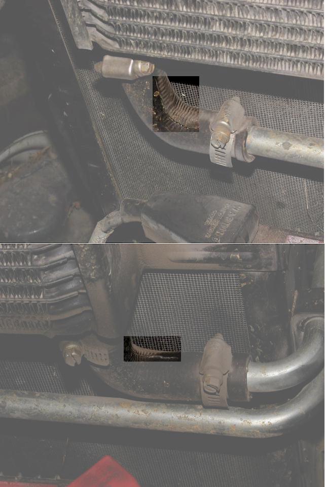

murph, too bad this didn't happen to you 24 hours earlier. /forums/images/graemlins/grin.gif I was at my dealer yesterday morning buying some maintenance items, read your post last night and checked these hoses this morning. Mine need replacing as well. /forums/images/graemlins/frown.gif
Here's a picture of both hoses. In the highlighted part, you can just see a split that runs from one hose clamp, almost to the other clamp. This split really opens up when the tractor is running. /forums/images/graemlins/shocked.gif So, my TC25D is parked until tomorrow when I can make another 50 mile round trip to the dealer.

</font><font color="blue" class="small">( Here's a picture of both hoses. In the highlighted part, you can just see a split that runs from one hose clamp, almost to the other clamp. )</font>
You see! The price of admission to this forum was just paid! /forums/images/graemlins/smile.gif

I made the trip to the dealer after calling to be sure they had the hoses in stock. They had three /forums/images/graemlins/confused.gif, which I found a bit odd since the tractor needs 2 of them. So, I bought all three ($6.19 each) and new hose clamps ($0.75 each). I just finished installing them.
I placed cardboard behind the cooler and down across the battery then formed it so the fluid would run across the cardboard and down into a drain pan I placed on the floor. I was surprised how much I had to tighten the clamps and also how much these new hoses swelled when I started up the tractor.
A question...the metal tubes, as well as the fittings on the oil cooler, had a rib running around the pipe where the hose slips on. Where's the proper place to put the clamp, between the rib and the end of the pipe or on the other side? Or doesn't it matter?
Did this question make sense? /forums/images/graemlins/grin.gif
   / TC29D Cracked Hydraulic Line #8
</font><font color="blue" class="small">( question...the metal tubes, as well as the fittings on the oil cooler, had a rib running around the pipe where the hose slips on. Where's the proper place to put the clamp, between the rib and the end of the pipe or on the other side? Or doesn't it matter?
)</font>
I would say 'on the other side'.
