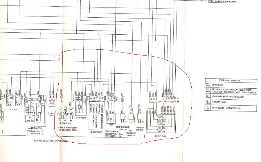

gz07g2,
Can't help with the exact schematic for your tractor but here's the one for my different brand and model tractor. The principles are the same though your wiring may be different. It should give you an idea on how your timer and relay connect to the glow plugs. You can test the glow plugs individually with a simple ohm meter. One probe to the top of the plug, the other to ground. The one you tested that blows the fuse is probably shorted to ground which would create a high current draw exceeding the fuse capacity.

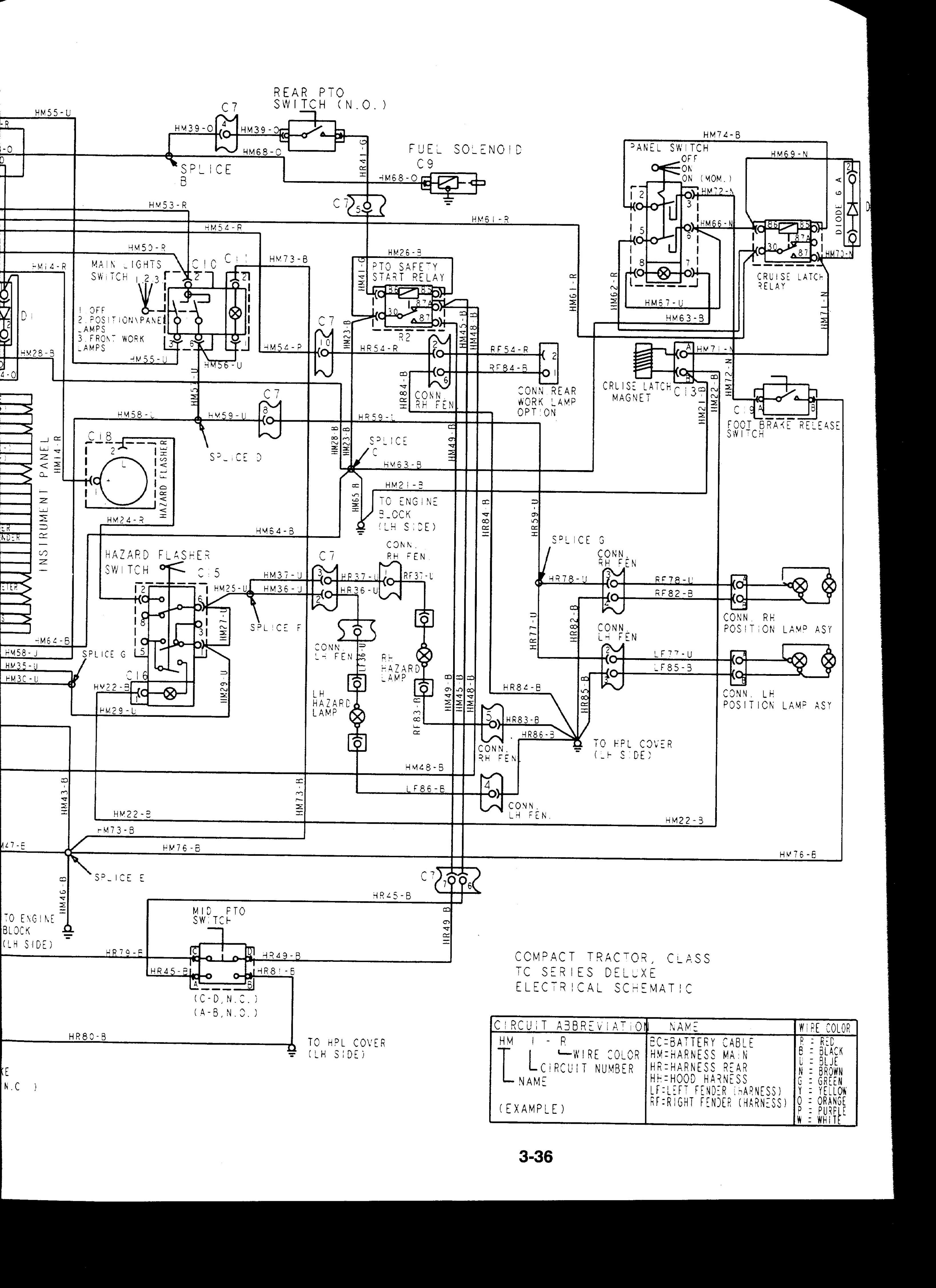

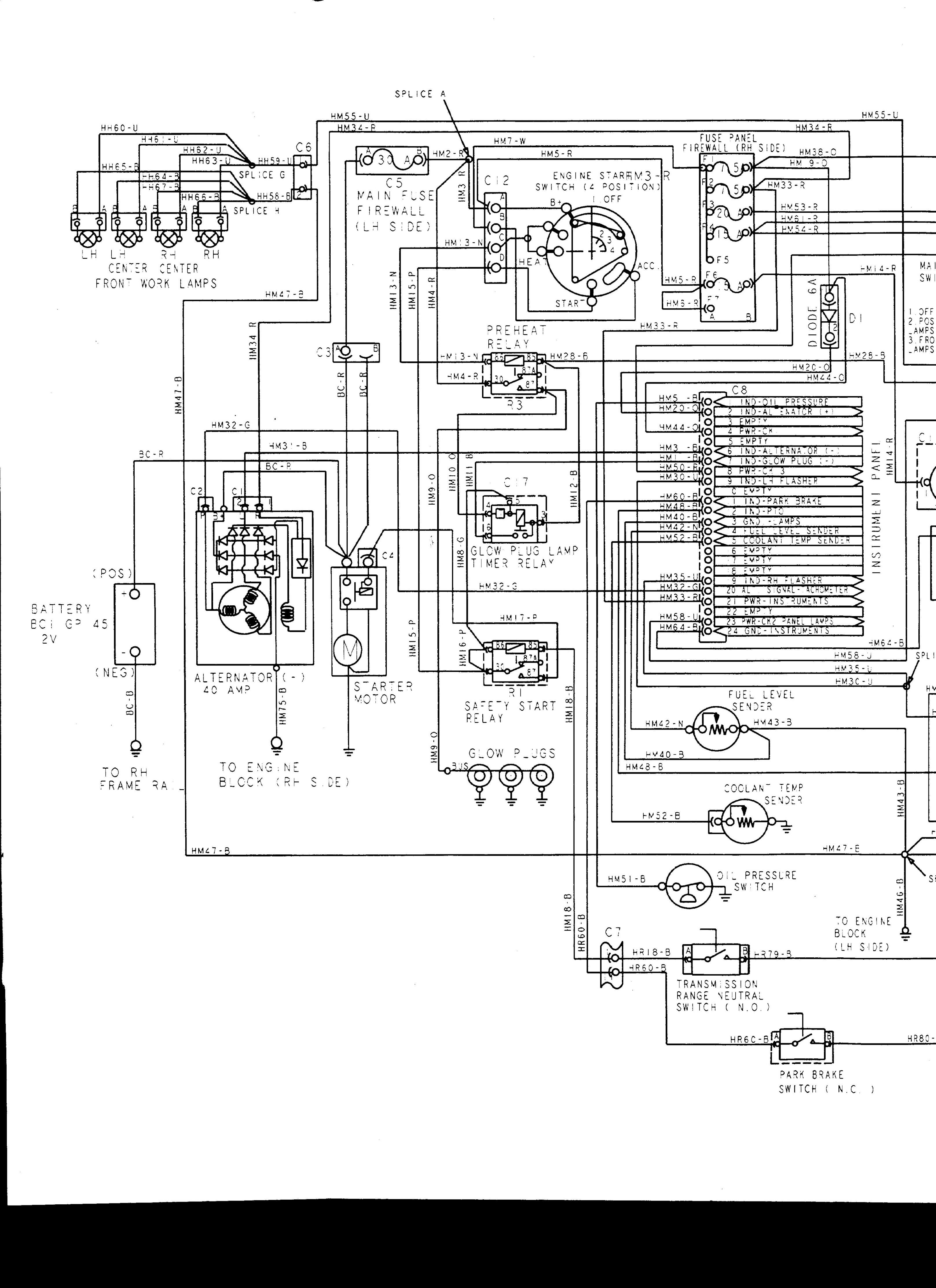

   / TC25D - Fuse #5 Blowing #10
Sorry for the delay - I've had family in town and haven't been keeping up here.
Ever since I changed my starting circuit as in the attached diagram I've had no electrical problems at all.
  • TC33DStartingCircuitWithNotes.pdf
