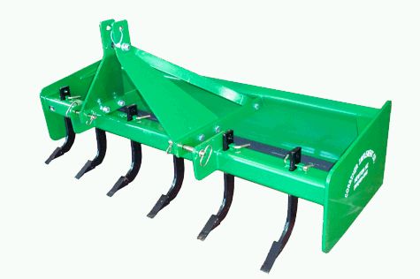

Hanh? This thing?
I can't picture too many uses for something that looks like this. Maybe breaking up a tough adobe crust on a field(?) but I don't have anything like that.
Would it be of any use in maintaining a gravel driveway? Do you like it because it has any use in addition to being relatively inexpensive and heavy? /forums/images/graemlins/confused.gif

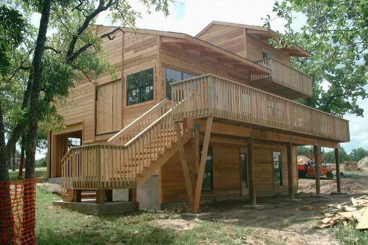

Do you build everything to withstand 100 mph? That seems incredible, but I also know it's possible to have much higher winds on a mountain or near the top of a mountain where pressures drop and the wind speed increases. I'm thinking about your deck because it is built similar to mine. You even have the same Simpson brackets on top of your posts (see attachment). With these long decks above the ground, high winds are the only thing that scare me. If the conditions are just right, they can lift like the wings on an airplane. My builder told me not to worry, but I've seen the tornado and wind damage here in Texas, and I'm still a little skeptical. 100 mph wind and dry snow must be like pointing a sand blaster at yourself. Ouch!
Also, the boxblade is very useful for maintaining a gravel road. As you drag the road, the box collects gravel and you can move it to fill potholes ort distribute it in a thin layer by slightly lifting the box with the 3PH. Since you can't see the front lip of your loader, a boxblade is handy because you can look back and see exactly what you are doing at all times. Most boxblades also have a blade on the back, so you can grade going forward or in reverse. The scarifiers are not meant for tillage, but rather to loosen material so the box can dig and scrape the surface more efficiently. I have two boxblades because one of them came on an old industrial tractor I've since sold, and the other one I bought several years ago. For grading and spreading material, the boxblade gives you the most "bang for your buck." /forums/images/graemlins/cool.gif

Thanks for the explanation jinman, and yes ...when the weather gets nasty it gets right after it. IIRC we clocked 110mph winds a few months ago at Anchorage Int'l Airport, which is on flat land at the lowest point in Anchorage. Here in the mountains it flat cooked!
I hadn't thought about that deck acting like a wing but it makes sense that it would. One thing I can say for certain is that when the wind is really gettin' after it you have a natural inclination to stay indoors and out of harms way. Hanging on the deck loses it's apeal.
We used to live in an ag area called Palmer and their wind usually had a serious grit in it. A lot like the sandblaster you mentioned. Here in Anc we don't really have the grit sitution but a man does have a tendency to think for an extra moment about how he's going to store that few extra sheets of plywood outside, etc.
That's a beautiful house you've got there, jinman. Neat support geometry on the fore end of that deck too.

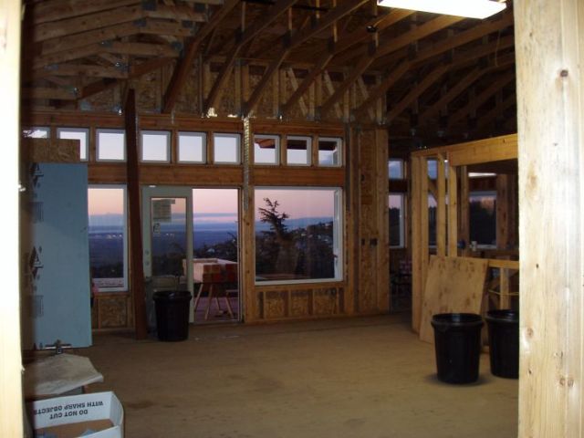

Here's an example of interior construction details. The steel strip you see on the floor is called a drag strut. Same thing in the walls and on the roof. Basically a seismic provision but it helps w/ wind loads too. The one you see on the floor will be covered w/ concrete in a few days when the heating system is completed.
