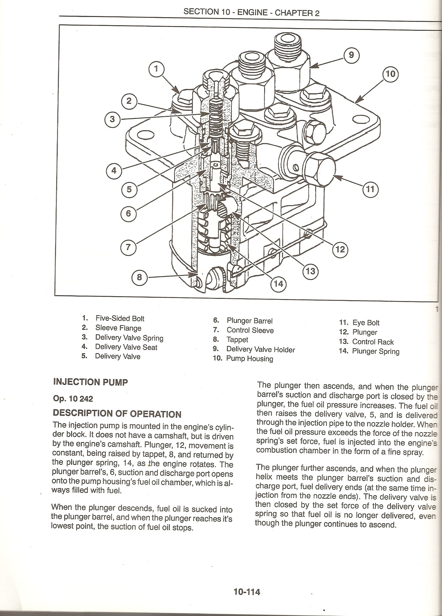

I think there is a plunger???? in the injector pump. It's what the fuel solenoid actuates for fuel flow,sometimes it gets jammed and is usually freed up by inserting a rod in the solenoid hole and freeing it up. It's been a while since I've seen that problem but I think that's what solved it. Could have been a magnetic probe used to pull it though........ :eek: can't remember for certain.

I've attached a page from the repair manual to give you some insight. If the problem is internal to the injection pump this may help you or others in the diagnosis. If #5 is hanging up or stuck for any reason you would not be drawing fuel into the plunger barrel so fuel delivery would be fubar. Hope it helps.
Bud

Thanks TO Bud I am sure this will help.

Everything is finally fixed. What it turned out to be was a broken spring inside the throttle linkage. I removed the injector pump and had a local shop run the rack and everything was within specs. I kept digging and found that the return spring behind the pump that is connected to the linkage was somewhat sprung. Working with a mirror and small tools almost totally blind I was able to remove and replace the spring. Now the throttle linkage returns and allows the rack on the pump open and close correctly. With a bad spring the rack was not fully opening once the solenoid was activated and the throttle open, mimicking a fuel flow problem. Thanks to all who helped.
