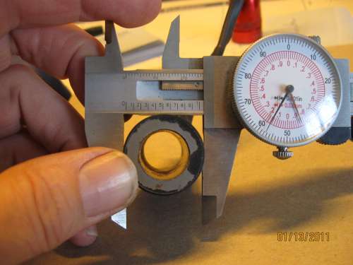

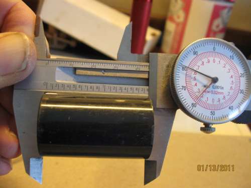

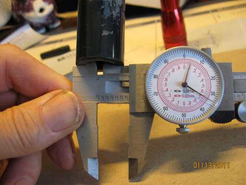

Ask and you shall receive. Had to crawl under there today for the parking brake switch.
Coil resitance was 8.8 ohms. Hope this helps someone sometime.

#37
Hmmm, seems the pics. of the measurements disappeared, just Xs there. So here they are again.
   / TC 40D #38
Nice!:thumbsup: It's larger than I expected. The shaft the coil surrounds must be about 5/8" (0.625") since the coil opening is approx 0.643".
