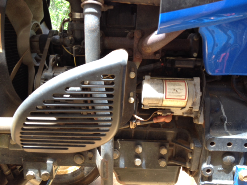

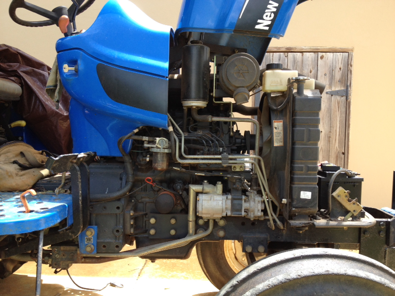

Good morning gentlemen,
I was hoping for some guidance for a mechanically dysfunctional tractor owner on a budget...
I have a 2004 TC 40a for a few years now and have been lucky with repairs. Although it only has 940 hours, I have kept it maintained oil changes, filters and greased up etc.
It's been a couple of days now parked and now won't start...? I attempted to jump it, I just get lights on at dash. Purchased fresh battery still nothing but dash lights on. No noise, no crank nothing.... Checked battery cables and they're not frayed or broken... No leaks visible either...?
I'd like to at least diagnose the problem myself can anyone advise me as to what would be my next step in the diagnoses...? Should I check the starter and how do I? Fuses?

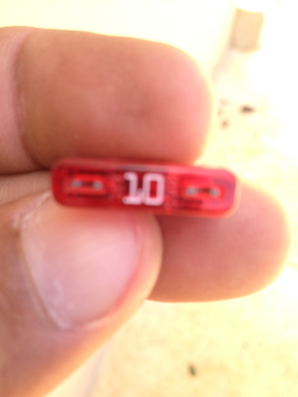

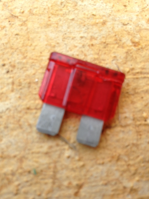

I checked all the safety switches mentioned they seem to be good... Going to look behind dash and check fuses next... I did some research and I'm hoping its a #10 fuse that's blown that has cause so many others starting issues....
   / Tc 40a won't start
Dave
That's exactly what it was that pesky no. 10 fuse! Thanks for the advice! I truly appreciate it! Again thanks from the "Not So Mechanically Inclined".
Hey by the way did I blow that fuse when I tried to jump start it?
