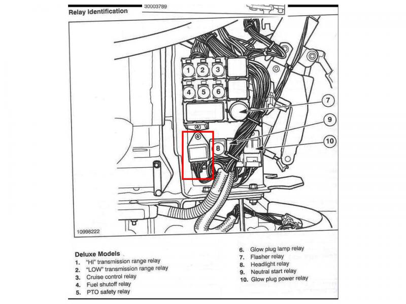

new holland tc30
Could it be possible that my NH tc-30 does not have a glow plug timer? I can not find it anywhere.
Also, what controls the flow to the plugs
   / tc 30 glow plug #2
Track down a schematic of your tractor to see how it's wired. I don't know if your tractor has a timer. Some do, some don't. Either way glow plugs are generally energized by turning the ignition key to the left. It's a spring loaded position so when released it will snap back to the off position. Energize the glow plugs for the proper amount of time (usually five to fifteen seconds) then attempt to start.
   / tc 30 glow plug
My repair manual says it does, but I can not find it. I have constant power going to the plugs, even when I unplug my ignition. I even have power at the ignition wire.
   / tc 30 glow plug #4
I'd track down the problem. Your glow plugs should not have constant power and may have burned out by now. Try to track down a parts breakdown of that tractor.

@bene0239 - As Roadworthy said... definitely look for the issue. Your TC's Glow Plugs should never have constant power & if they do there is a real problem & as mentioned may already be burn-up.
As far as the Glow Plug Timer goes (I believe but don't hold me to it) on the TC30's it depends on serial # of the machine. I think it is located on the firewall... see attached pic.
It should be #8 in the diagram NH part # SBA385870301 (for reference... make sure you confirm)
