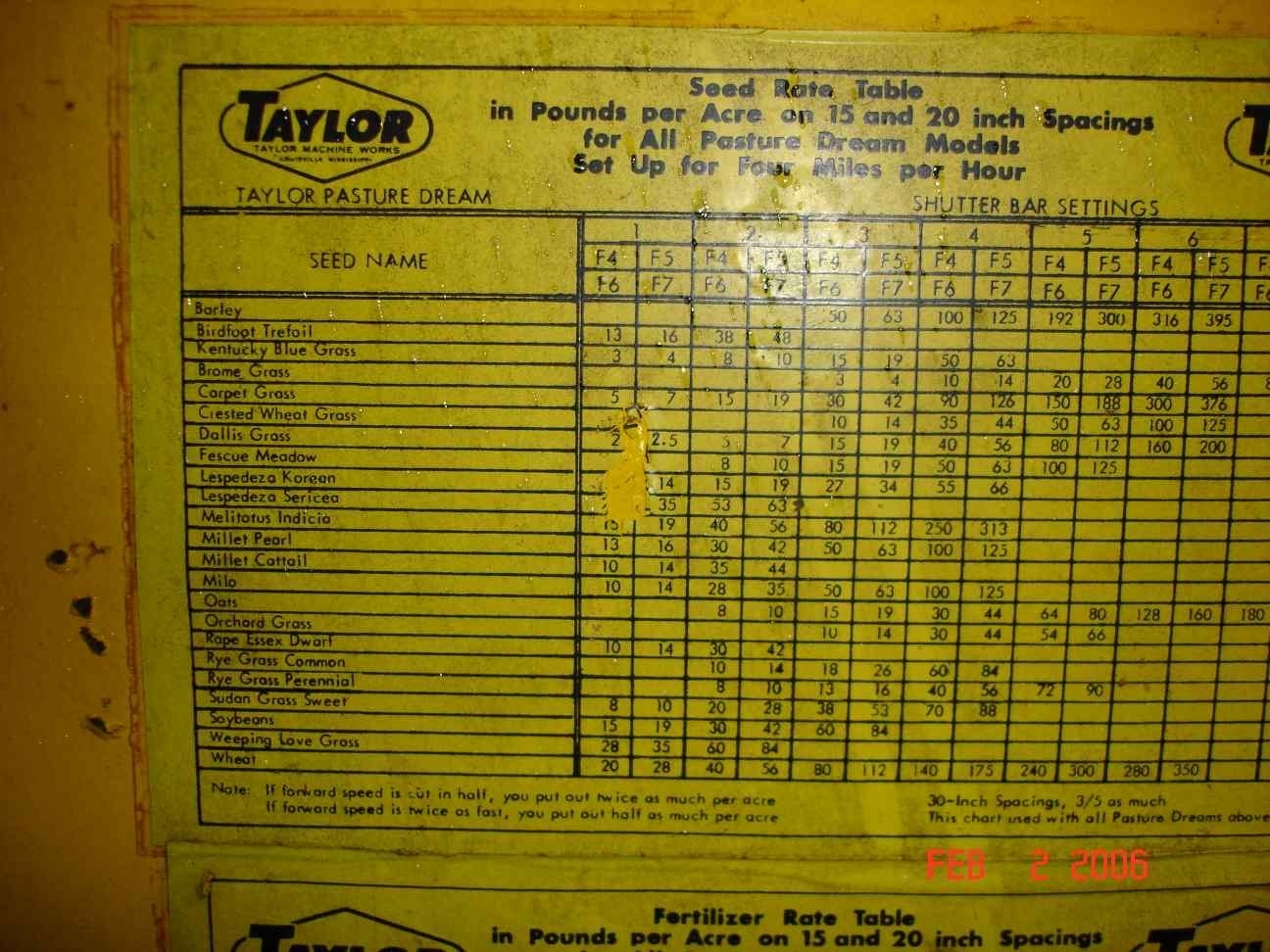

I just bought a midland PDf5 and don't know how to set the seed drop setting. manual refernces 1 thru 8 settings. how do i know where the set points are ? Any help would be appreciated. Larry

do you have a facsmile of the information plate for adjusting ( 1 thru 5)flow of seeds ? mine is there but's illegible. Thanks
   / Taylor (Midland) Pasture Dream #8
Just found it
