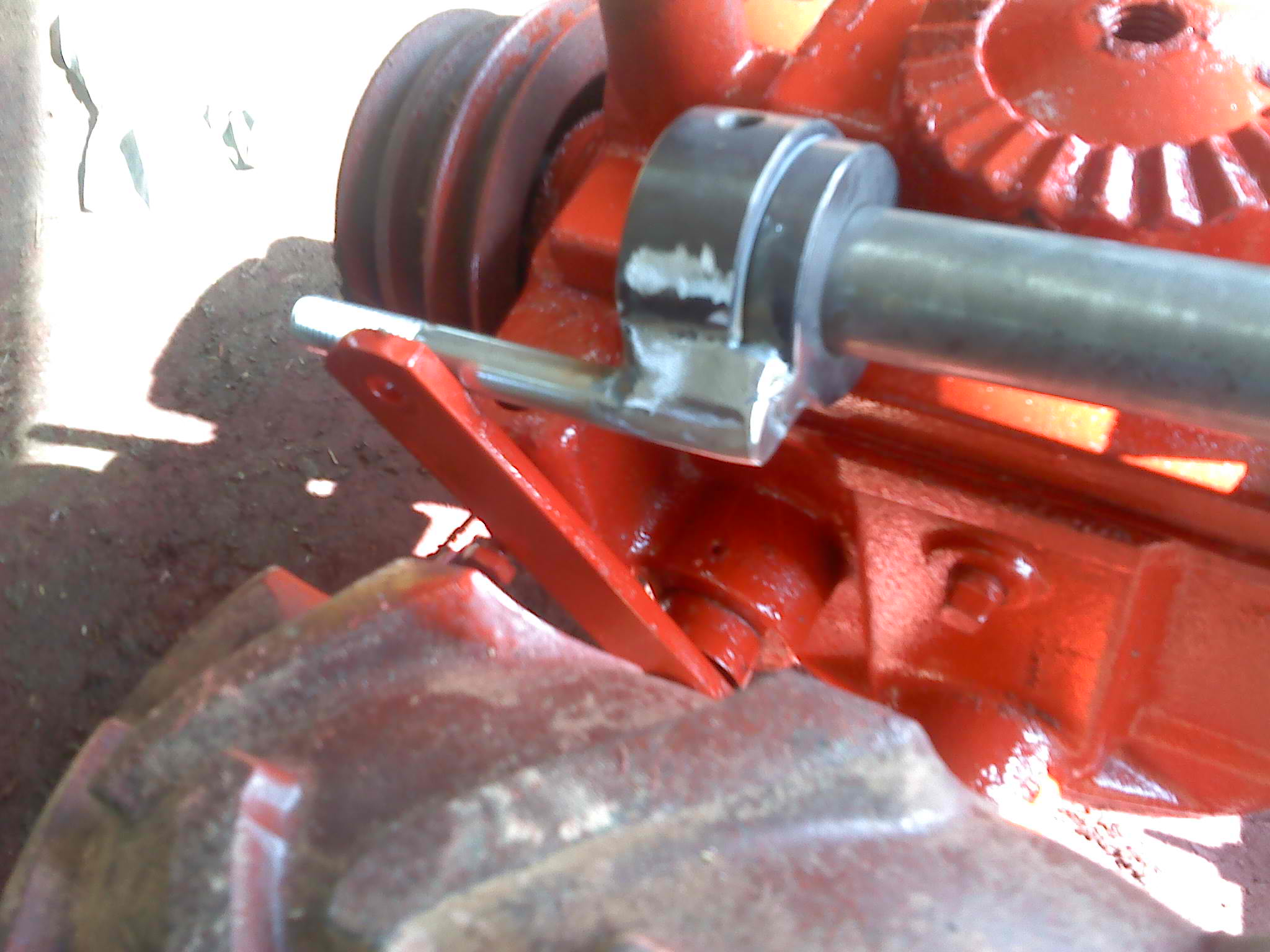

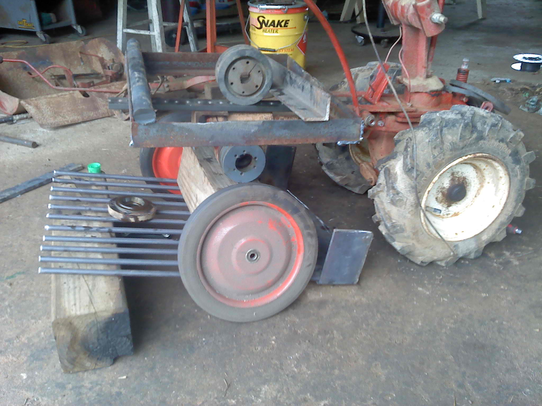

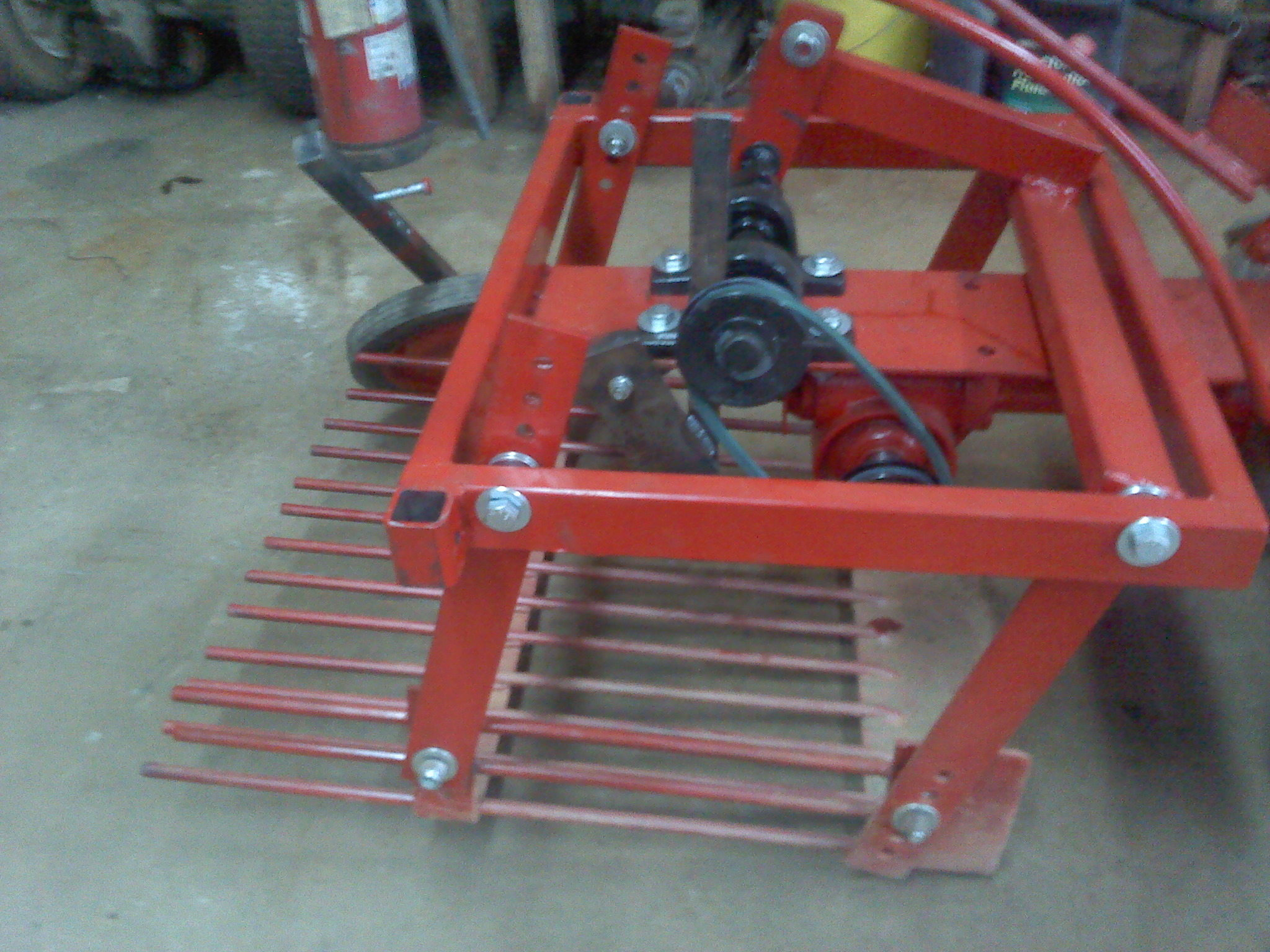

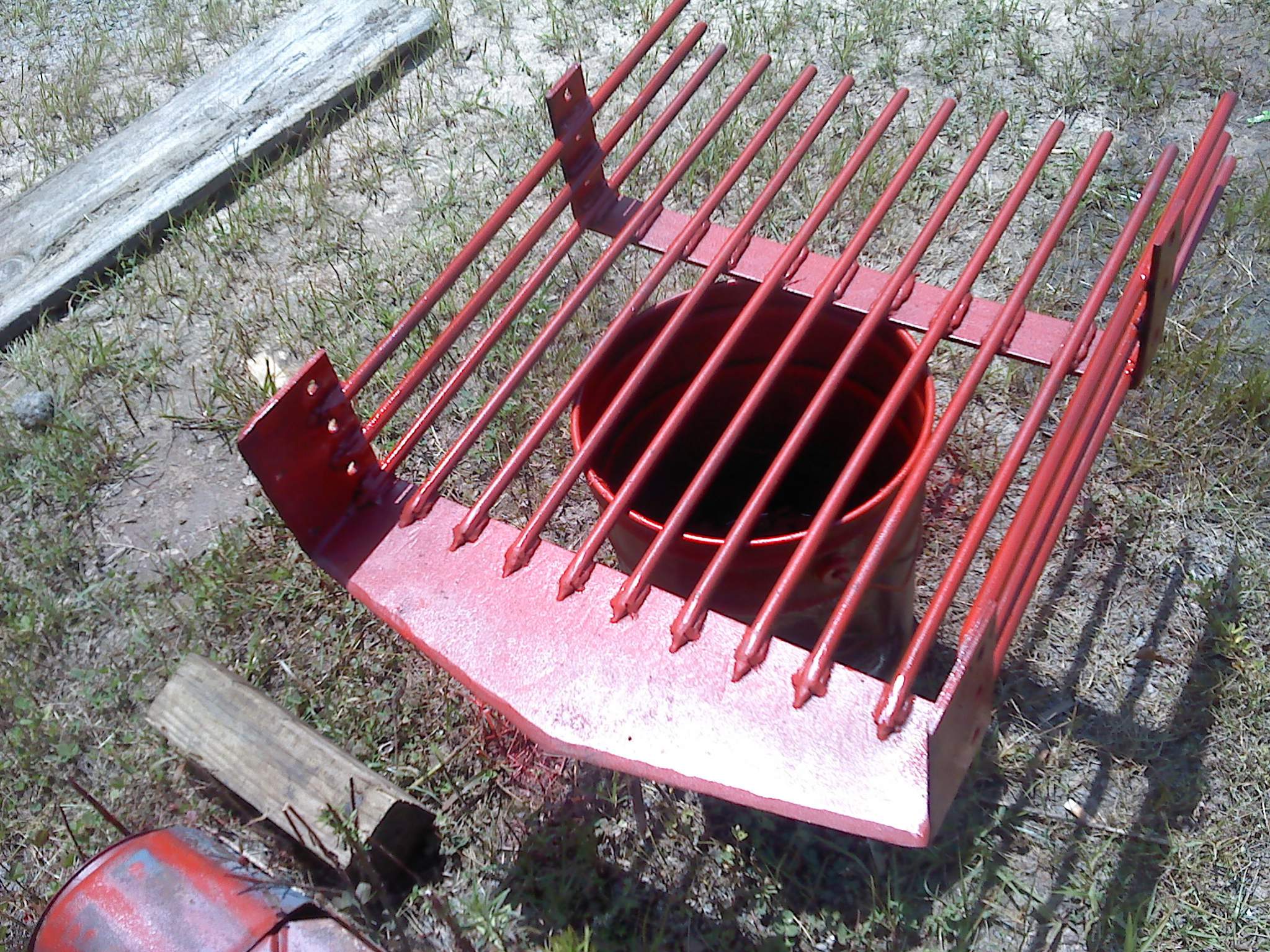

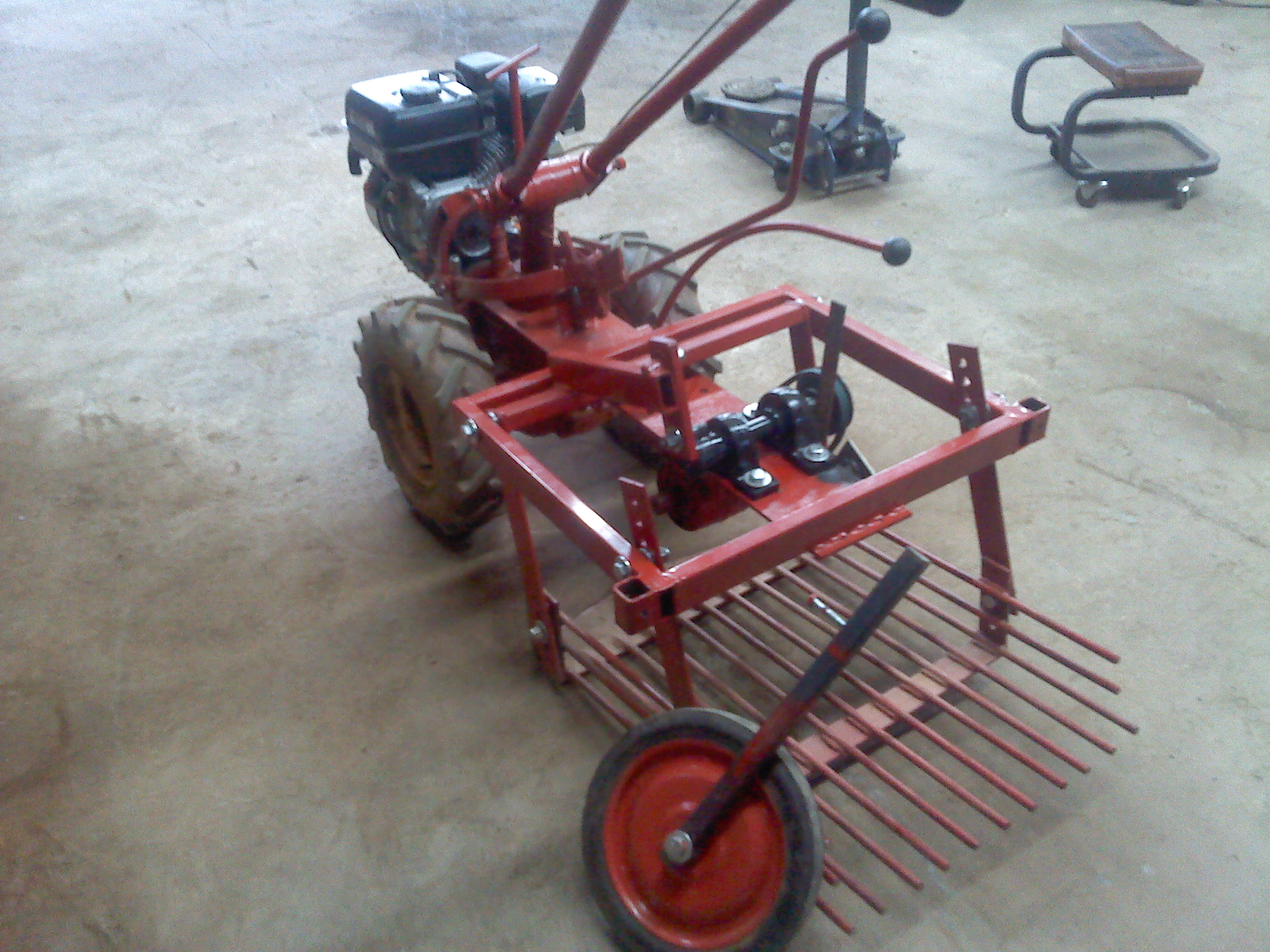

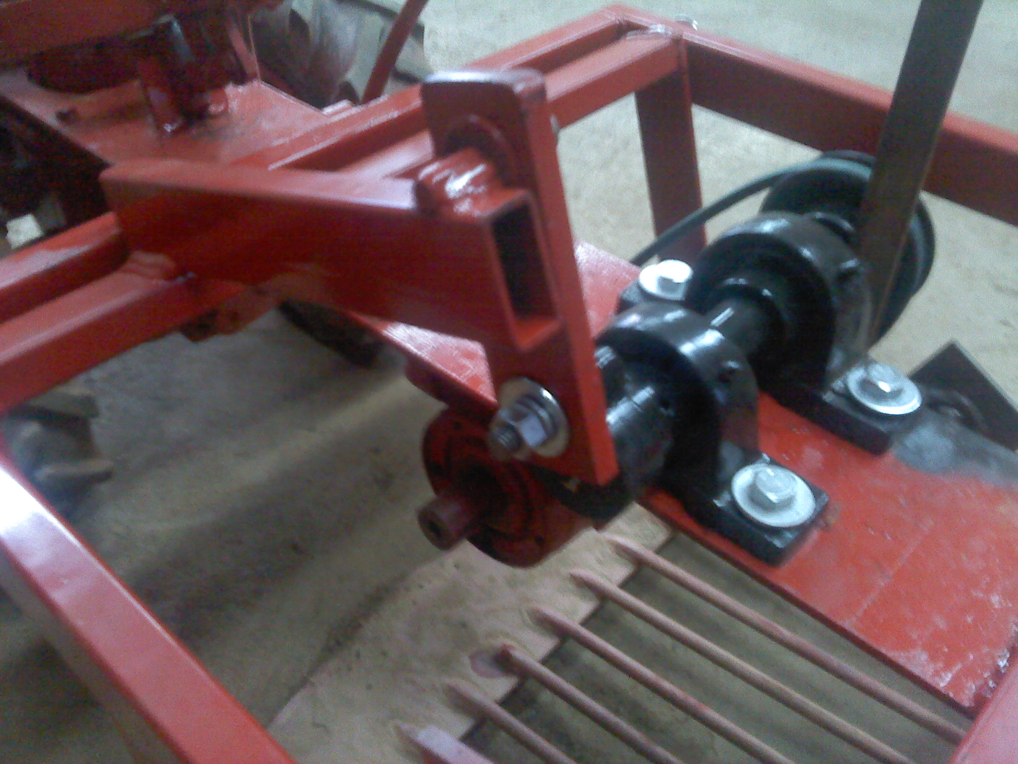

The digger mover forward and back. It is hinged at the front and back. I will attach a few pics of what it currently looks like.
First pic is of the connecting rod. I took a piece of 1/2x2in flat bar and drilled a 1 1/8in hole, the same as the outside dia of the bearing. This proved to be a loose fit since I used a hole saw for the hole. if you look close at the edge of the bearing, you will see a small saw cut. I cut from the edge of the bar to the hole and then welded it back up. This tighten the hole until it was a press fit on the bearing. The other end I simply drilled for the 1/2in bolt I used for mounting the arm to the eccentric.
The next two pics are of the eccentric mounted and connected to the rocker arm on the digger attachment and the rest are just some pics of the digger and the rest of the set up.

My digger "basket" moves laterally about 3 inches, but the nose "scoop" stays in contact with the ground and is kept in motion by link arms from the "basket" carrier. I made a short video of it working that will show the mechanics of it, but when I tried to post it here, it failed.

I think the tiller does not have enough traction/power to pull it through the dirt, the potato diggers I am used to have a stationary digger spade with the shaker chain pulling dirt and potatoes up onto the shaker bed both the one and two row diggers were pto driven and pulled and the single row were ground driven.
I have seen similar one row diggers that were 3pt mount that was pulled by a small tractor
/ Tater digger/rock picker #46
jarokoro, I have only seen fixed blades and bars in action (ignoring YouTube) but USA research showed that it was preferable to have the digger blade moving sideways too for these small diggers because the power required is reduced by up to, from memory, 70% rather than use a fixed blade - it was a substantial amount whatever it was.

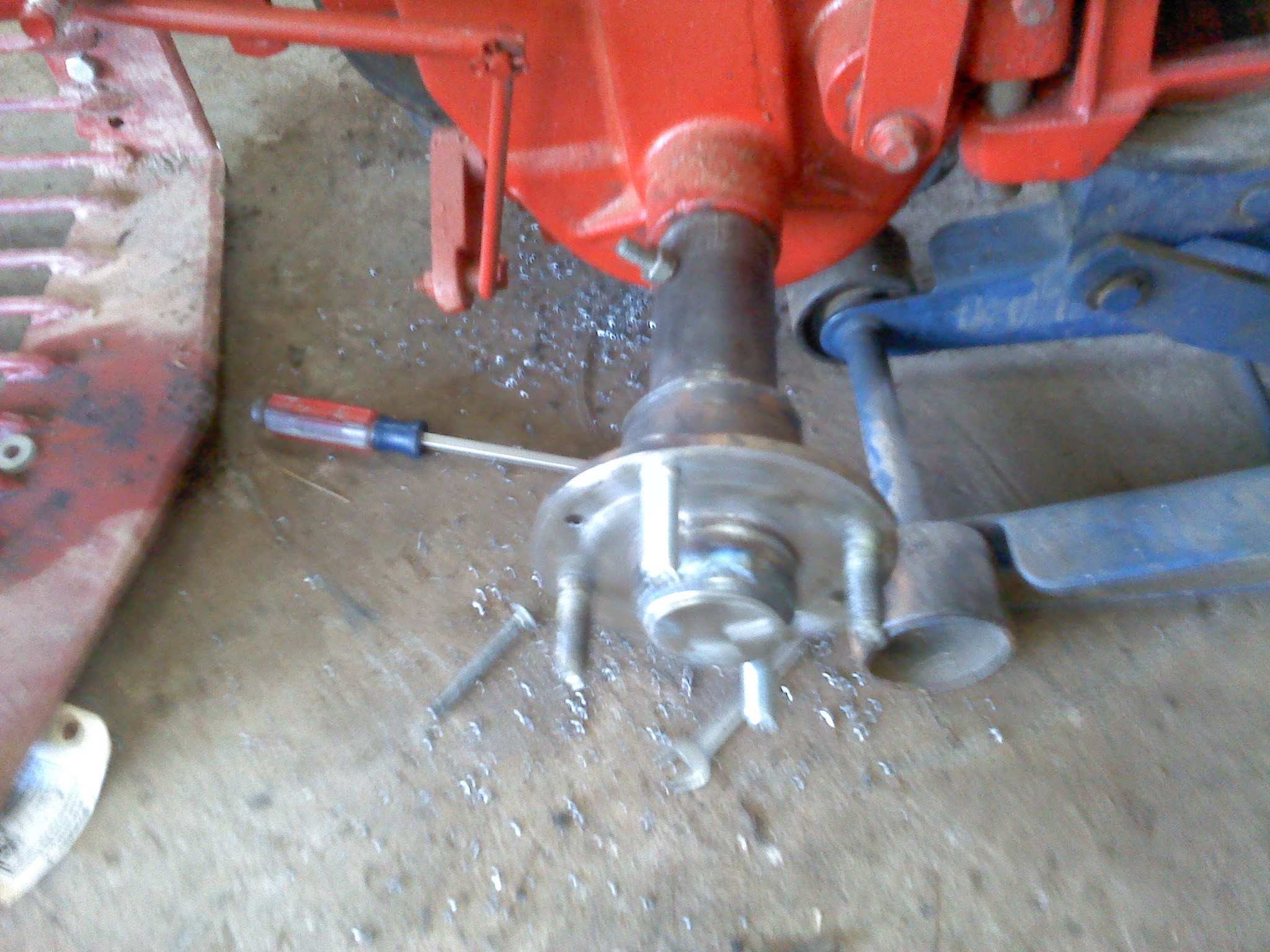

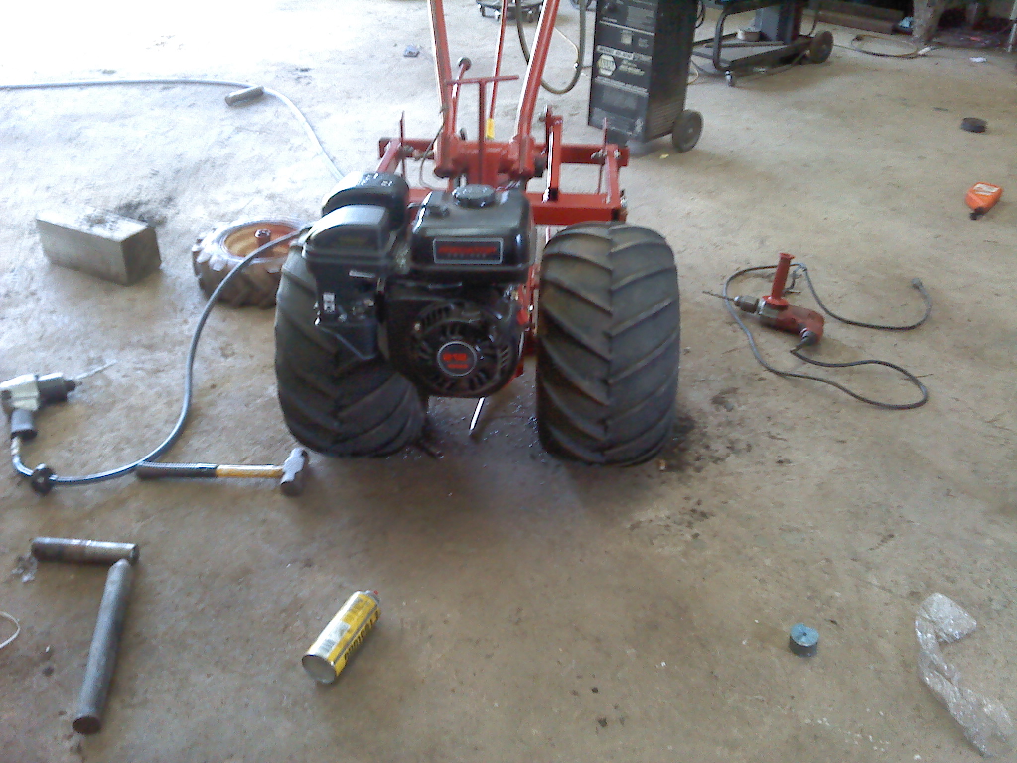

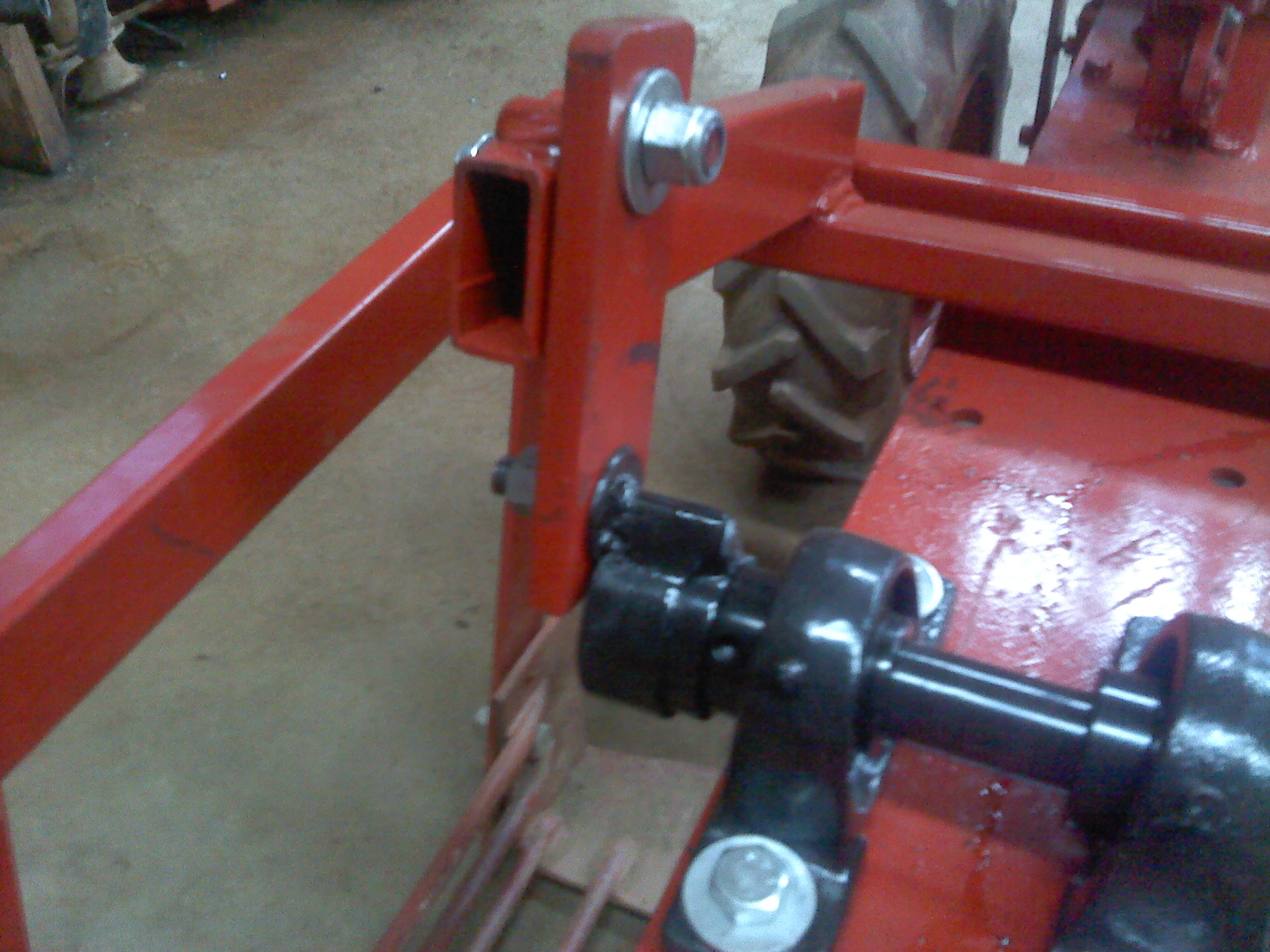

Got back to the digger build this wk. I had some old Steiner tractor tires laying around not being used, Just had to figure out how to mount them. The axle shaft out of the troybuilt tiller is 1in, the Stiener uses 4lug hubs. these hubs just happen to have the same bolt pattern as a couple of old hubs I had on the shelf. I took a piece of 1 7/8 shaft material, bored the center to 1 india to fit over the troybuilt axle shafts. I then turned the outside dia down to fit inside the 4lug hubs. A little welding, trueup the flange face on the lathe, and I now have big tires on the troybuilt.
Having a little slippage problem with the belt tensioner, I think I made the tensioner pulley mount a little to flimsy, it twists and lets the belt fly off. Still got a little tweaking to do, but my roundtoit seems to wander toward other projects
