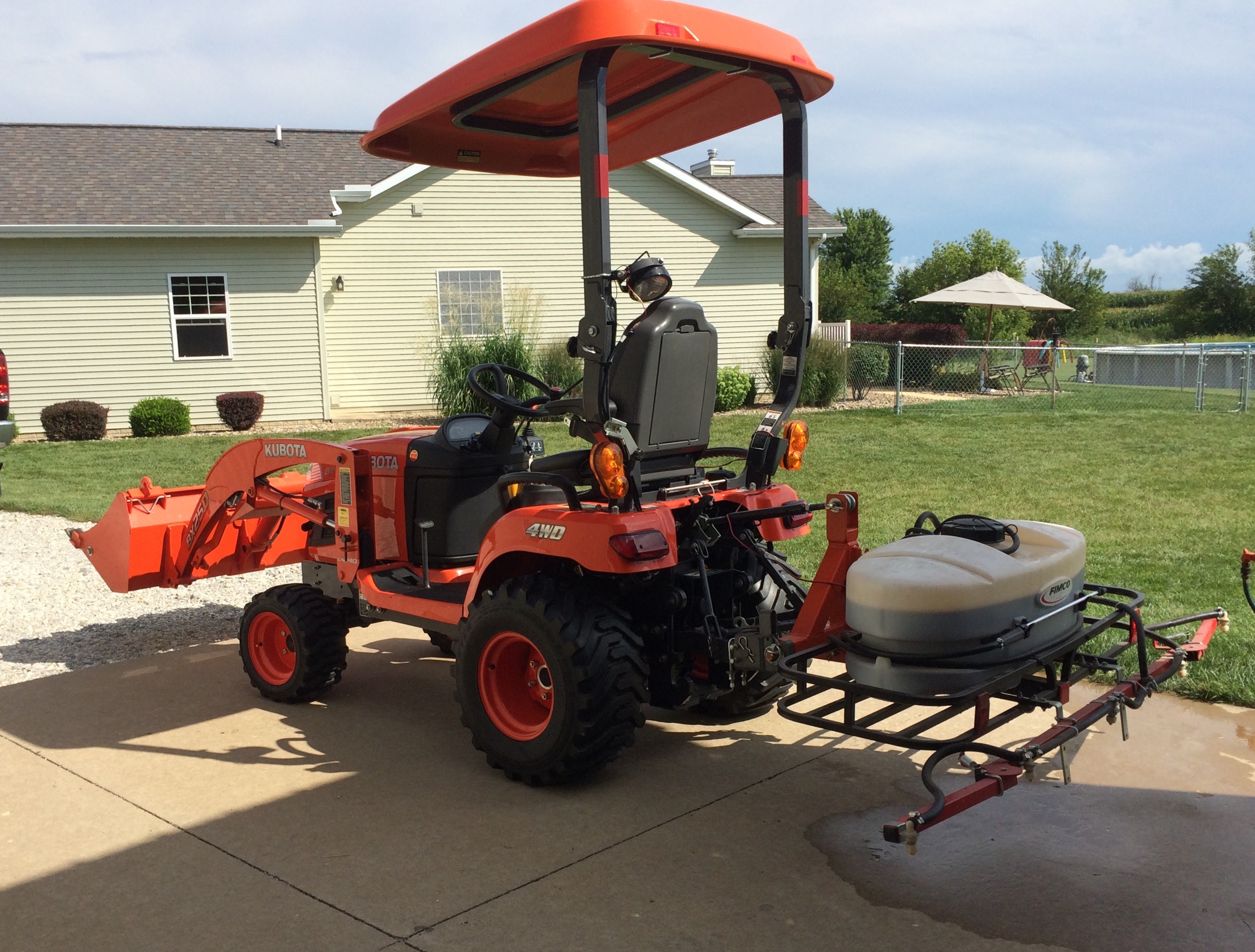

Back in the early 90's I bought a small tow-behind sprayer at Tractor Supply. It didn't take too long to jacknife it and damage the tank. I found a used 15 gallon tank and made a frame for it. The first mount was for the 3PH so it would be part of the tractor (Ford Pic) and not a separate piece to deal with. Then for a while it was set up with a 2" square tube to fit into a receiver hitch. Then I modified it to mount on the RFM (Kubota Pic). Last week it underwent a minor mod so it would mount on my brush forks. Hardly any parts of the original sprayer remain.
It's been waiting for a day without much wind to do an application of TSC-branded liquid Weed n Feed, but yesterday the dandelion on one part of the yard simply needed a good drink. The spray from the nozzles on the arms is way too fine for the wind we had, but the coarse spray from the wand was perfect and the wind actually helped. So I just strapped the rig onto the york rake that happened to be on the Ford and did the job. I do prefer using the cabbed tractor for spraying, but with some awareness of wind direction the Ford works. The bulk of the yard can wait for a lull in the wind.
I've been a fan of having the sprayer on the back so the tractor was ahead of the spray and wouldn't run over the sprayed grass. That was mainly for when I used "defoliant" so it didn't track to things that should live. Haven't needed to do that in recent years. I got tired of turning around to monitor spray pattern and liquid level. That brought the latest mounting change. So far there aren't any pics, but it was just adding a couple eye bolts that catch the tips of two fork times and an old ratchet strap to hold it back. The provisions for mounting to the 3PH and RFM are still in place.
