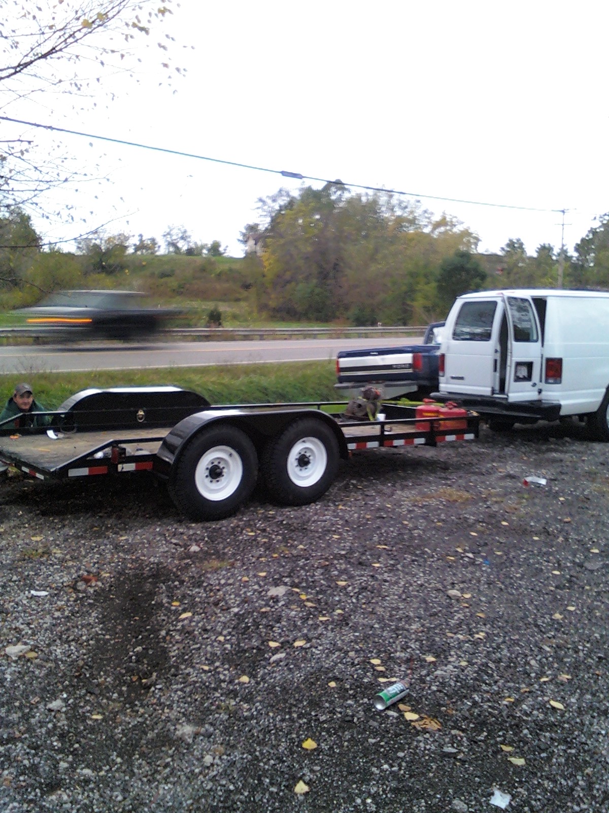

It's a 8000# tilt. It's in my photobucket if ya want a peek. (note the JD green pin striping :D)
I was using the "1foot-2foot times 3" method that I posted a pic of earlier.
See the little circles they call "pipes", they should of called them 'wheels'.
My main problem was the amount of time the electronic scale gave me between 'calibration and read-the-weight time'. Way too short.
