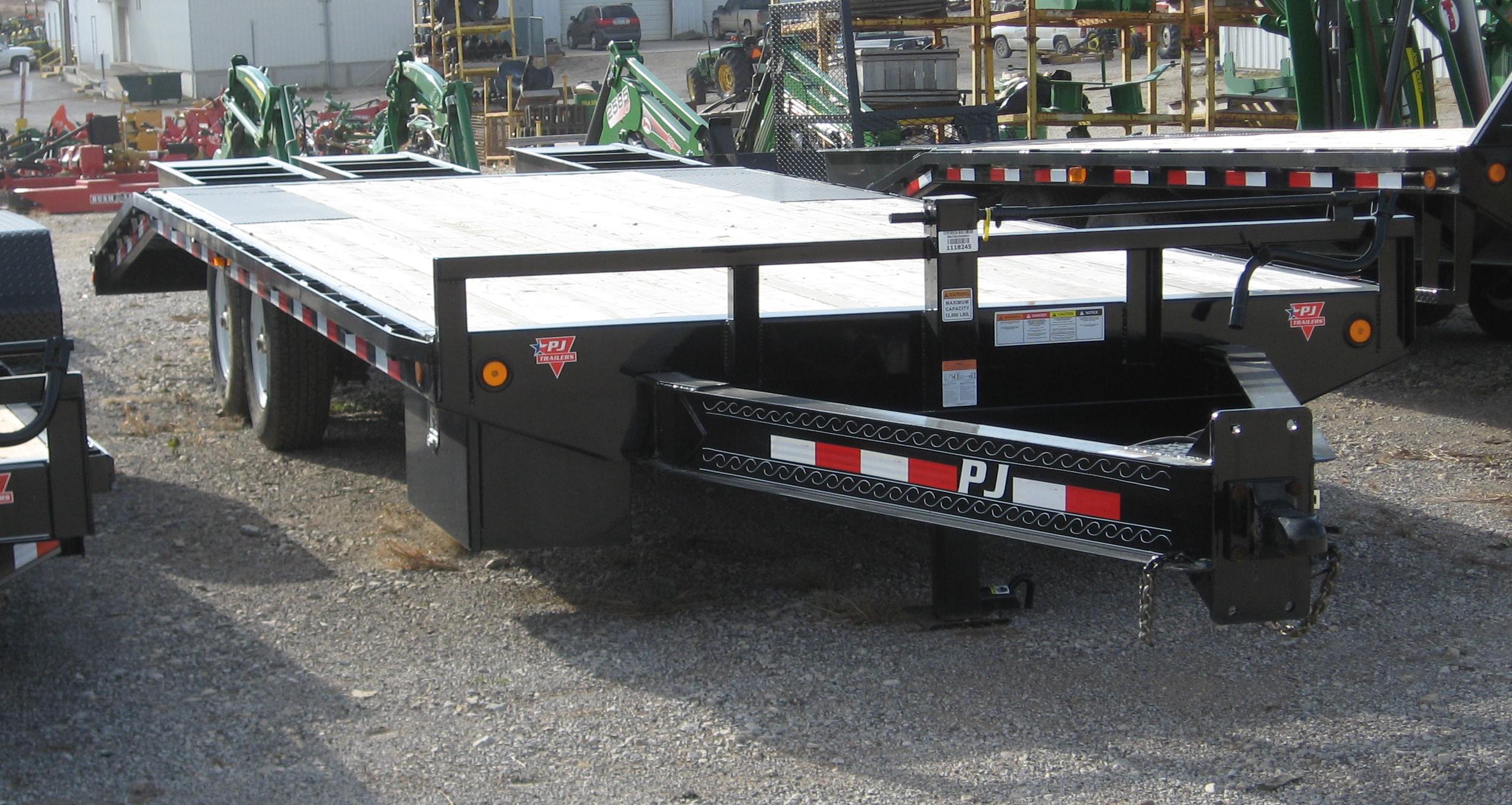

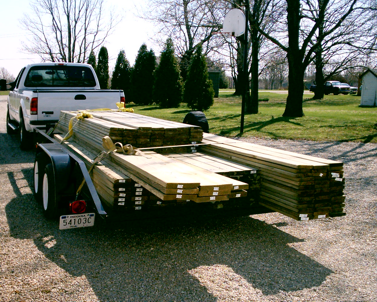

They are not that way in from what I have seen. Now boat trailers are that way because most of the weight is in that position. Here is a pic of my trailer. The idea of a bumper pull trailer is to have 10% of the weight on the tongue of the trailer.
Most trailers are about 60/40. That is 60% of the deck before the axles and 40% aft of the axles.

it's a 60/40 weight ratio for better trailering. You dont want all the weight on your pin, overloading your tow vehicle. you dont want too much weight in back and have excessive sway. just a thought.

What you guys need to remember is the trailer like the one pictured above is meant to haul large equipment, not a car or CUT. For that purpose a utility trailer or car hauler is much better suited unless you have a 1 ton Diesel truck.
Put a Case Backhoe on that trailer like the one pictured above and the load would be right, 60/40. Most of the reason these trailers are setup like this is the bucket of the FEL takes up 4' of the deck space and is relatively light, then you have the engine and tranny to finish off that first 60%. In that last 40% you have the cab, large rear wheels and diff, and then the weight of the BH itself hanging off the back.

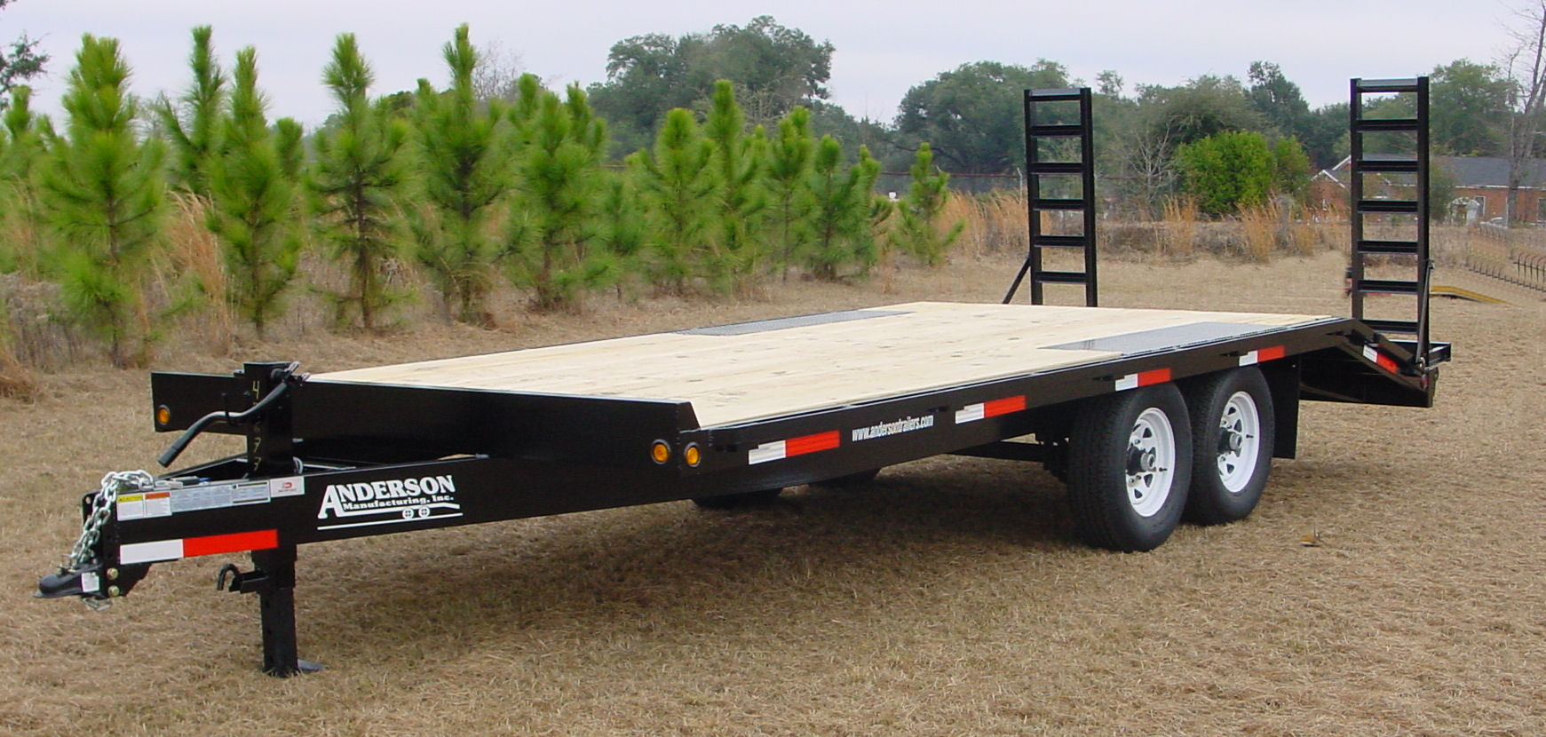

Like I said, meant to be hauled behind a dump truck...Still some mfgrs., like Anderson, seem to place the wheels a little farther forward. This looks like what I need, but, unfortunately, there aren't any Anderson dealers around here that I know of...
