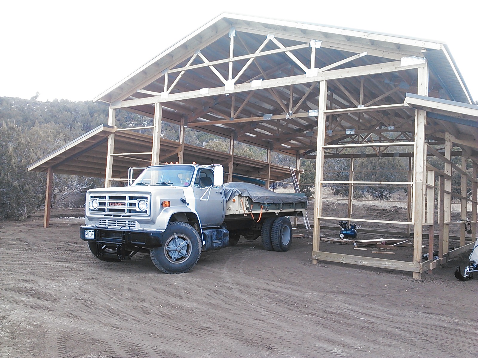

I finally finished up the inframe on my truck in March, got all the little leaks fixed, replaced some lights, got it inspected and renewed the registration. I'd just putted around with it for that stuff as an easy start for the new motor and today I gave it a real test. I drove 48 miles to the dirt yard, got 5.5 tons of compost and drove back, everything ran great. My front tires are out of balance and I get some vibration starting at about 55-60 so I stayed at 55 or less, I can't find anyone willing to balance these old tube tires, I'm going to try the Fleetpride next.
I realized after I got loaded that the back tires needed air, they call for 110 but, the gas station I stopped at could only do 70 so I got them there and got home fine. After dumping the load, I went over to the shop and checked all the fluids, coolant was still full and the oil looks like new. I aired up the back tires, got the first one to 100 pounds and then couldn't get it any higher after 5-10 minutes when it dawned on me that the regulator was set to 100 pounds. DOH! I put the air line direct to the tank and got them all up to 110 so I'm good to go.
I'm going to put a tailgate on it in the next week or two, I just tarped over everything today, and then I'll make the 65 Mile drive to the landfill to get some mulch. Once we get the 2nd garden done and I'm caught up with work, it'll be time to start getting asphalt millings for the driveway.
It's good to have her running again, she's incredibly useful to have.IMG_20180320_161429961_HDR.jpeg
