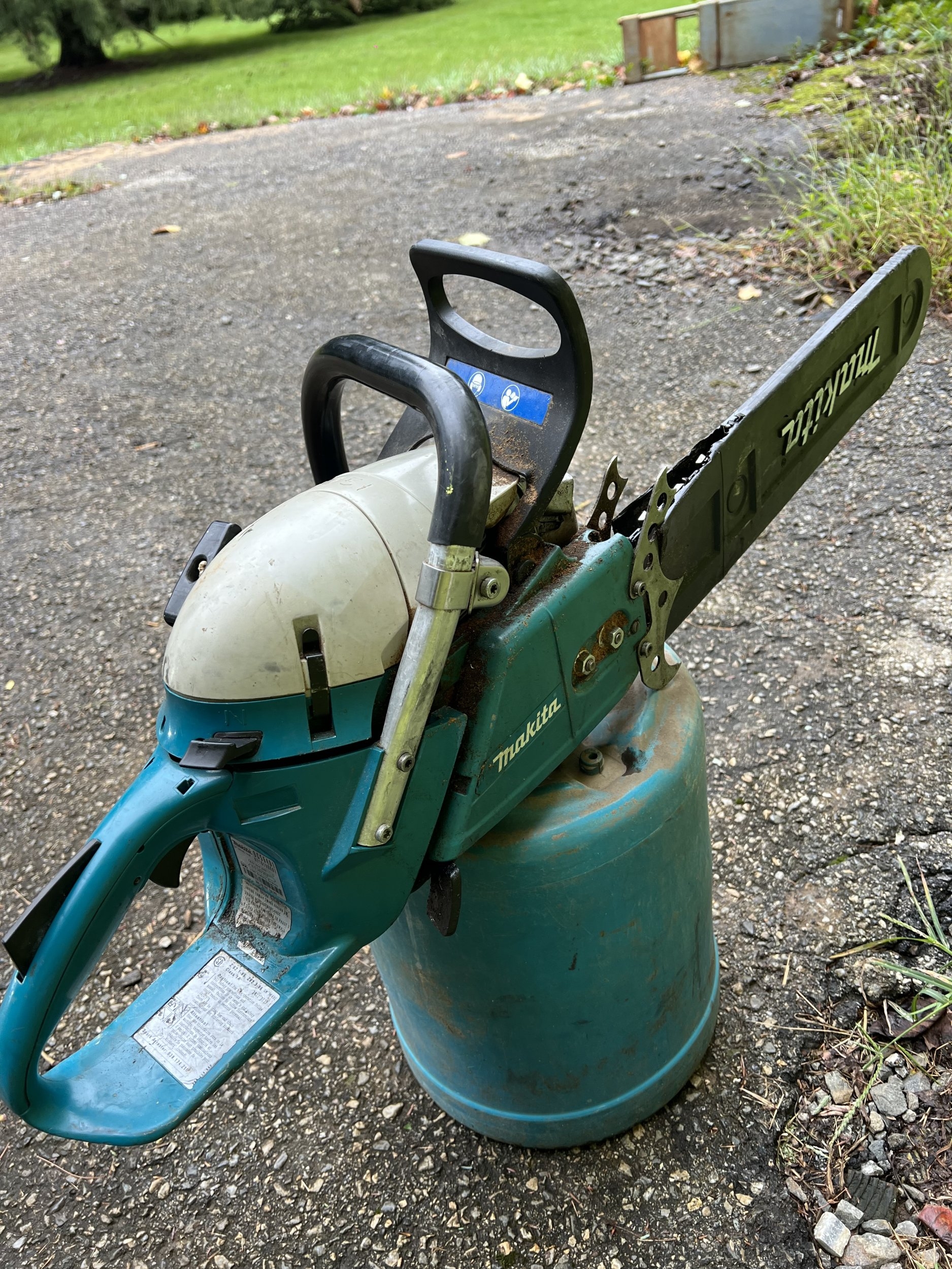

   / Talk me out of a 460 Rancher #31
Here was my last Makita
