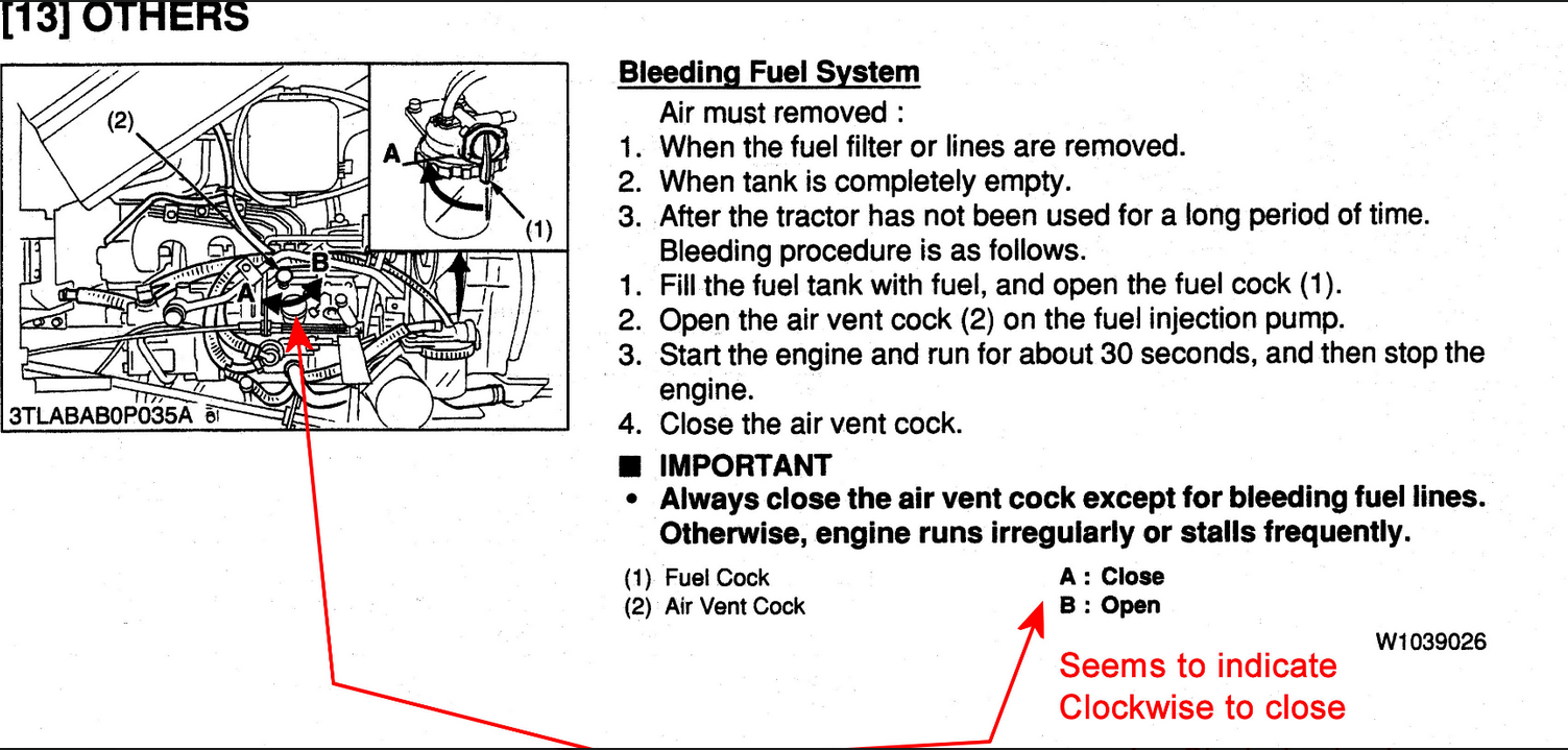

I know that it's best to never run out of fuel, so I never let my tractors get below 1/2 tank. That said, I've still had to bleed/prime my system.
Experience #1 - Had a New Holland TC 21D that started running poorly. I noticed a lot of water in the fuel filter bowl, so I changed the filter, but I either lost the prime, or there was too much water in the injector lines. Loosened the fittings at the injectors, cranked the engine over a bit and re-tightened the fittings. Purred like a kitten again.
Experience # 2 - I cracked the fuel filter bowl on my Kubota L 3010. It was at our hunting land, so I replaced the filter and bowl in the field. I knew about losing prime, so I made sure the fuel bowl was full before I tightened it down. It started right up, ran great, then quit. My heart sank. This was my first fuel filter change on the Kubota, and I wasn't familiar with how Kubota deals bleeding the system. I went home and read the manual and found out that all you have to loosen a knob on the injector pump and crank it over. Tighten it back up once it starts. It couldn't have been easier.
Lesson Learned
- Familiarize yourself how to prime/bleed the system on all your tractors before you need to. The day may come at the most inopportune moments.
Would like to hear the experiences of others for the benefit of other TBN members.

Definitely a good idea to know the bleeding procedure before you need to use it,
I recently replaced the 2 fuel tank filters on my Kubota ZD1211 mower. Each tank must be bled separately (close one, bleed the other, repeat for 2nd tank). I suspect there is a bleeder valve at the engine, but it's not used in the process. No running the engine, just key on for the electric lift pump activation.
My L4060 is similar in that the electric lift pump is keyed on, but there is a bleeder valve on top of the fuel filter.

I think I'm at 3 or 4 times, running out of fuel! Fuel gauge on "standard" L tractors are pretty cheap... once the gauge hits empty, I still have 4 good hours before I need to refill. I can't see emptying anything less than a whole 5 gallon container into my tractor but I'm not going to stop when my gauge reads empty (half full).
   / Tales of running out of fuel (and the remedy). #8
I’ve ran a kioti tractor out and I’ve ran my diesel lawnmower out. Let the electric pump fill the lines if equipped and move it to full throttle because it pumps more fuel that way. Both machines started back without bleeding. I agree about not wasting time filling up until it’s empty. I run my machines either until they’re on a trailer going by the fuel station or the low fuel light comes on. Now if you planned on not using it for a while filling the tank to prevent condensation is a good idea.
